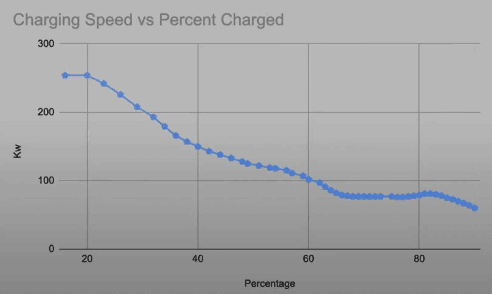

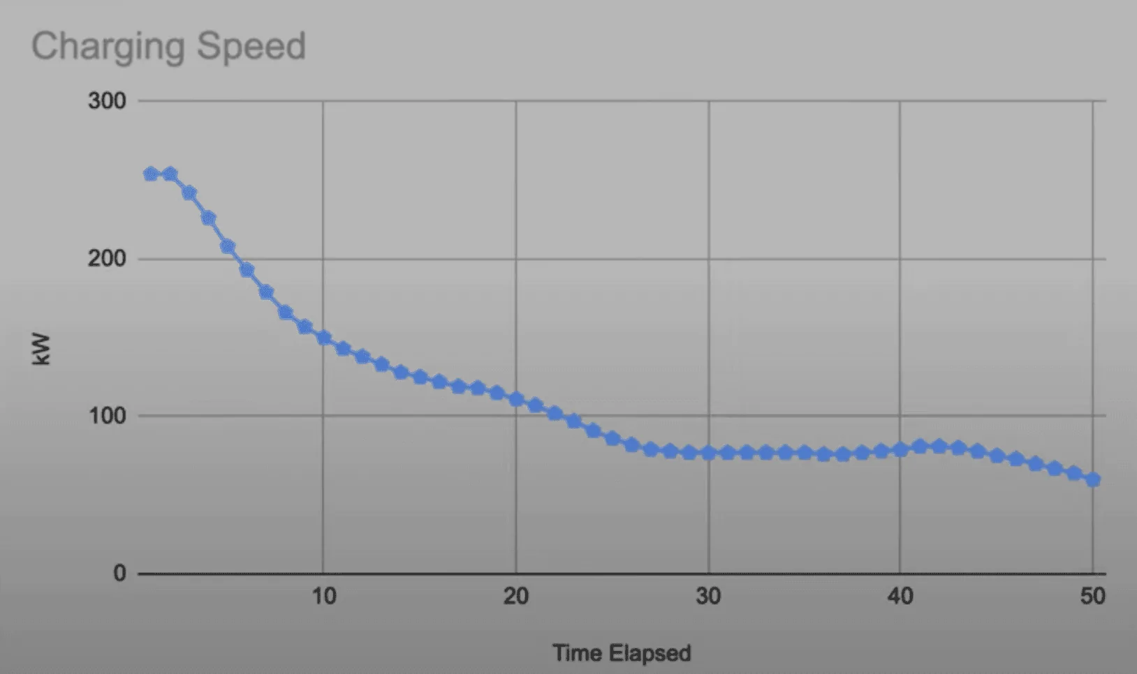

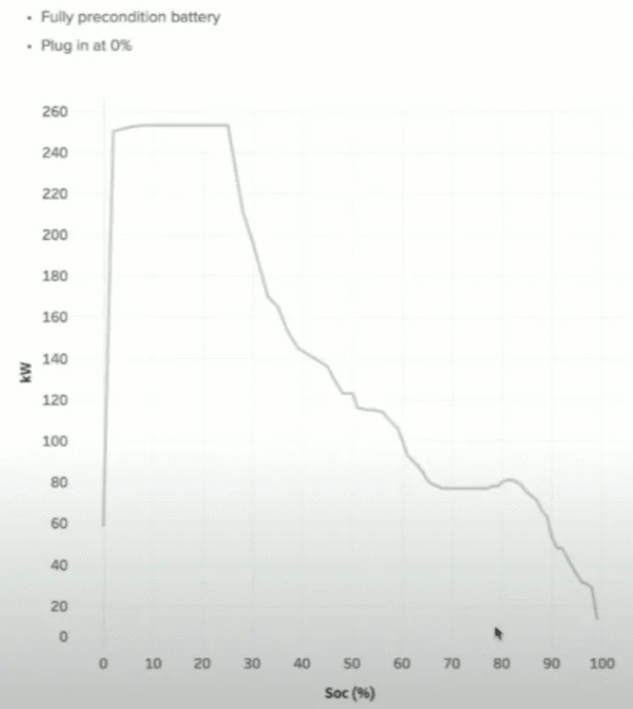

Does anyone even think the v4 chargers will make much difference?
In the best case that I've seen, the 250kW charger has already ramped down by the time it hits 25% charge. Is there reason to believe that at a lower current and higher voltage, the curve can stay higher for longer? Because otherwise, the only benefit that will occur is below 25% SoC.
At higher current and lower voltage, more heat is created. Is that heat the limiting factor in how fast these batteries are charging? Like, does the battery system switch from heating the pack to cooling it as soon as it's plugged in?
Genuine questions, I'm very curious about this.

I think that you'll find that the charging curve is essentially the same as your Model Y. Yep, around 25%, you are no longer at 250kW.
While there is hysteresis, the vehicle switch from cooling to heating as needed. (In the summer, preconditioning cools the battery)
Whatever they may be called, the 800V chargers or chargers that are greater than 250kW, don't seem to exist yet.
The things that are being called V4 chargers are probably just capable of non-Tesla charging.
