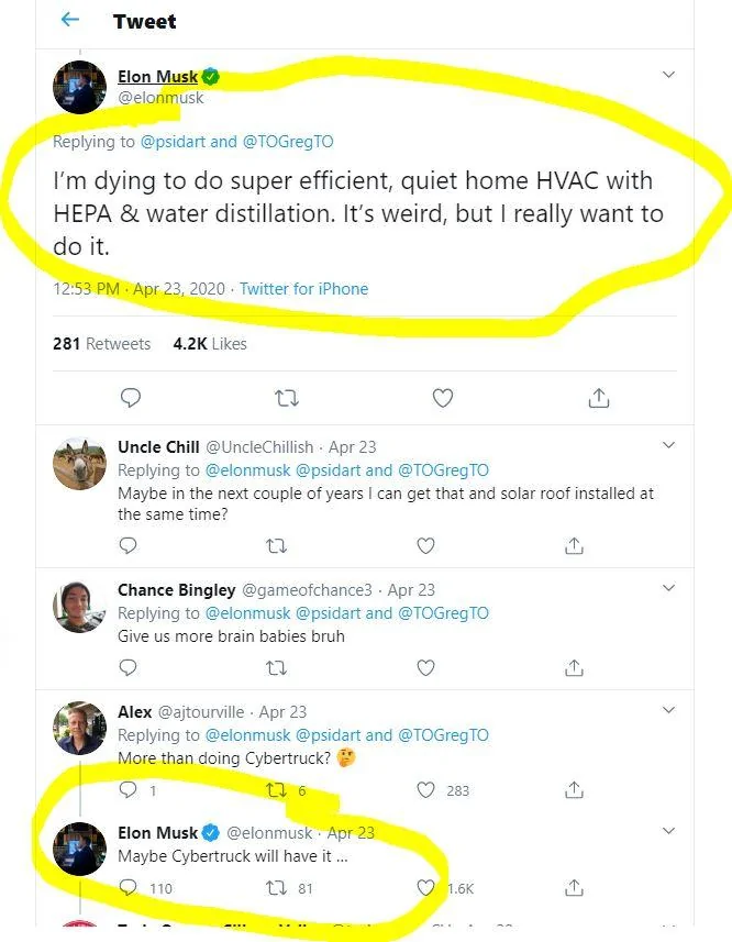

One thing is for sure.. if it is so dumb as your are claiming.. why is one of the smartest people alive right now working on creating a product that does this?
Does what? Distill water in a car? Start by telling us who this smart person is. It is not Elon Musk unless he has said something specific about this in some place or other. What he is quoted as saying here is
[/QUOTE]"I’m dying to do super efficient, quiet home HVAC with HEPA & water distillation. It’s weird, but I really want to do it."[/QUOTE]
This doesn't say anything about distilling water in a car. This is, of course, the internet and so someone is going to grab this and interpret it as meaning that Tesla is going to put a still in the CT. Common sense alone says this is ridiculous. Elon said he wanted to do super efficient, quiet, home HVAC with HEPA & water distillation". Even in realizing that he was speaking of the home environment we have to also take into account that this was just a casual remark in an interview as "super efficient" and "water distillation" do not belong in the same sentence. As I have pointed out here before RO is a much more efficient way to purify water than distillation and easier to maintain thus what he meant to say was that he wanted to get into home appliances that do things like purify water and condition the home's air. That makes sense in terms of the company's overall goal. So what is a super efficient, quite home HVAC with water purification and HEPA? Well, as explained in a previous post it is a geothermal (to include loops ducked in lakes or ponds) based heat pump with HEPA filters in the ducts and an RO system. Would such a system recover the condensate for desuperheating? No, probably not but many systems do use well or mains water to desuperheat thus, in cooling mode, recovering some of the latent heat load into the house's hot water system.
[/QUOTE]
I think I found something that is confusing about the Cybertruck and distilling... Elon tweeted about HVAC for the home and then someone said something about solar panels and then "Maybe the Cybertruck will have it". Have what? Distilling or Solar? It's hard to follow Elon's train of thought.
Tesla Cybertruck Cybertruck Will Distill Water, Hints Musk! Elon Tweets
