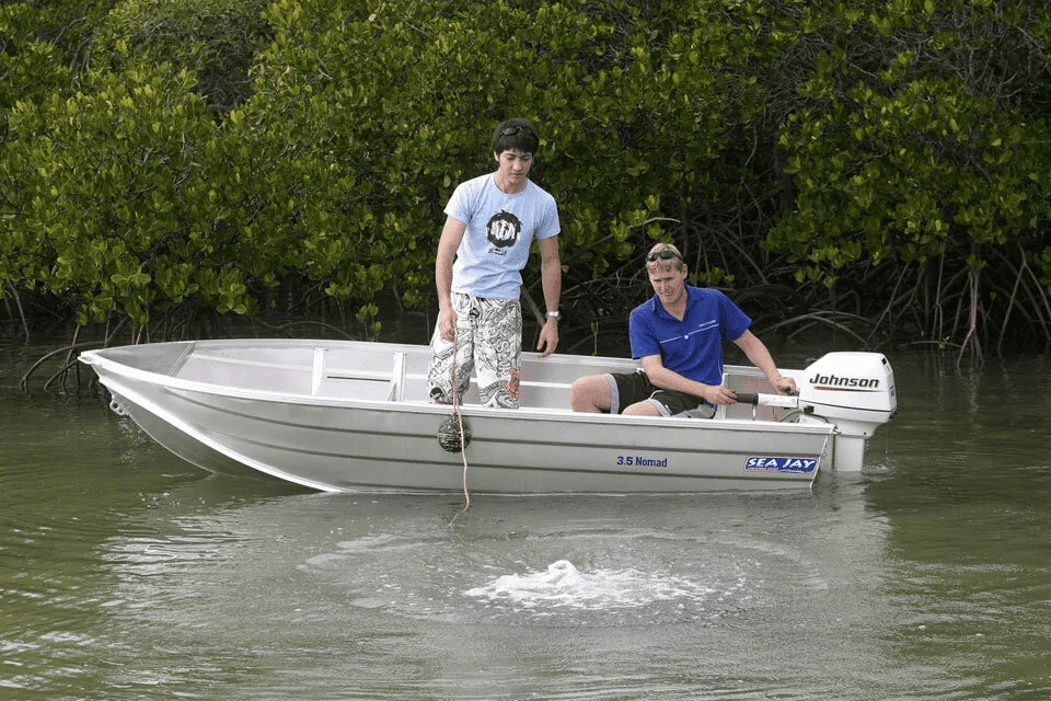

Seaworthiness ?
The tinny can safely float under reasonable conditions.
If the CT is deemed to go over water..... common sense.

Seaworthiness ?
Wait... The tinny is made of aluminum instead of SS. Does that make a difference?
Maybe someone needs to do one of these shows with various "vehicles".

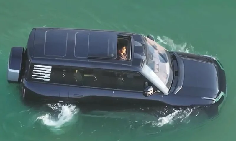

I don't really understand how amphibious is so unbelievable.
Wading and floating mode
Like every good off-roader, U8 can wade. The Premium Edition can wade in a maximum depth of 1000 mm, while the Off-road Master Edition can wade up to 1,400mm thanks to the snorkel.
Tesla Cybertruck Cybertruck water capabilities? River crossing? 88d5a23a-67af-4e5e-8ecd-170159b40215

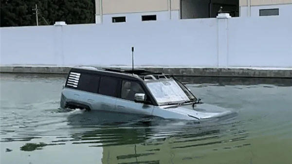

When the wading mode is activated, the vehicle will use its sensors to monitor the environment, water depth, wheel slip status, etc. The emergency floating mode is automatically activated when the car gets into depth over the limit.
Tesla Cybertruck Cybertruck water capabilities? River crossing? F6KTqtGXsAAgwU9-800x478

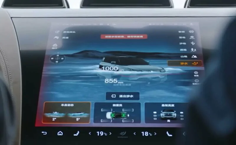

When activated, the combustion engine will immediately shut down, Disus-P will raise the suspension to the maximum level, windows will be closed automatically, A/C will be switched to internal circulation, and the sunroof will open, providing an emergency exit. Moreover, the vehicle will display the water depth and attitude on the central control screen.
Tesla Cybertruck Cybertruck water capabilities? River crossing? F6KTuTFXQAAt_a--800x493
U8 can stay afloat for 30 minutes and move forward at 3 km/h by accelerating and turning wheels. It can even perform tank turns while floating. BYD highlights that it is only for emergencies such as floods and not for fun crossing lakes and rivers. Interestingly, their marketing materials showcase U8 floating on the water exactly in those situations. After the emergency floating mode activation, the car needs to be brought to a service center for inspection. BYD claims U8 is IP68 level waterproof.
