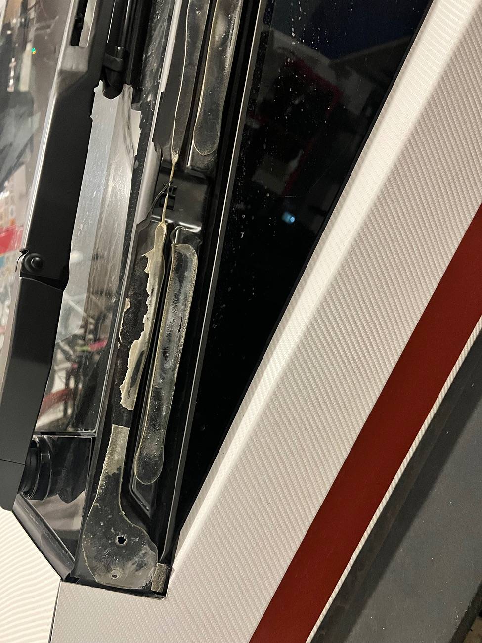

I ran a quick errand tonight, and while merging and accelerating on the Interstate in normal traffic, at about 70 mph, I hear a large ripping sound and the metal panel liberates and flies into traffic behind me. I was not able to stop as I was in the middle of a highway split. I rolled the window down and felt for it, and yes, the trim was gone. I looped around, next exit off/on, back to my original exit off/on, stopped with the hazards on, and located the piece, by that time run over multiple times with tire marks on the white wrap. I threw the piece into bed and drove home.

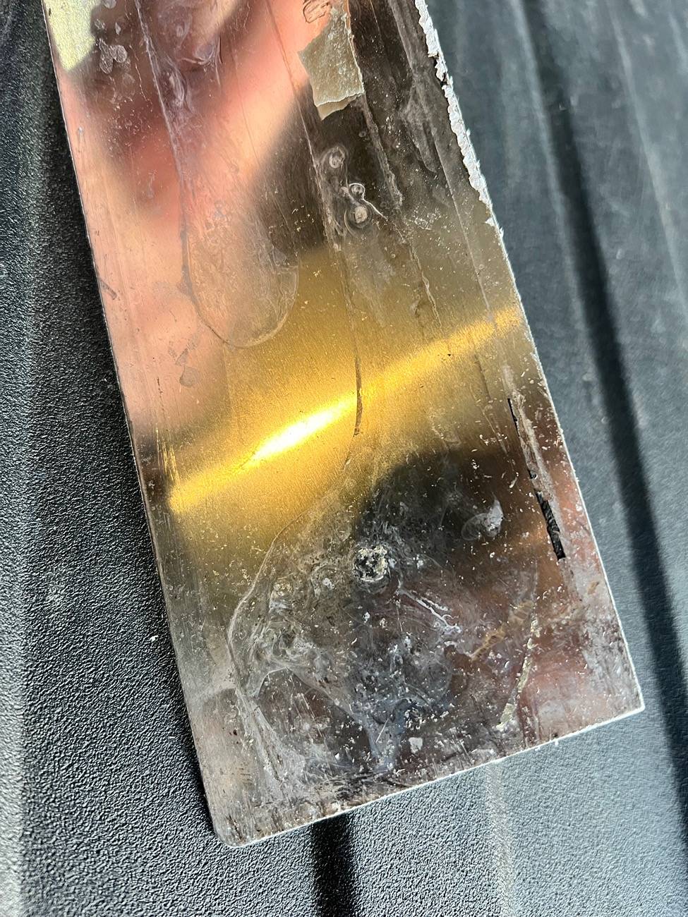

So the trim piece did not come off as one would expect (as the bed sail panel did on some trucks). The stainless portion separated from the plastic subframe that mounts the trim panel to the truck. The subframe is still there, all clips are in, and you can see the glue spots that once bonded the metal to the plastic, 17 to be exact.
I scaled the metal portion, 5 pounds. So imagine, a 9 foot long 2 inch wide 1/16th thick piece of stainless steel in the shape of a boomerang liberating at 70mph on the Interstate. This could have decapitated a motorcyclist behind me, or could have gone through someones windshield. Someone was lucky tonight, including myself.

Regarding the bolt, there is no bolt on the metal portion, it is just a clean sheet with glue marks. There may be a bolt holding the plastic undercarriage in place, but that is still attached to the truck. The tech at Tesla today noticed that the glue marks on the metal strip are rather faint, like it did not bond properly to the plastic undercarriage when installed originally. They ordered a new assembly, and want the one that ripped off for investigation.
On the speed, I was at Tesla a few hours earlier. The expert looked at it, and they ordered a replacement. There was no ‘lets remove it to be safe’ or ‘lets tape it down to be safe’. I had no idea it was held in place with glue and had a possibility to just sheer off. The leading edge had moved the width of the panel itself, so maybe 1/16th. So there was no gap to speak of, at least a few hours before it liberated.
The passengers side is fine, no movement.

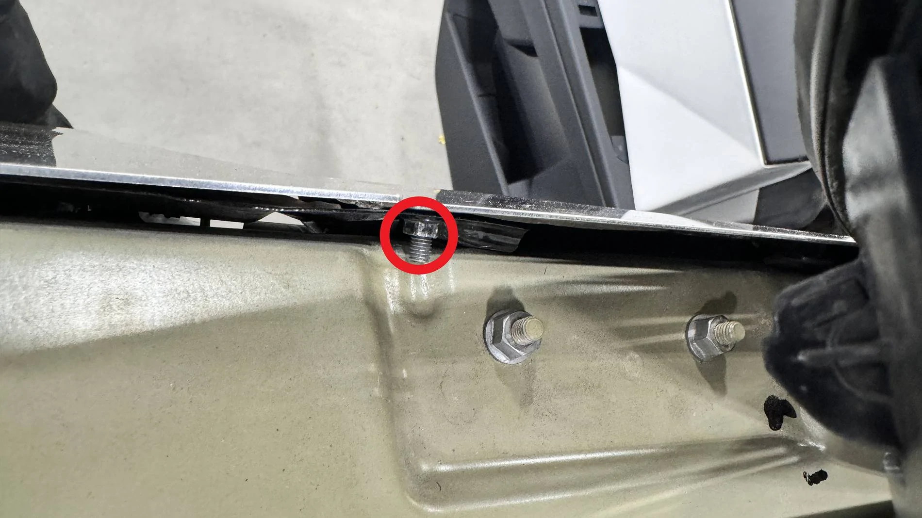

Actually it's bolted on. Are you sure your wrapper didn't take the nut off and forget to put it back on? This issue seems to only affect wrapped trucks. I wonder what the common denominator is.
The common denominator I'm seeing as well...
