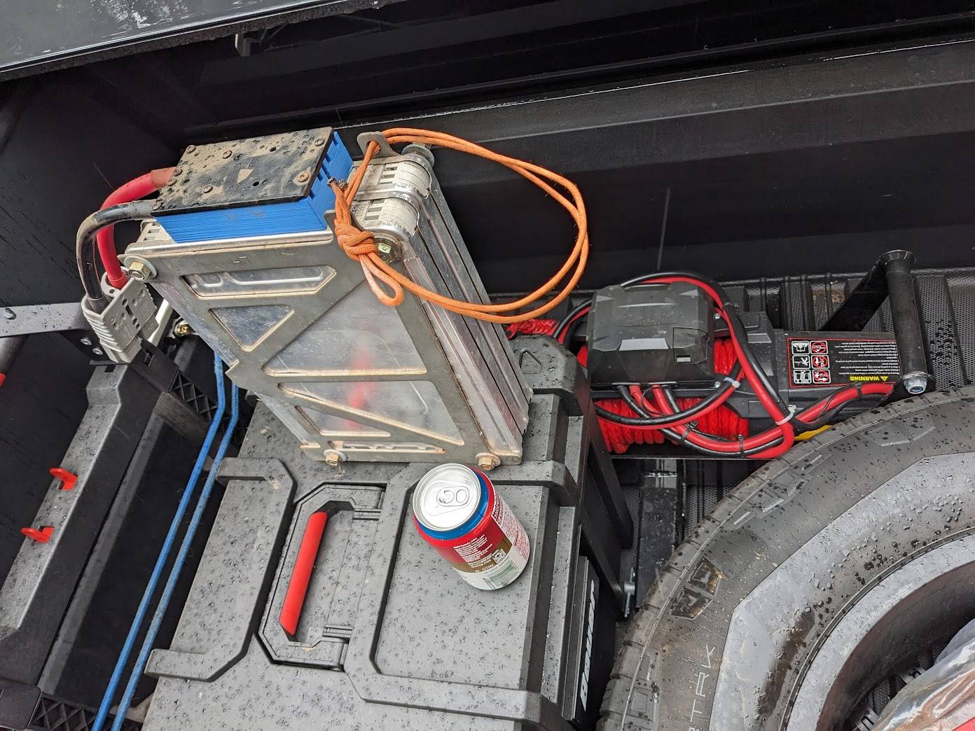

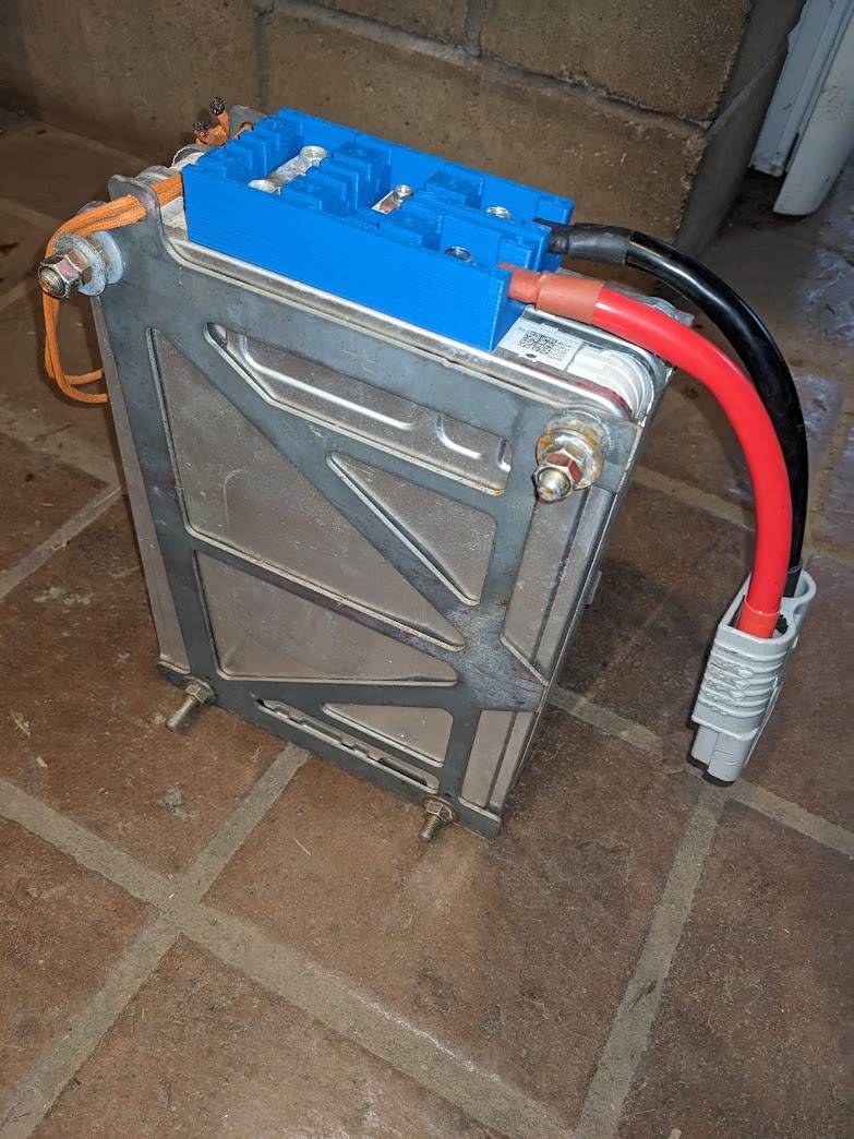

I've setup a standard 12V 12K winch powered by two gen2 Nissan Leaf modules. It's a very versatile setup because it can be hitch-mounted on the rear of the truck, or "cable" mounted to the front recovery hooks, or... even used without the truck altogether as a portable winch. Those Leaf modules are 66Ah and can handle up to 5C continuously so that's approximately 4.9kW (6.5HP) at nominal voltage. Given it's only 4 cells in series (4s2p) their health can be monitored manually and no BMS is really necessary but can be added if desired, along with a 400A fuse.
I guess another thing to add - that's approx 1kWh of capacity, enough for about 10 mins of winching at full load.
That’s awesome.
Would you mind snapping a shot next to something commonly identifiable? A hand? A soda can, that sort of thing?
It looks very compact for 1kwh

Should be about 17lb total. Charging time naturally depends on the output current of the charger - I have a universal charger with 25A max so it would charge those modules in about 2 hours from 15-20 to 100%.
I will do that tomorrow, but in terms of specs those modules are 11.93 x 8.78 x 1.38 inches, so the full package is about 11.93 x 8.78 x 2.76
66Ah * 7.4V * 2 = 976.8Wh
