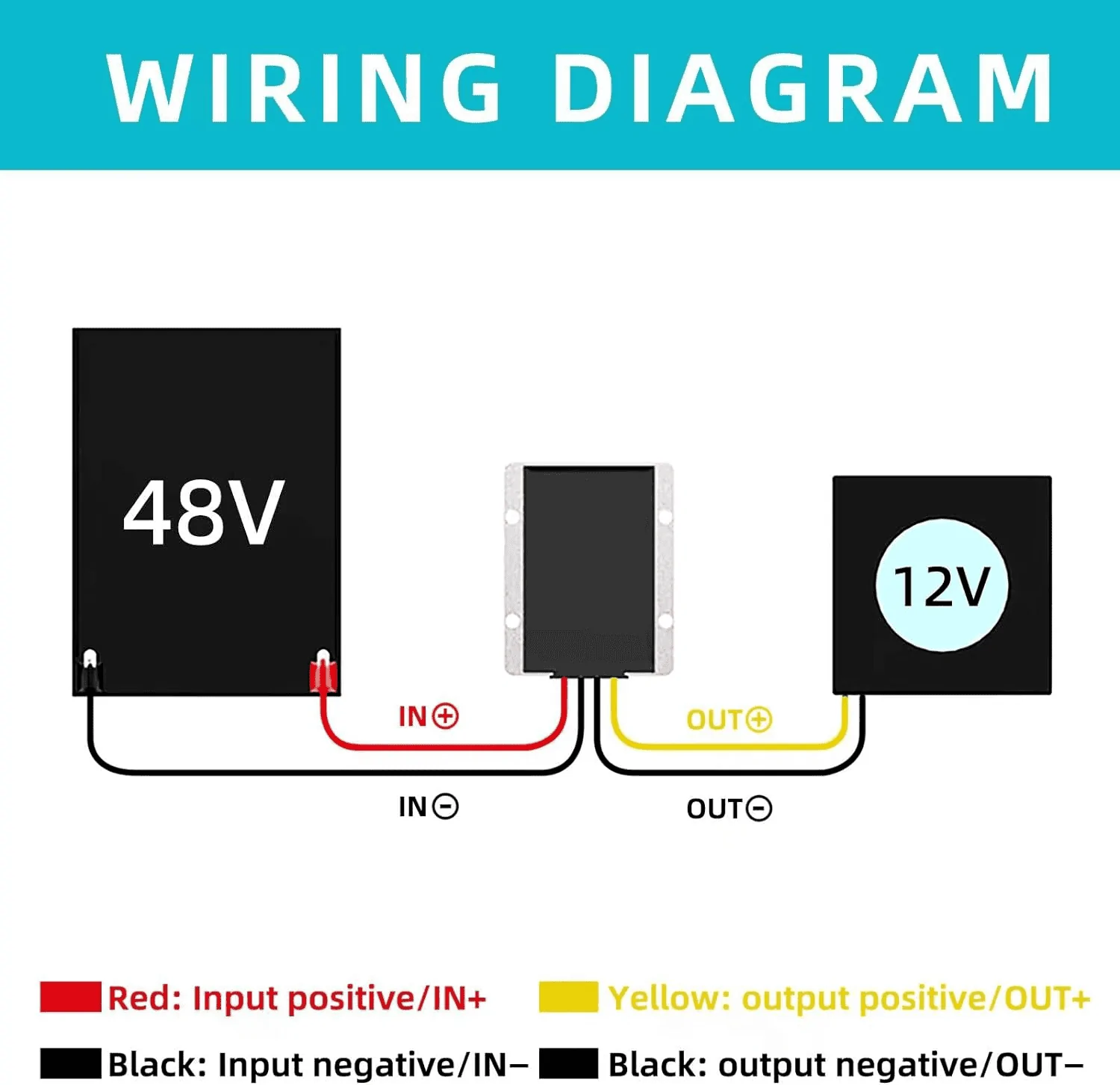

This is what I plan to do to install a hitch or a regular 12v lightbar to my Cybertruck. A step down from 48 to 12. Unless someone points out if this Amazon one is a bad idea, I will probably buy it soon. https://amzn.to/3QX1WcL
Tesla Cybertruck So... About that winch.... 48-12-stepdown
I mean, the frunk is plenty large enough to house a 12v sub system like this. I might do this also
That thing is tiny. Like 3" x 3" x 1.5". I would probably just wire it under the plastic frunk tub right by the mods wires.

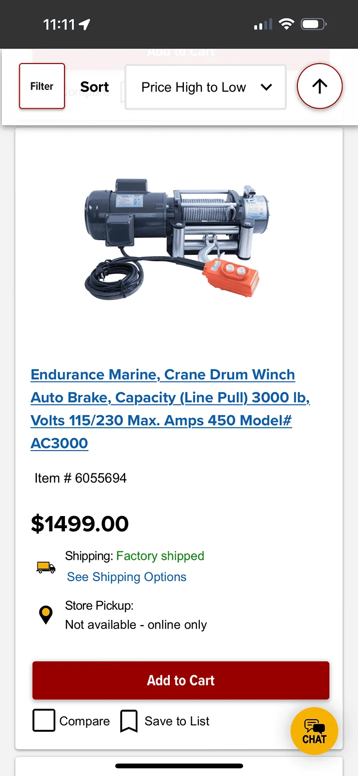

This thread is blowing my mind, thank you all for the enlightening comments. I’ve always thought the higher the voltage (ie 48V), the lower the current required. In the end, power, which is voltage X current would be similar for 12V and 48V systems. But guess not. Perhaps thinking outside the box and going with a 120/240V plug in winch that’s welded to mount to the hitch would be the best idea? Removable, until needed. Does this have an integrated AC-DC converter?
https://www.northerntool.com/produc...s-12-model-15000nh-6024003#hotbar-description
I meant your battery. A winch will pull a lot of current at load, you need a good marine or car battery.
That's a 12v DC winch. Most ac winches that I know are overhead hoist style things. But that is certainly outside of the box!

You are correct, this is a crane drum winch….title shows 115V/230V max. Crazy amps though.
