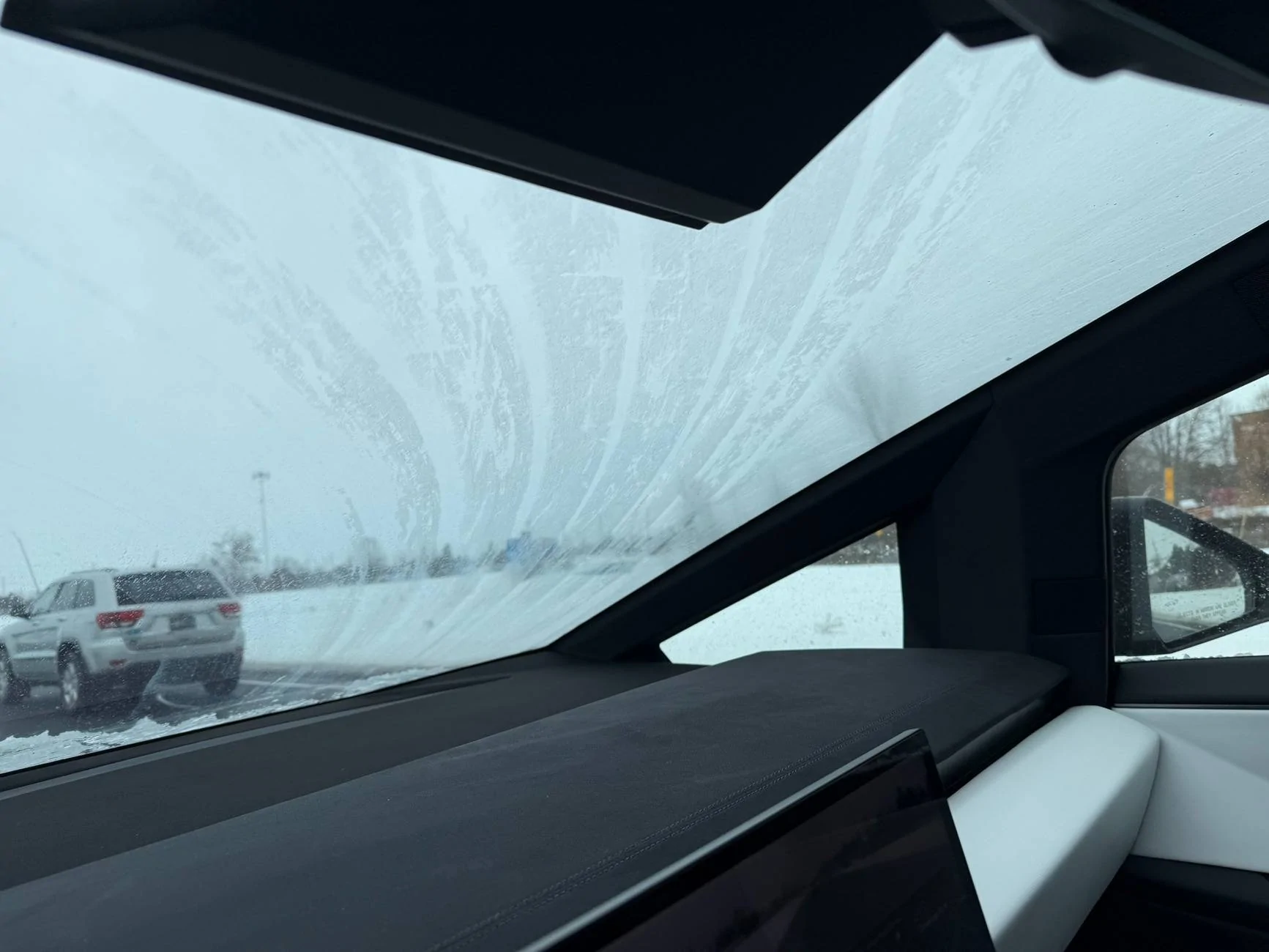

I live near Toronto and we use a lot of salt on the road. Driver side is okay, but passenger side is awful. I have to use a lot of washer fluid just to get it what you see in the picture.
That's about how mine looked! Try the Drop Flop. Worked for me at about 25 degrees Fahrenheit.
