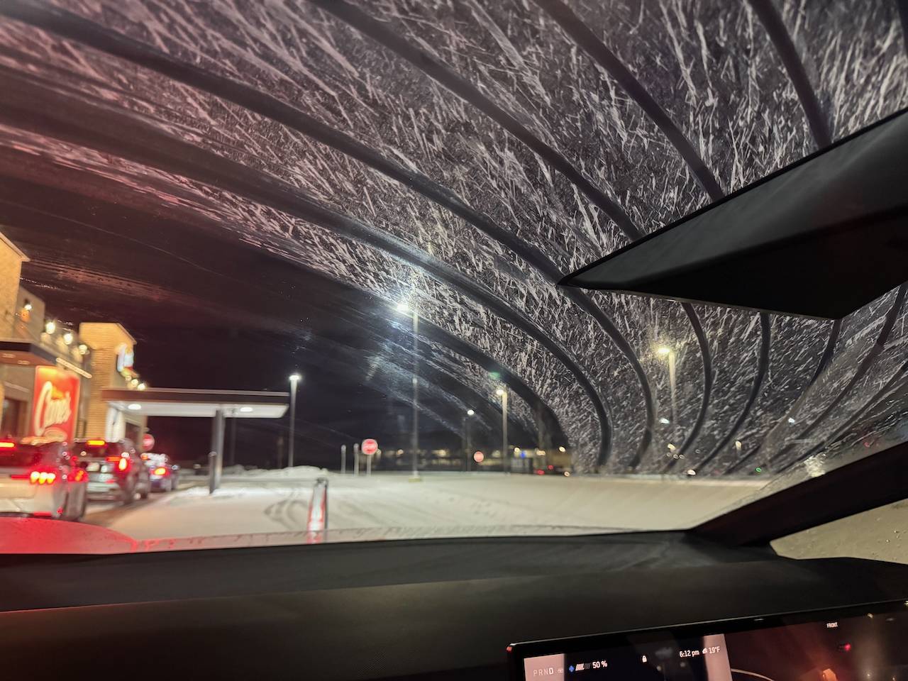

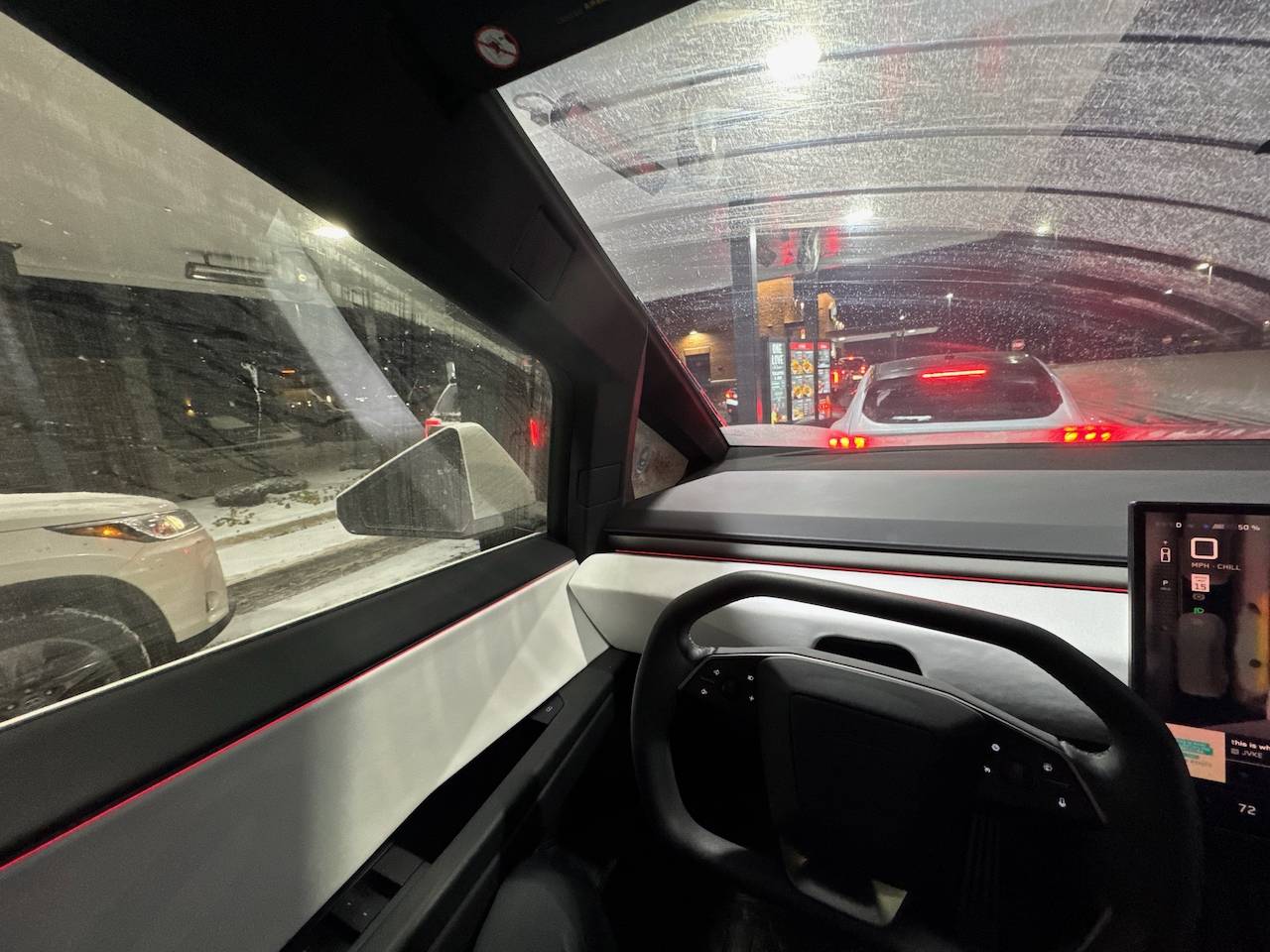

Salty roads in Ohio... same experience as others. Passenger side is barely touched other than where the fluid is dispensed. I've had the blade and arm swapped about three times.

Pretty good during rain. Kinda sucks in every other circumstance.
  • Only sprays in laminar jet lines instead of atomizing.
  • Fluid is not dispersed proportionally to the radius.
  • Only sprays when wiper is ascending.
  • Water accumulates under the wiper when it’s horizontal and creeps up the windshield when the wiper is turned off.

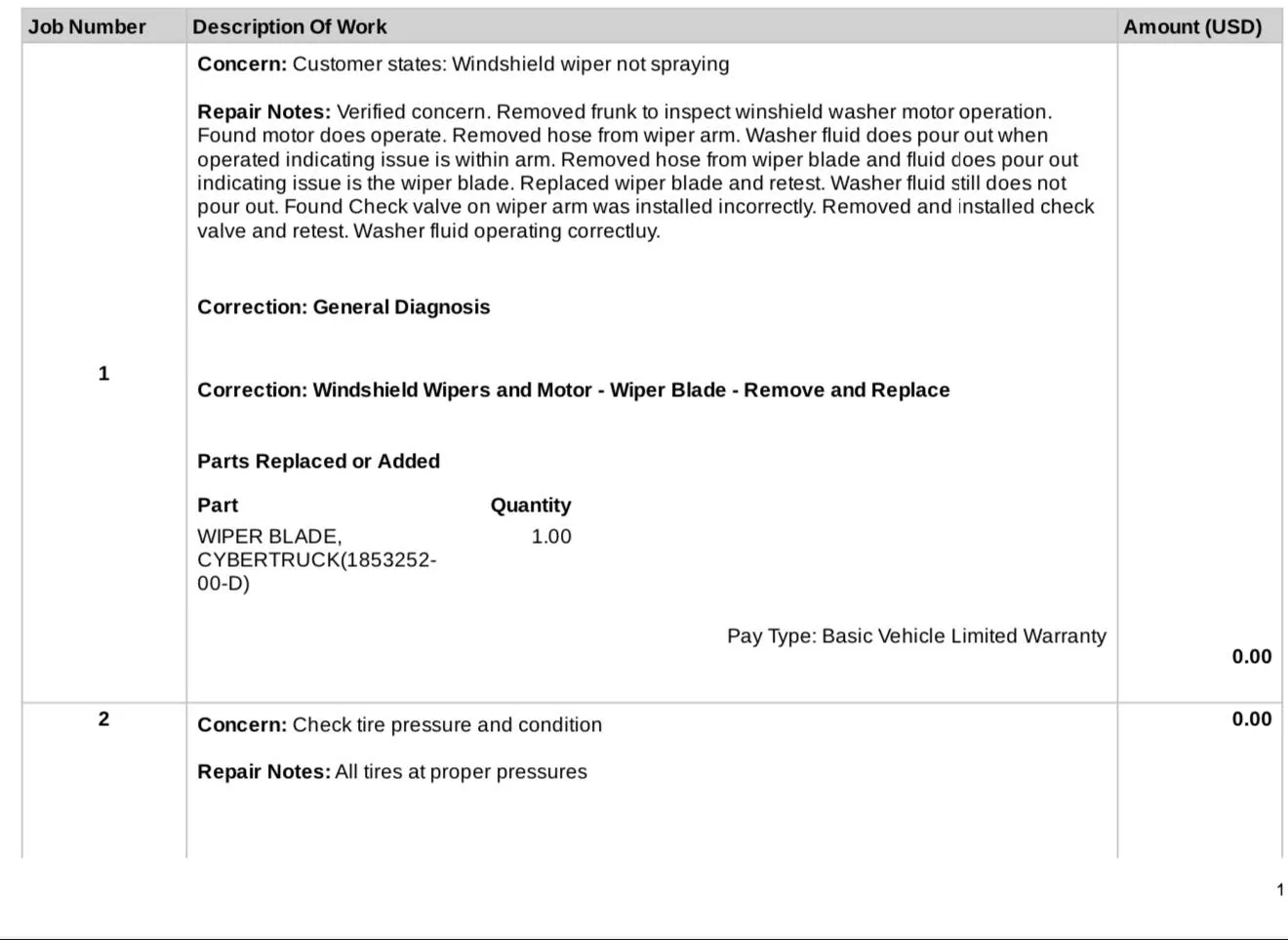

My Wiper is the worst part of the cybertruck. It does not spray or clean. i have to carry a damn long squeegee around with me. Guess thats what the frunk is for.
When I took delivery of my non FS Cyberbeast (2 months ago) my wiper didn’t work at all, had to get it fixed 3 weeks later, it’s fine now.
What did they replace on your wiper? The motor?

Just to add, yes, it’s terrible when there’s salt on the road. It just smears it all over. This is the single bad thing about the Cybertruck.
Honestly, I’m just shocked they didn’t test it in snow / salt areas during vehicle development…

Agree! I also did the recall with motor and they replaced the arm and blade too. It's terrible and no matter how much washer fluid you use it still smears.
