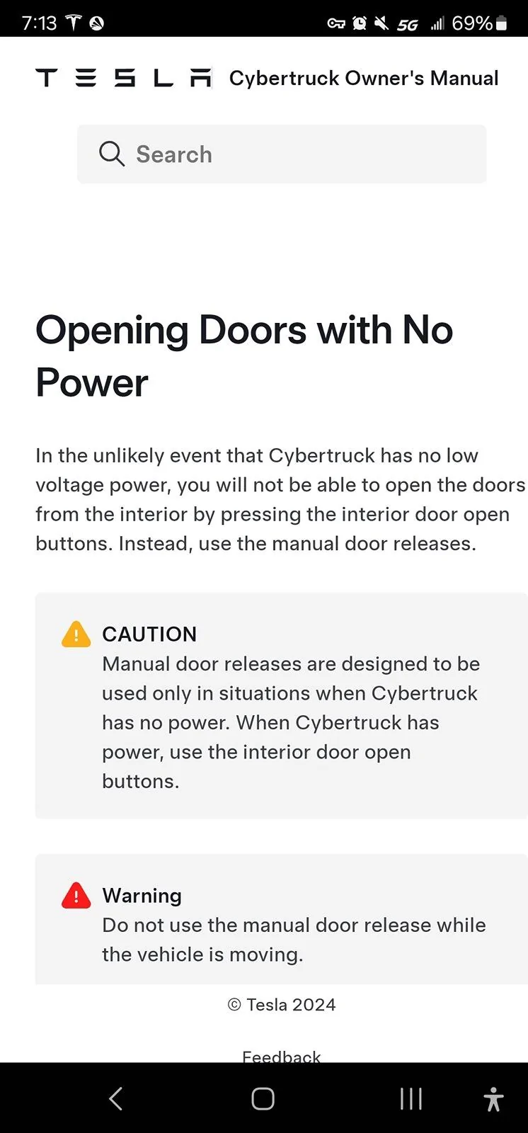

When a door is opened normally its window is lowered slightly before the door latch is released electronically by the truck's control system.
If the door is opened with the emergency release the window isn't lowered before the latch is released mechanically by the release lever. Also, the emergency door release event is recognized by the system and a warning of the unusual action is recorded and displayed.
I'm not sure whether or not the window seal or some other component would be damaged over time by using the emergency release, but the warnings are annoying enough for me to try to avoid it.
