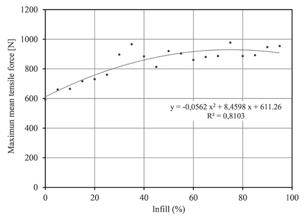

Yup. That and there have been many studies showing diminishing returns above 50% and even less strength at 100%.

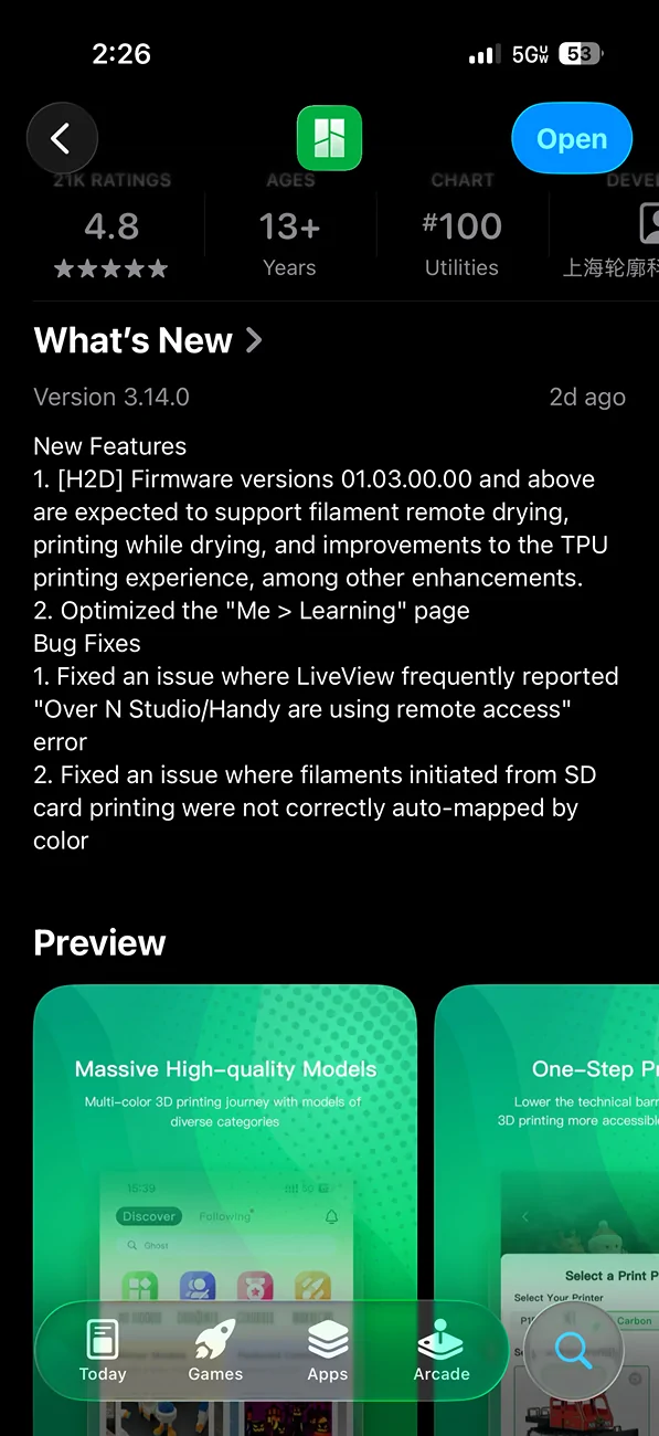

The new Bambu Studio update allows for dry filament while printing and setting up drying via the Handy app

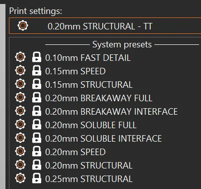

Humidity looks pretty good. Find something small to test with and try increasing the nozzle temp +10 to +15C. That should help. If not try slowing it down. I am not familiar with Bambu, but Prusa provides a couple profiles: stay away from the speed profiles - those are great for quick prototyping prints that don't have to be strong but not good for final prints. I customized the "structural" profile a bit further ("STRUCTURAL - TT" below) to change the infill to 40% Triangular (triangular is stronger than rectilinear).

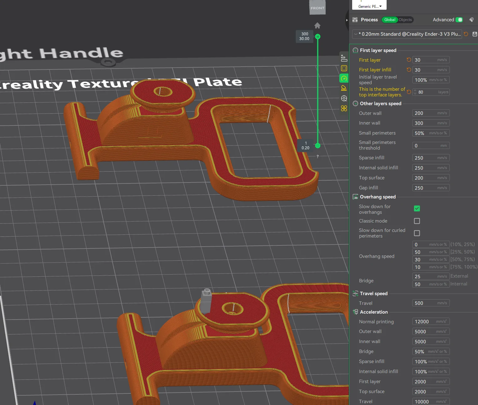

Speed and temp make a huge difference. Printing at 250 centigrade and speed slowed down has led to less issues. It does take 2 hours and 20min to print two of these on my printer though.
