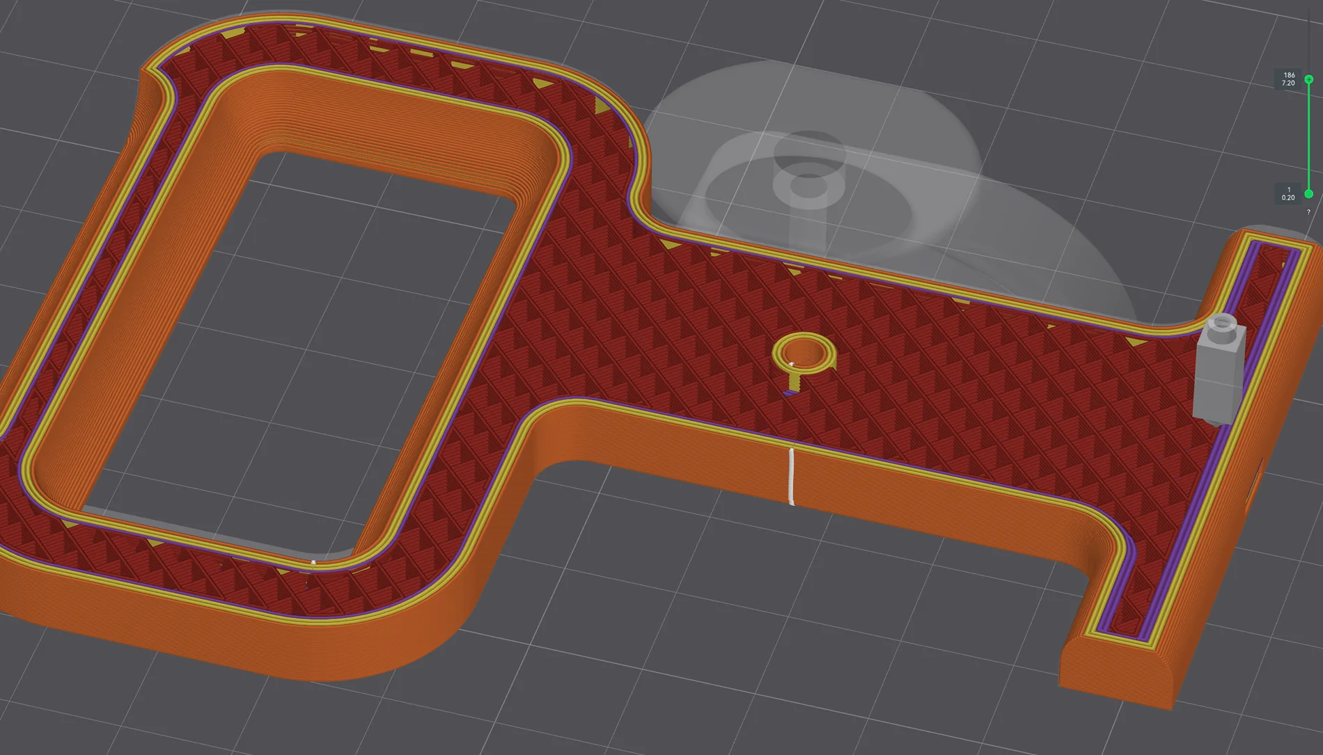

For the popcorn: here is difference in 10% vs 15%:
15%:
Tesla Cybertruck Emergency Exit Rear Door Release Ideas 1769707083976-ii
And 10%:
Tesla Cybertruck Emergency Exit Rear Door Release Ideas 1769707067005-lz
116
8,375
9,628
So what is infill?

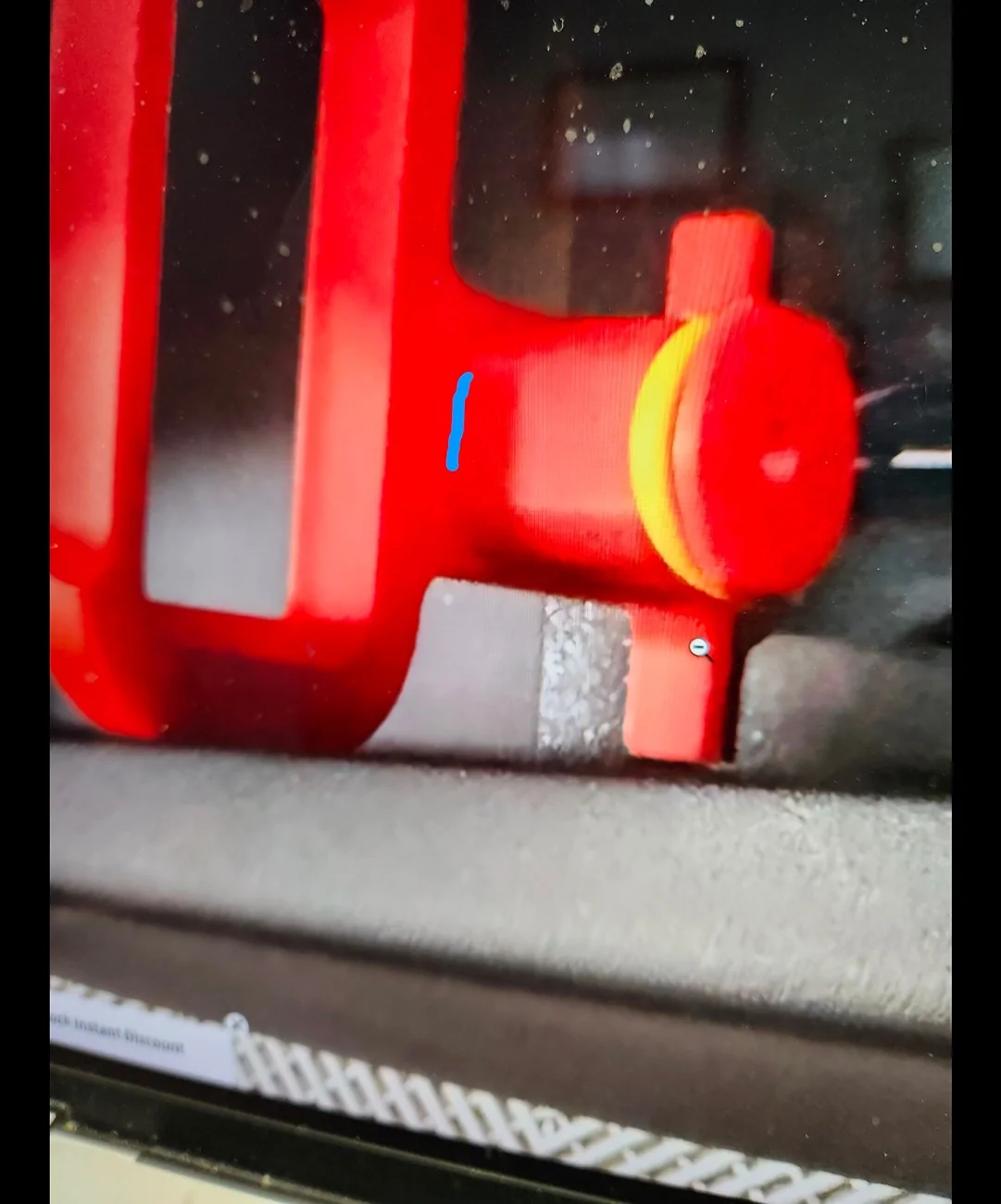

Could it be due to layer height and infill? I'm printing at .20 and 15% infill and it is very strong.
I actually did bump up the infill, I set it to 20% knowing its something that is going to take force, I did not adjust the seam however. The problem is all the force of pulling it relies on that one layer I highlighted before staying in tact. Hence why they put the screw hole there. Both my R and L broke exactly the same way in the same spot.
TickTock
Jul 27, 2023
41
857
1,822
Phoenix, AZ
Electrical Engineer
If you want to and if you can, send a pic of the actual pull handle from the side, I can show you where it

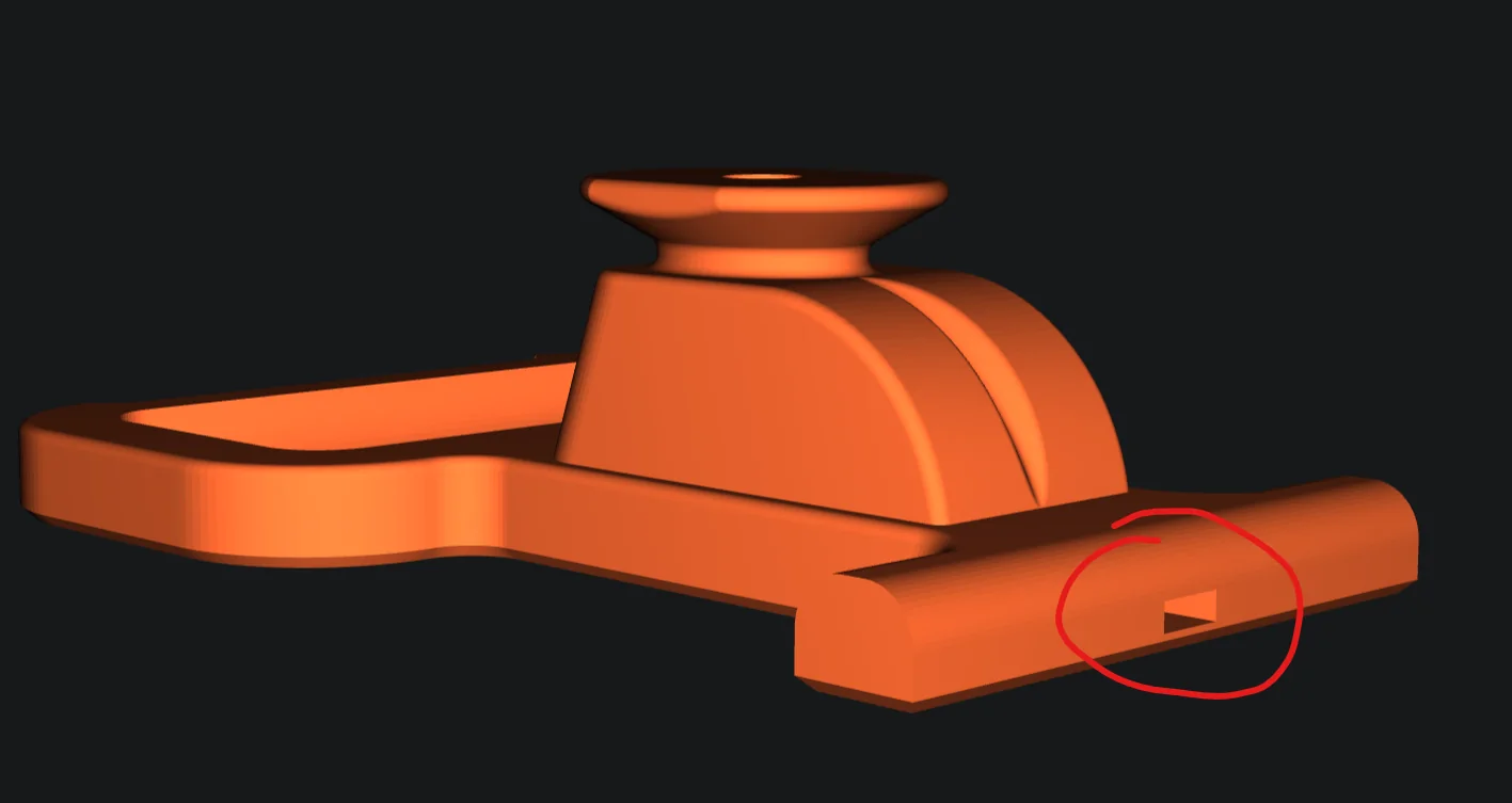

So the flaw is at this layer where it meets the handle - I took the pic off your site just to illustrate it for you, I'm in no way implying yours have the same flaw. However, I suspect the original designer knew it was a weak point as they put a hole for an M3 screw, but even with that, it would need some form of internal nut in the main body of the handle to not come apart.
There *is* an accommodation for a square nut in the handle. Push it in here:

The right way to do it would be to pause the print at that layer height, put in a threaded hot insert and then finish, this way the screw can grab the main body. That would be bullet proof

A couple more suggestions. @That Beast Mode is quite correct that layer separation is a weakness of 3d prints. I have found, though, that good dry PETG filament with the nozzle temperature set on the high side helps a lot to get a good attachment. That plus printing in an enclosure has resulted in PETG and PCTG parts with very good layer adhesion for me (just as likely to fail across the grain as with it). I did, however, provide the nut and bolt option because I know this is a common issue many face (myself, included).
