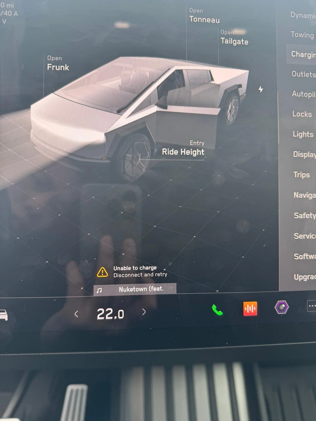

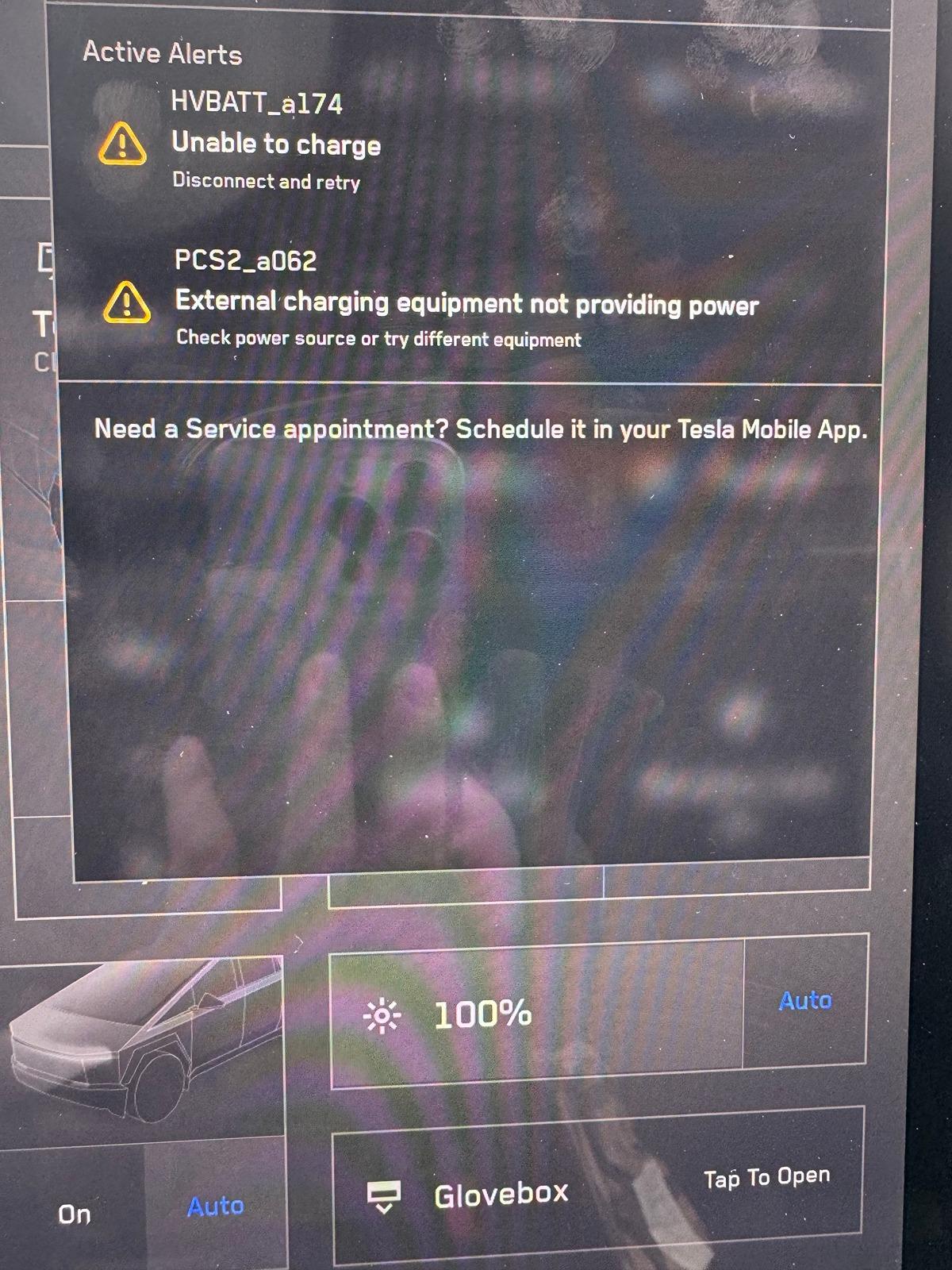

Super sad - I had a similar issue though yours sounded much more severe.... mine wont accept charging and it's less than 250 miles ....
Mine won't accept charging also. Look in service tab, see what error did you get? Tesla told me not to drive but just tow to the Service Center because once the CT is completely dead, it's very hard to tow (per Tesla tow guy also). So take in for service ASAP, mine was determined to be high voltage battery, and they will receive the replacement next week, and hopefully that will fix it.
dorylee
Jan 24, 2024
60
110
San Francisco
Cybertruck FS AWD
this is what I got - I was lucky enough to still have DC charging capability ... so its not completely dead, but really annoying for sure
