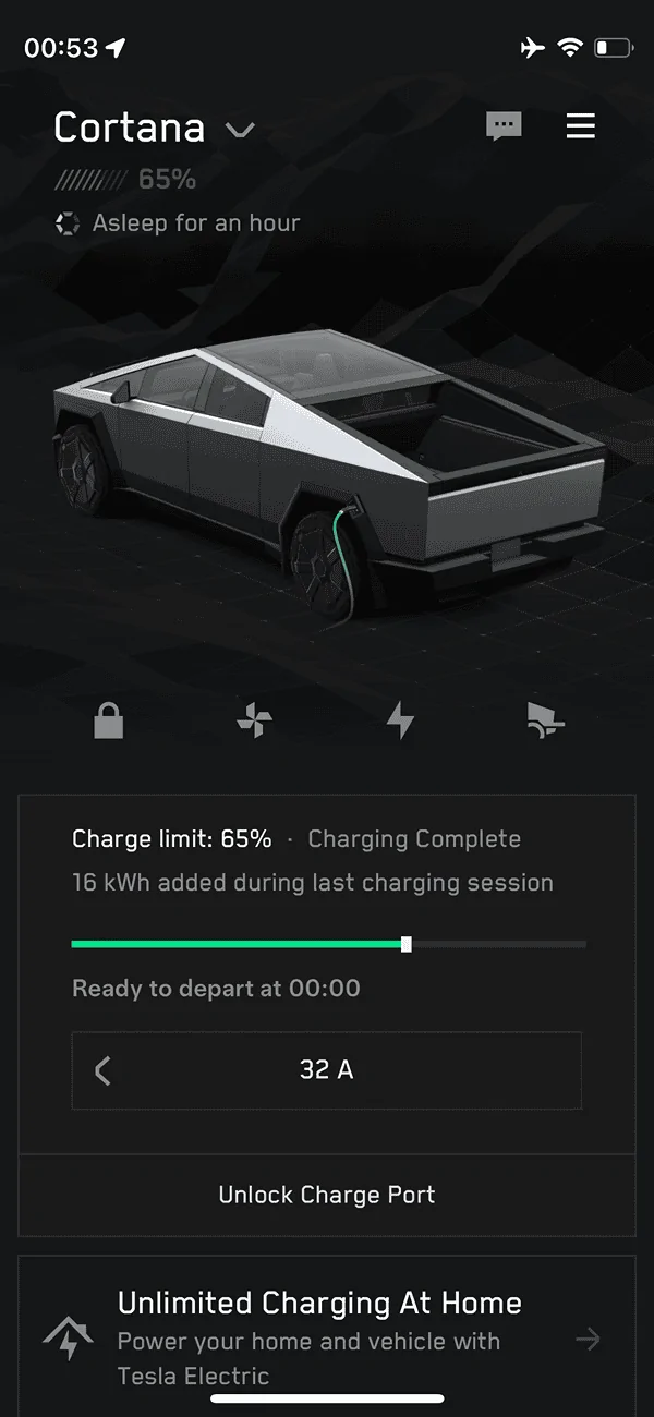

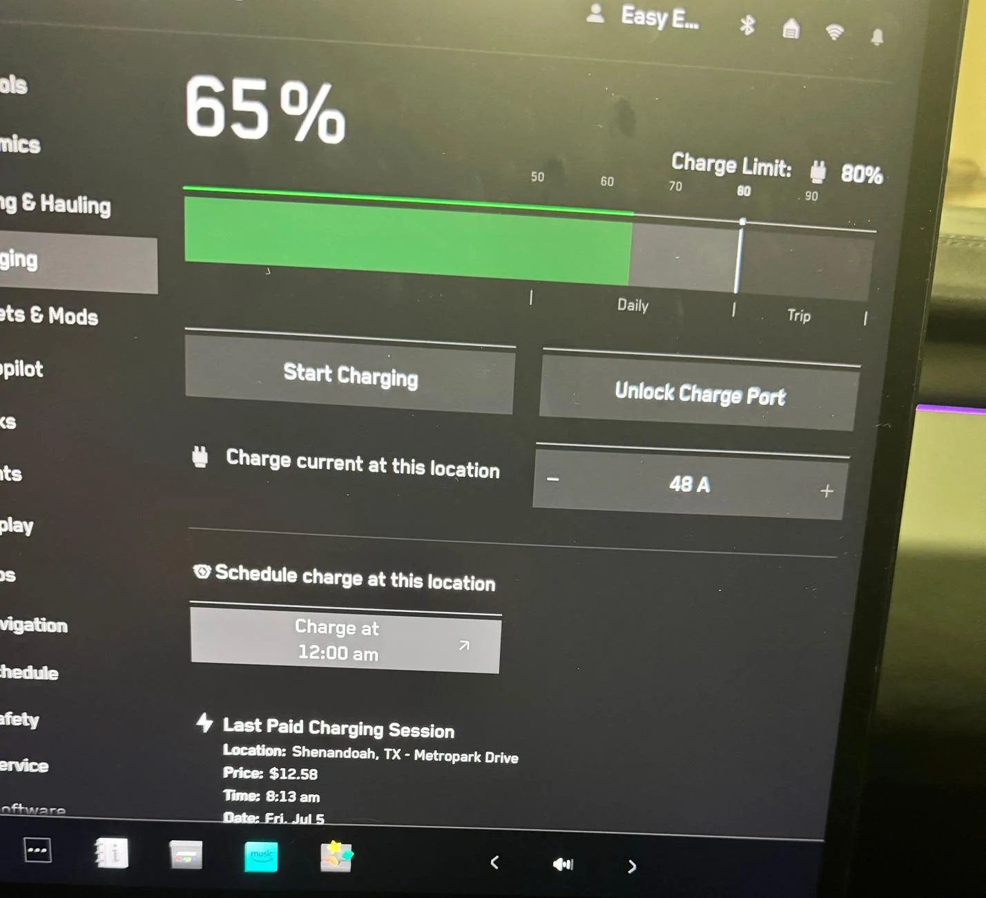

Today, while sitting in the driveway but still on WiFi the Beast updated to 2024.26.7. Same day I was having my new Wall Charger 3 installed. Pulled her in, plugged her in and everything looked good but it stopped charging after a few moments and the charger light turned blue. Have played with it to with no luck so with Tesla Support closed I pulled out the Mobile Charger and was forced to plug it in to 120 and it did the SAME thing so it is not the wall charger.
Is there a way to reboot the Trucks computer and see if that clears up the problem...I am in sort of a bind without being able to charge and would appreciate any help you guys can render. THANKS

What a crazy 24 hours! In a way, I owe you all an apology for initially pointing the finger at the software. After twenty-four hours of troubleshooting, I finally figured out the cause during a brainstorming session with an industrial-sized Wrangler Iced Tea (15 oz of cheap vodka with a shot of Arizona Tea… or is it the other way around?) and my iPhone.
I spent time reading all of your kind comments and talking with Tesla Techs. Everything checked out—the Wall Connector, Mobile Connector, removal of scheduling from both of our iPhones, proper firmware, and Tesla Electric, which scheduled the 12-6 AM charging. We should have been able to override it at any time, but something wasn’t adding up. That’s when I noticed a very important icon right next to the Tesla App… drum roll, please… Tessie.
Yup, Tessie was holding us to the 12-6 AM charging time. Once I disabled that, guess what? Life is good again.
I came to you first because there’s a wealth of EV experience in this community, and I’m still a newbie to this technology. Over the past day, I’ve become a quick study, thanks to all of your suggestions and help. But in the end, it was a third-party app that had everything mixed up. Truly a learning experience.
