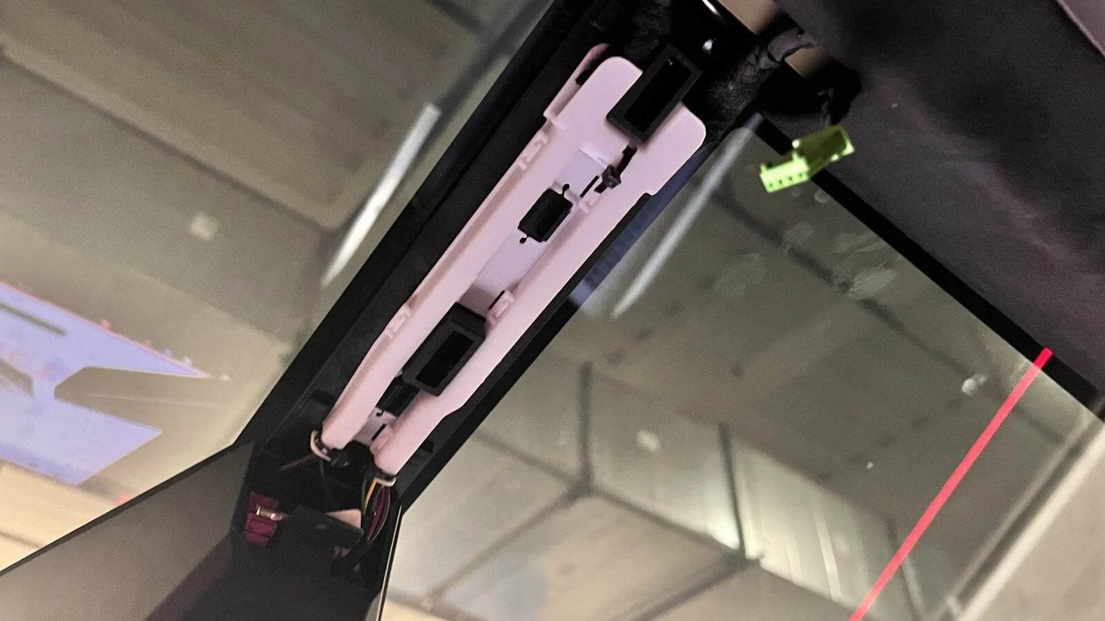

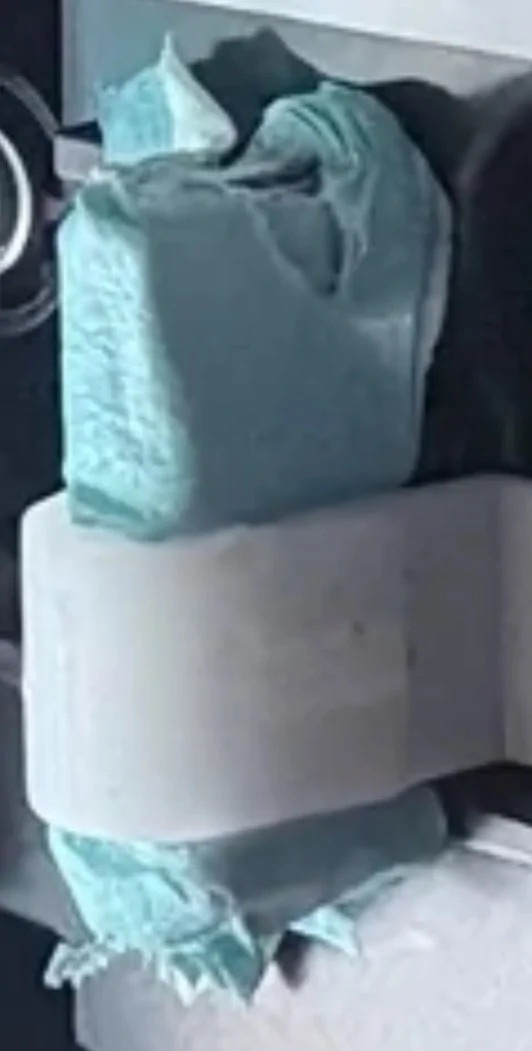

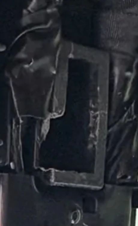

I have had this issue since I bought the truck almost a year ago. I have brought it to the service center twice for a fix. The first time they simply stuck double sided tape on it, which did not work at all, and it literally fell back down as soon as I picked my truck up from them. I have just been dealing with it hanging down until I got fed up and recently brought it back in again. This time, they updated my service ticket to bring it back in a third time after they ordered a new windshield replacement since that assembly is permanently attached to the windshield and that was all they could come up with to fix it. Well, both me and the service advisor thought that was stupid as hell to fix a 1-cent plastic clip's failure to hold, but they didn't know what else to do. So, I put some thought into it, especially since my windshield is also tinted with high-quality cermic tint, and Tesla does not reimburse for that.
And I figured it out. I simply heated the female receptical where the clip connects with a heat gun, squeezed it with some pliers, and now the connection is solid as a rock. I notified the service team to cancel the new windshield. See below pics.
The problem:
The service center's 1st attempted "OEM" double sided tape fix 🤦‍♂️:

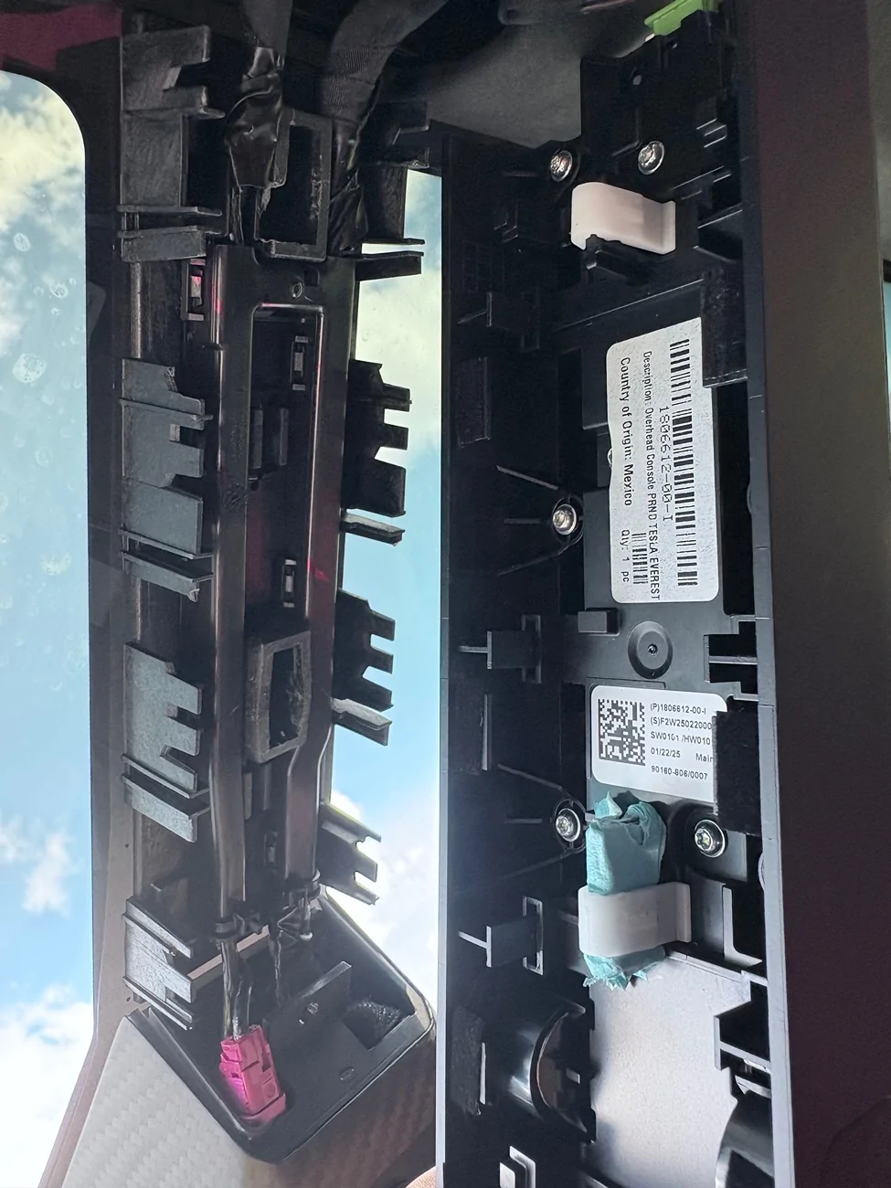

What the white plastic male clips look like with console removed:

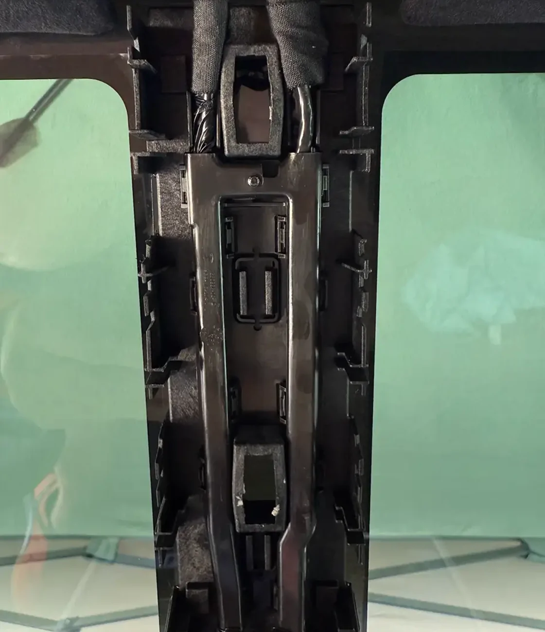

What the overhead female recptacles looked like on the overhead console:
Heating the bottom receptacle with heatgun:
Squeeze with pliers (I used channel-locks) and allowed to cool:
New, tighter, receptacle. I left the top one alone since that was not causing the problem:
It is now snapped back into place and solid as a rock.
