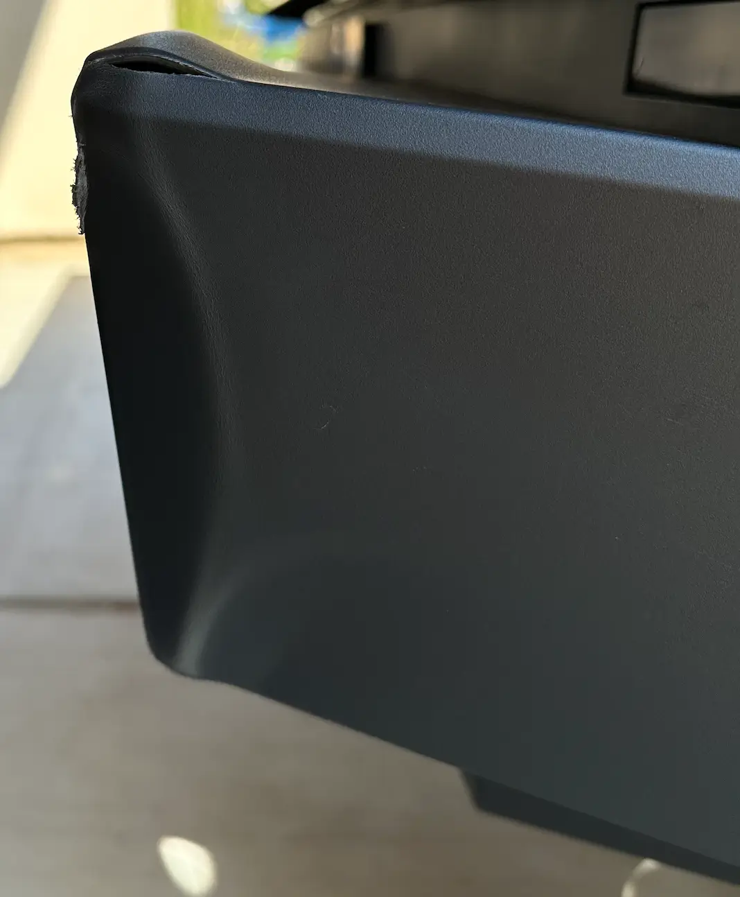

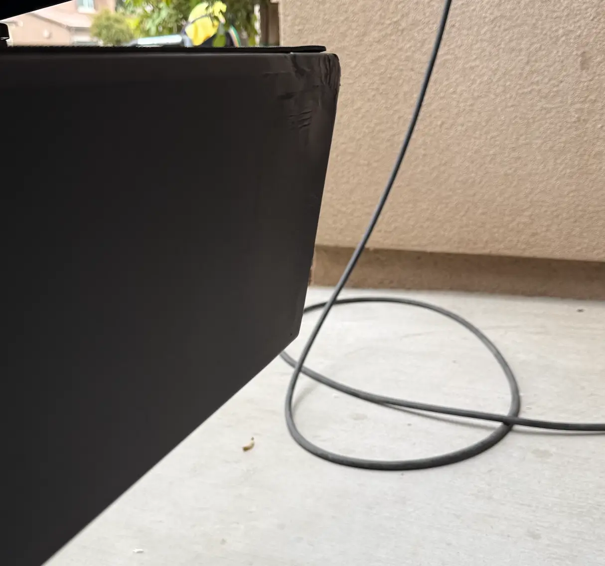

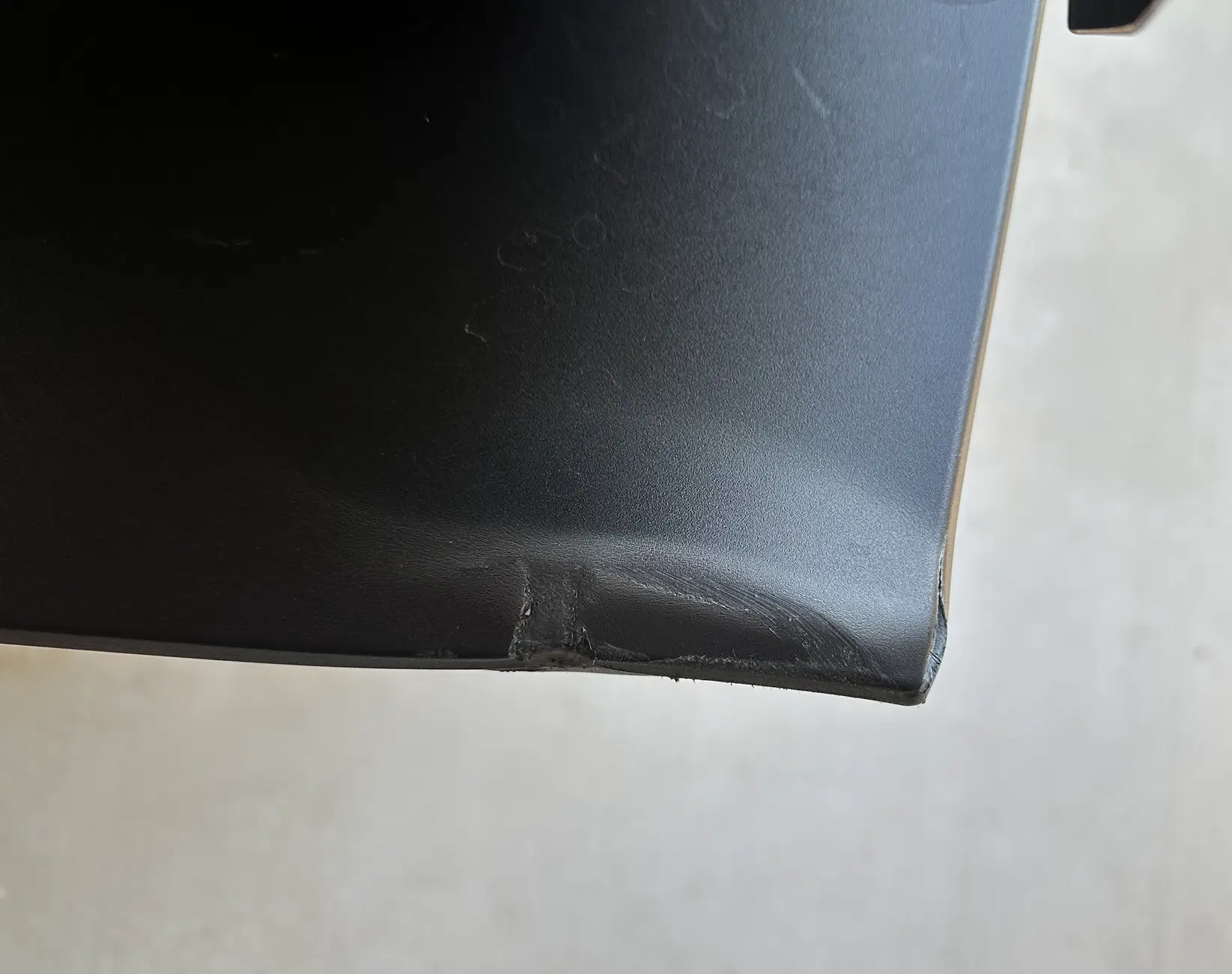

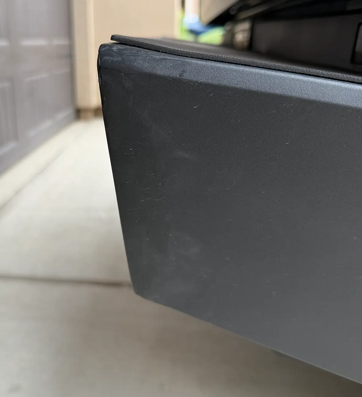

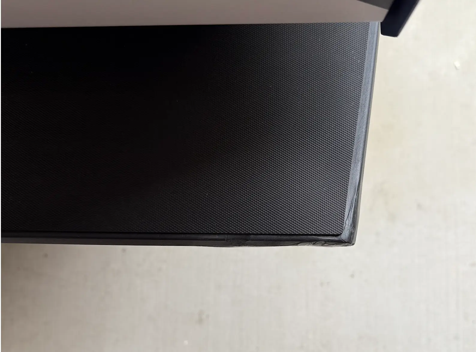

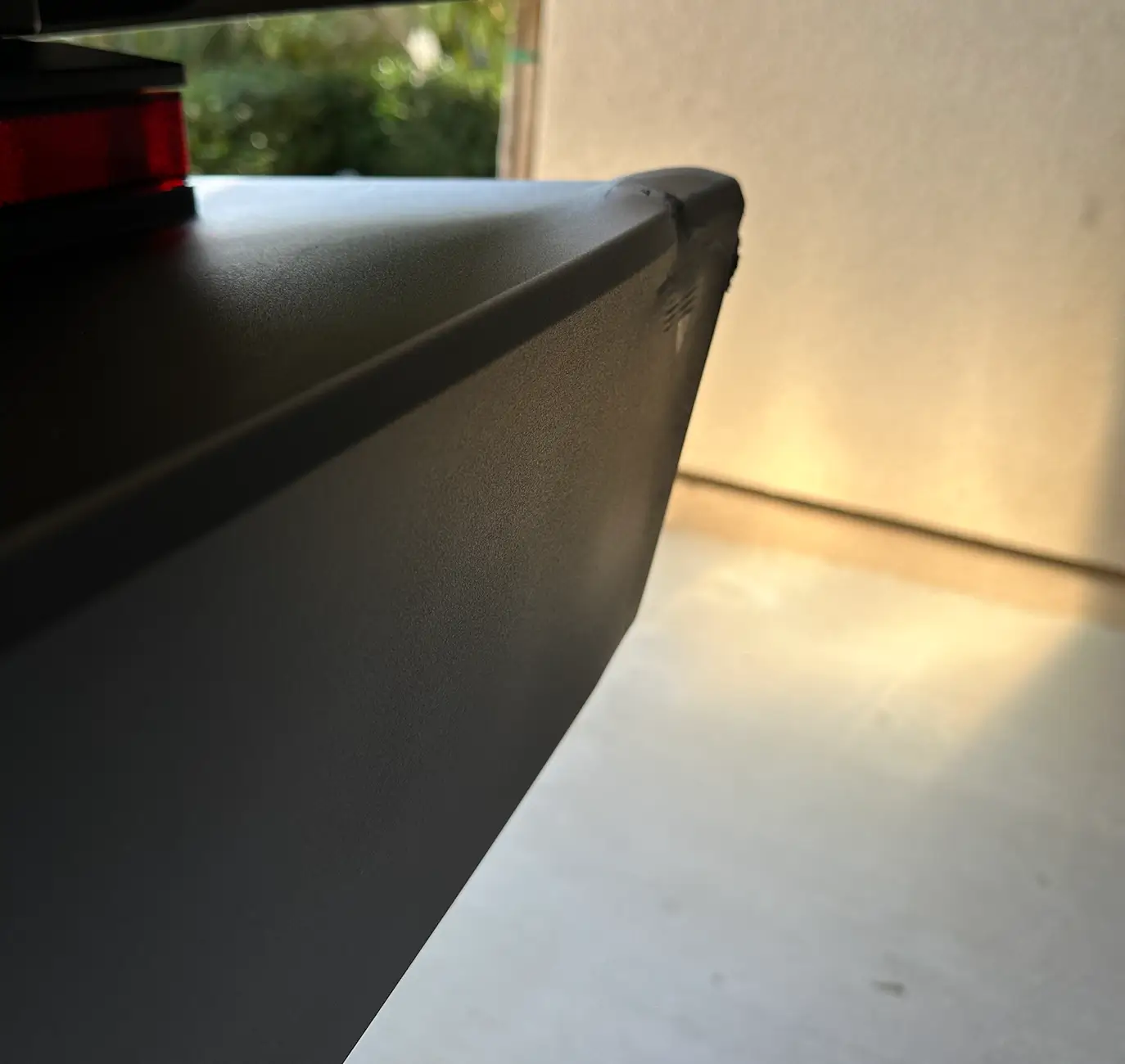

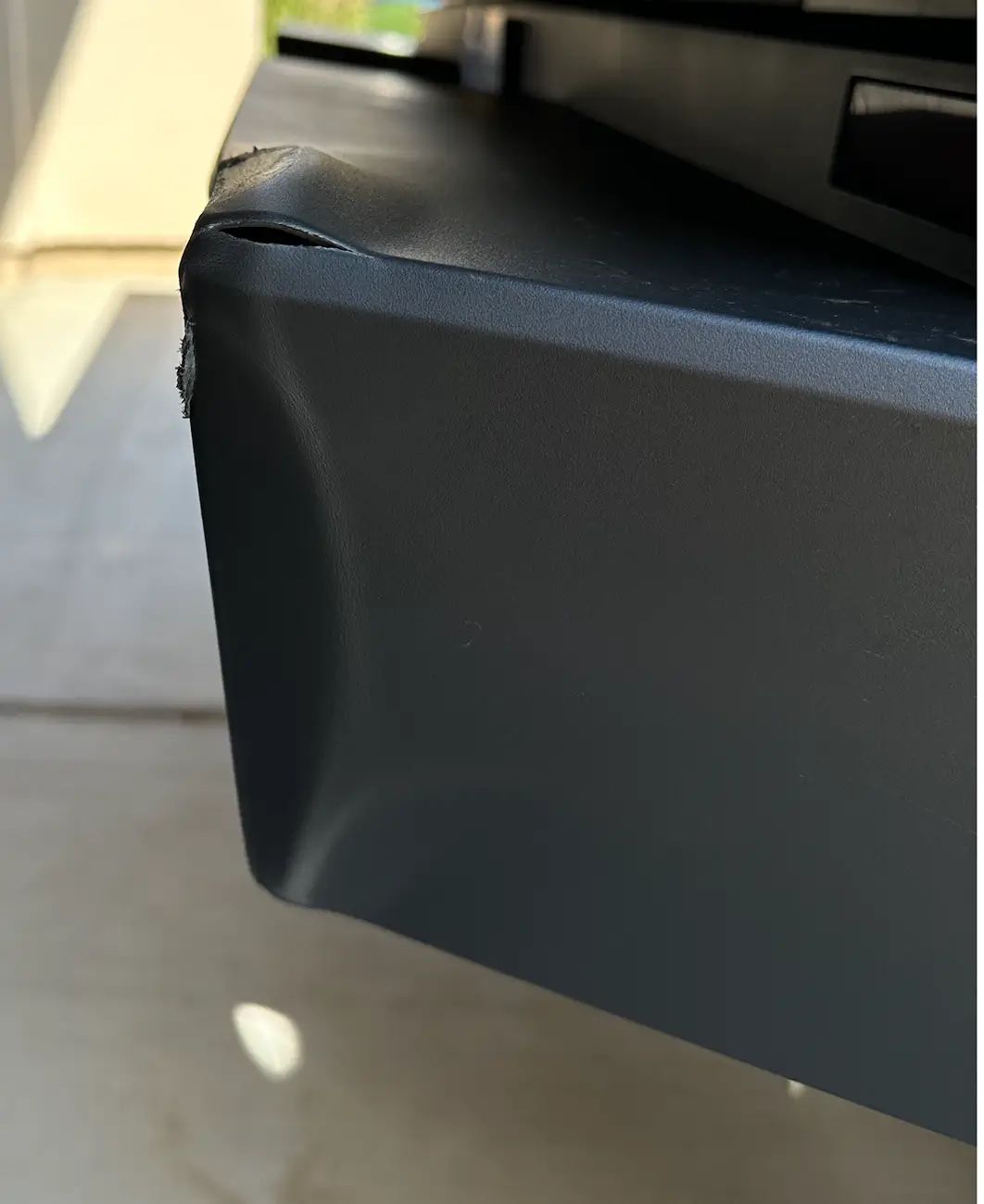

Before:
Before:
After:
Before:
Before, Looking straight down:
Now, after remolding with heat gun:
After:
So, not perfect, and still has minor cosmetic defects, but coupled with a cheap bumper cover from Temu, it's better than a $2K replacement bumper. And to be honest, you only see these minor defects because of my high resolution pitcures. If you just glance at the bumper you don't notice anything as it's shape is mostly restored, and it's all black.

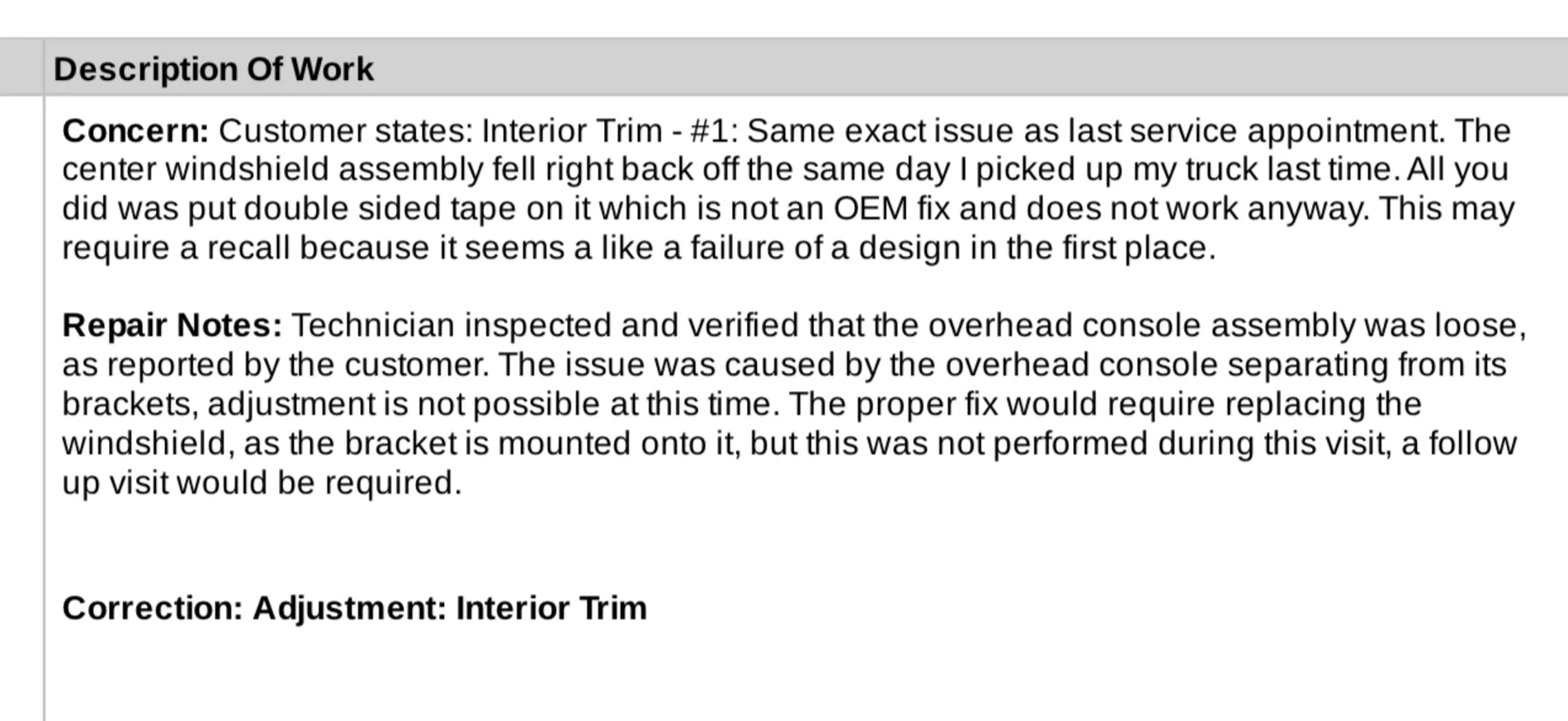

I have had this issue since I bought the truck almost a year ago. I have brought it to the service center twice for a fix. The first time they simply stuck double sided tape on it, which did not work at all, and it literally fell back down as soon as I picked my truck up from them. I have just been dealing with it hanging down until I got fed up and recently brought it back in again. This time, they updated my service ticket to bring it back in a third time after they ordered a new windshield replacement since that assembly is permanently attached to the windshield and that was all they could come up with to fix it. Well, both me and the service advisor thought that was stupid as hell to fix a 1-cent plastic clip's failure to hold, but they didn't know what else to do. So, I put some thought into it, especially since my windshield is also tinted with high-quality cermic tint, and Tesla does not reimburse for that.
And I figured it out. I simply heated the female receptical where the clip connects with a heat gun, squeezed it with some pliers, and now the connection is solid as a rock. I notified the service team to cancel the new windshield. See below pics.

I originally bought it to fix a ding in my bumper where the approved Tesla Collision Center wanted to replace the whole bumper for like $2K. You can't even tell it was dinged anymore.
The best thing I learned from this truly awesome post is that you can fix bent bumpers with a heat gun!
I slightly bent my former Jeep’s bumper and now realize that I easily could have fixed it. This heat gun looks like my new favorite tool.

So how do you pull out on the dent once you heat it?
Not sure how the OP did it with the Cybertruck’s bumper?
I just heated it until the plastic was malleable and then pushed on it with something flat. I think I used a piece of wood and a big metal crescent wrench I had. I then “smeared” the plastic to close the spot that was ripped open.

If it was a part of the windshield, then it would presumably be supplied with a replacement windshield. I haven't heard of that being the case though...
It just depends on the competency of the particular SC. I posted this above somewhere, by here was my last service entry which I cancelled and fixed myself:
Tesla Cybertruck Fix for loose overhead console assembly (where magnetic sunvisors attach) 1758852682046-nn
