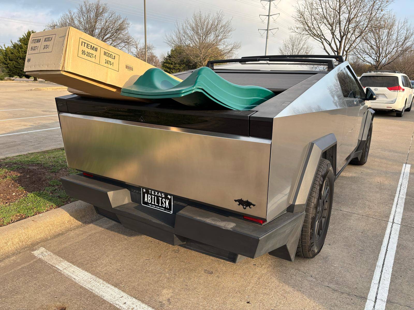

Yeah, it needs all its cameras. I keep my tailgate closed and just rest long items on the top of the tailgate sticking out a little. Obviously it depends on what it is, but I do that whenever possible.
Tesla Cybertruck FSD disabled if Tailgate is down 2324d53b-a60b-47ac-bd25-351149667614
It worked for an entire play set, so it will work for most things.
