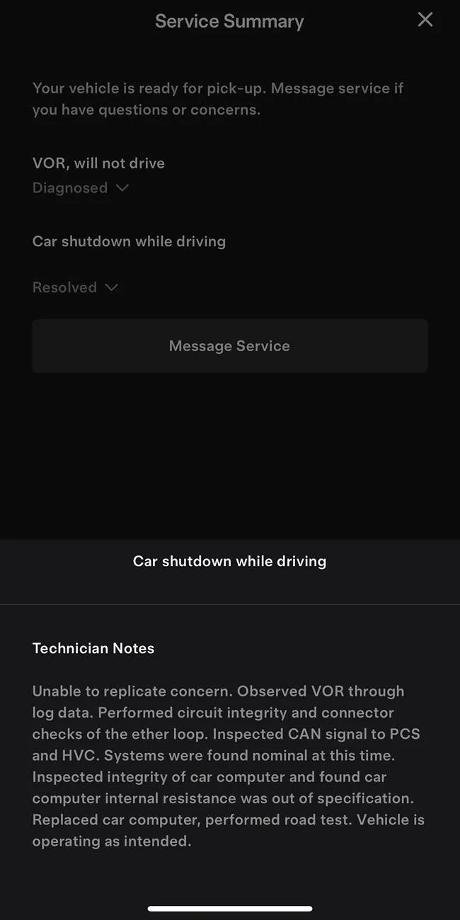

Final chapter: they called today and said it was ready- after 19 days. I anxiously drove the 3 hour trip and picked it up after hours. It was cleaned and charged. And it drove as sweet as it ever did on FSD home. Here was the diagnosis and treatment:
