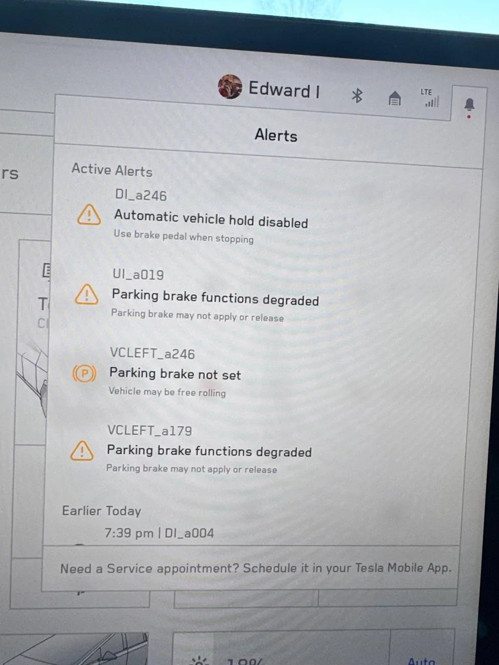

I still do not see that anywhere. It was just at the service center having 4 other things fixed two days ago. Where does it say battery cable and…which battery?
Tesla Cybertruck FSD Stopped, cruise stopped, parking brake degraded… IMG_4974

I saw it on your screenshot. Go back and look. I don’t think I hallucinated.

“Charging Cable Disconnected”. Did that mean you are not charging? Why would it say that unless a cable came loose?

Don’t ask me. But I think that is just a checklist for the car When in tow mode. Making sure the charge cable to say a supercharger is not connected while the world is ending in alarms inside the CT.).

The 11th post on page one.

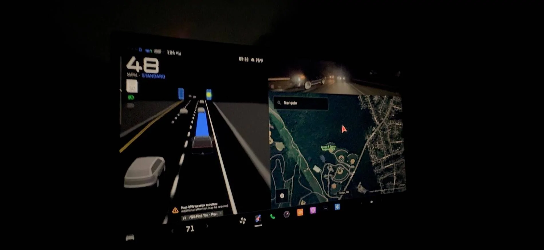

Through the app in various prompts. It was roadside assistance that put me through to support.
After driving in the opposite lane and it trying to make turns that don’t exist and switch into lanes on the right when I’m in the far right lane was crazy.
It worked out in the end but cost a couple of hours of wasted time on the phone for issues that shouldn’t exist.
They ran a diagnostic remotely and determined it was software related. I tried setting up an appointment and the soonest available in the area was the 29th. And I asked for a loaner in the meantime due to a safety issue, and they’re like, no way, you’ll just have to drive like a normal person, which is like okay, I don’t have a choice, however, to say the premium feature of which we all paid for it driving onto the opposite lane onto incoming traffic isn’t a safety issue, is a bit much.
Of course the disclaimer is that’s why it’s FSD “supervised “. Had I not been paying attention or nodding off, who knows what could’ve happened.
All and all, just wanted to throw out the concerns in case anyone else is experiencing it. I wish I could put the video, that’s too large when it’s having me drive through whole towns and forests 95 miles away from what the GPS was reading.
