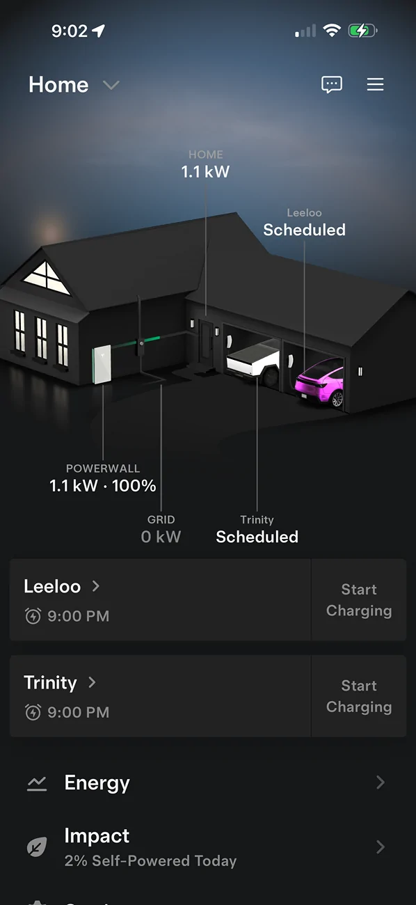

don't know if your wall connector has a schedule on it or not. Those are separate from the cars schedule and commands. I have had the same thing happen to me. If you have a schedule for the wall connector you need to go into the home tell it to start charging from there. Its always bugged me You setup a schedule for your home but the cars do not honor it. IF I do anything outside the schedule, I go to the home page where the wall connectors are to start charging there. Note once you start charging there it will not reset to the schedule unless you unplug car and plug it back in.

I think D101010 nailed it. It had to be the charger schedule changed from an update.
