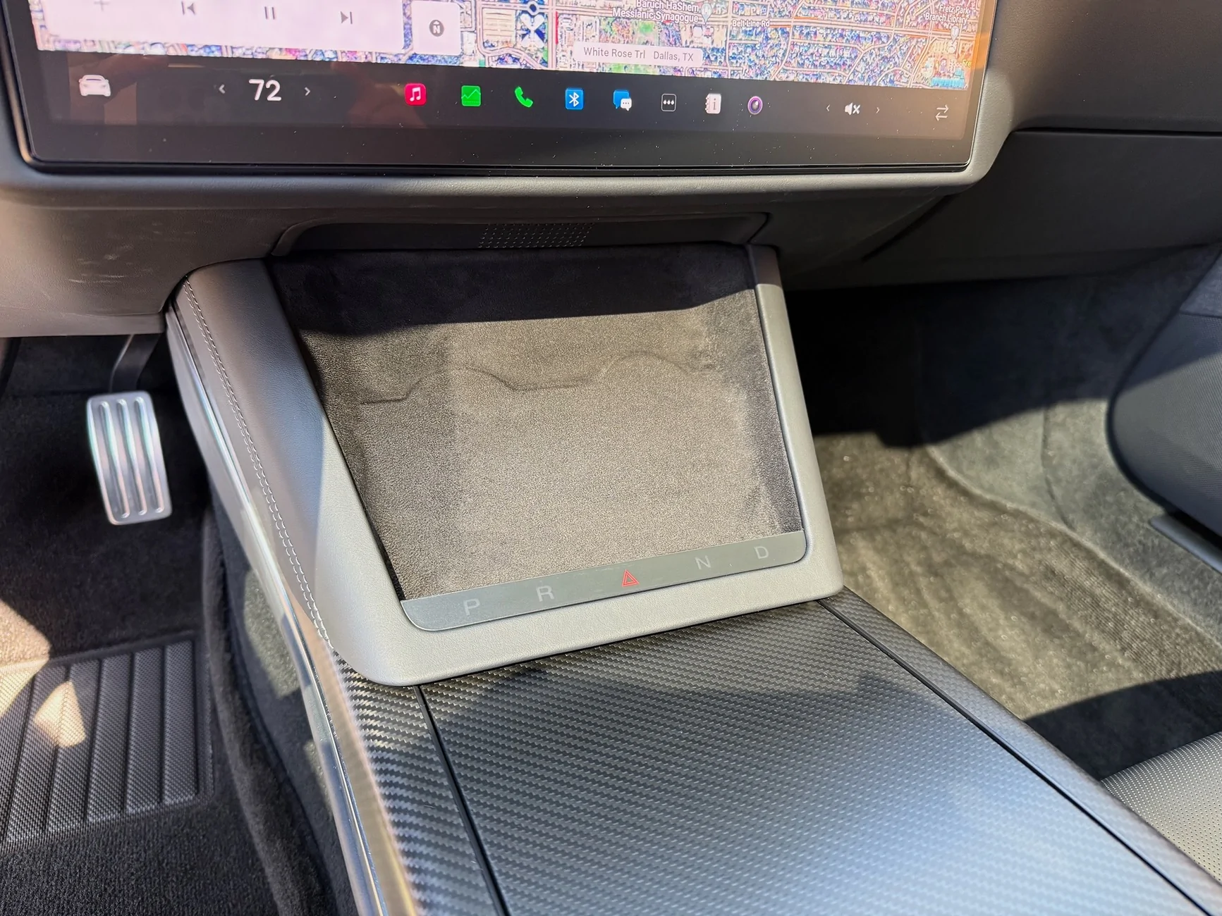

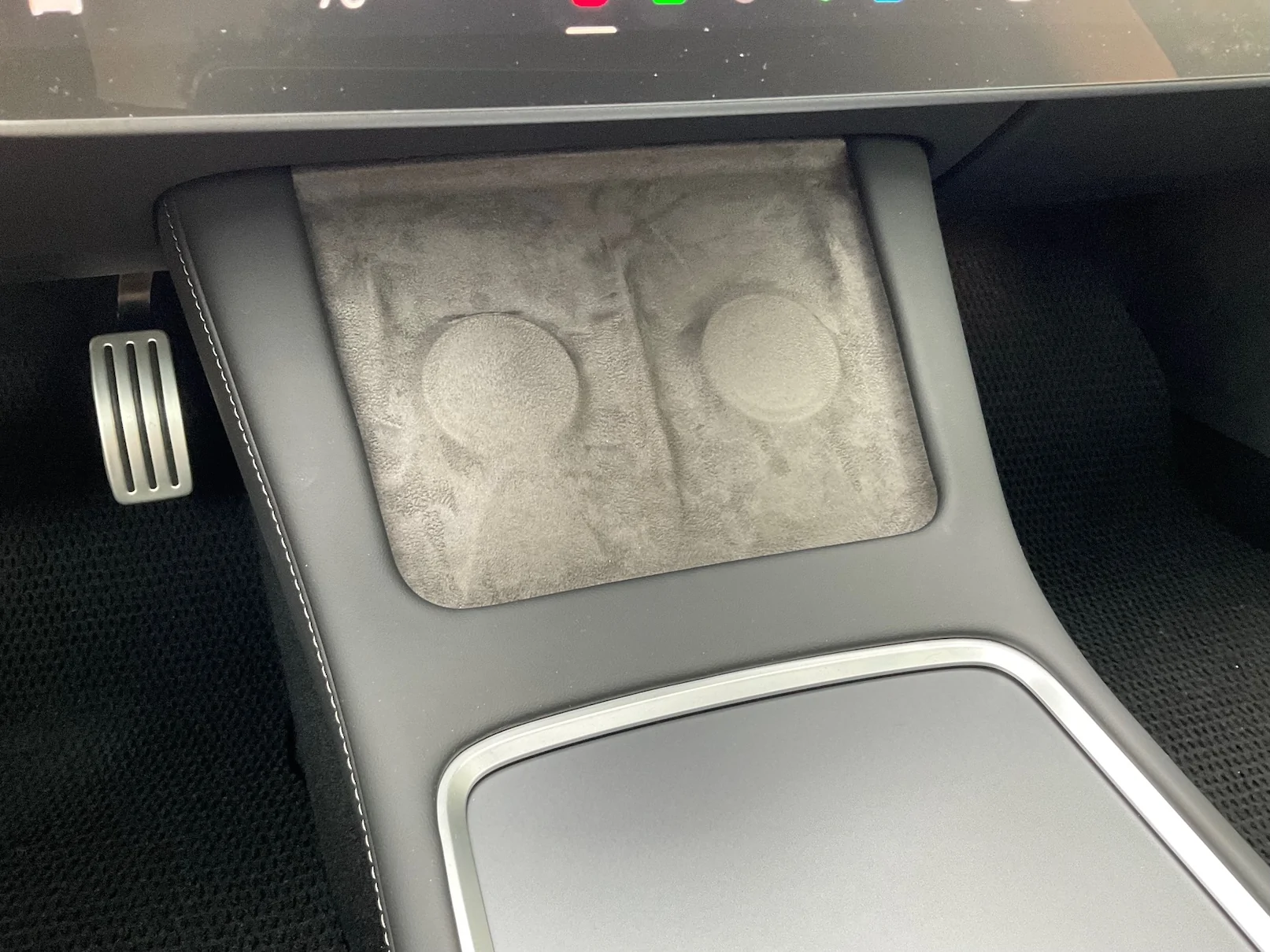

What we need is something similar to @Sandman1962 produced... as the root cause is the air gap between phone charing coils and (flat) Tesla Qi charging surface. As long as there is an air gap, the phone will eventually overheat. No amount of backplate revision from Tesla will fix this.
I have a lot of confidence in this approach, as I already 'fixed' it in both my 2024 Model S Plaid, and 2023 Model 3 Performance. I took slightly different approaches to each, but both use OEM/Apple MagSafe chargers, with 3D printed frames, which ensure clearance for the camera bumps, and of course magnetic alignment for the coils.
These are pictures of my own cars. Although I don't have extensive step-by-step write ups, I can certainly share more specifics, or guide you to threads I've participated in on other forums where we've tackled this problem. Just to level set, there's not genuine plug-and-play solution that looks close to OEM. You're going to need a moderate amount of trim disassembly and some 3D printing. The Model 3 (first picture) is a bit more rudimentary, the Model S arrangement has a more sophisticated 3D tray - I helped collaborate with the designer. Both work 100%!
I'm here to help!

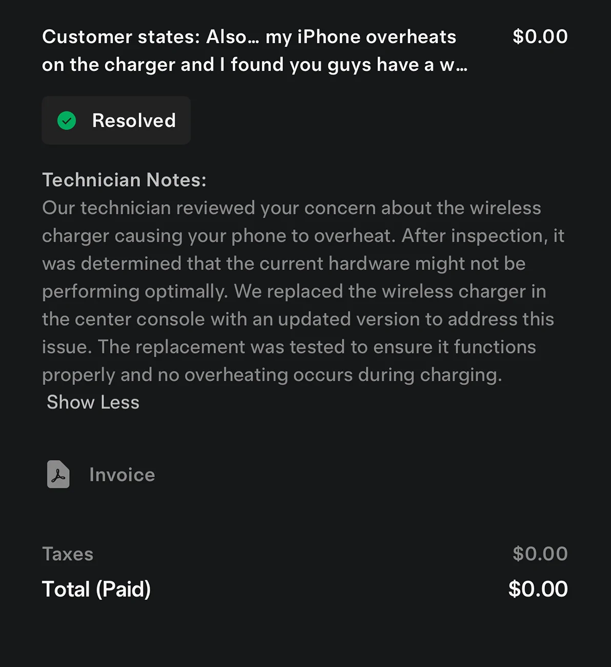

I finally had this done yesterday. I thought the charger was causing the iPhone to heat up and no, it’s the charger’s heat that caused the phone to get hot. I told Tesla about it when they scheduled me to get my extra tonneau cover slat added and they said they would do it too. Drove it home for a 3.5 hour drive and the phone never overheat. It certainly was warm, but not enough to cause the overheating.
Is it still on gen 5 for the part they used or is it a higher Gen now?

GEN 5.0(1877045-00-C)
What’s your VIN?
Mine 52xxx and was built in November 2024, so trying to decide if I should try to get mine replaced. It’s overheated my phone once or twice but hasn’t lately…I also rarely charge my iPhone on it for long periods of time.

11XXX… I’m an early owner.
