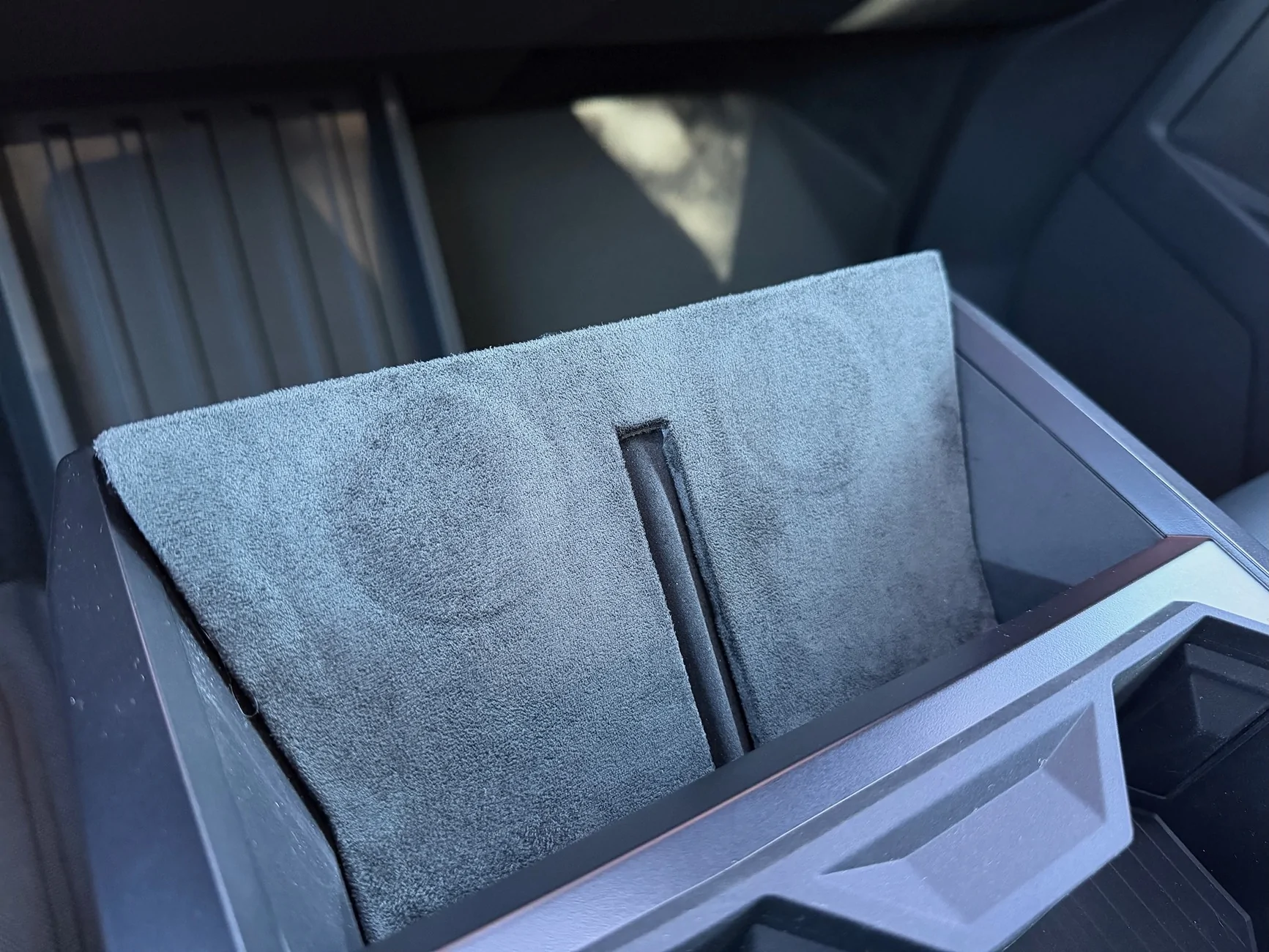

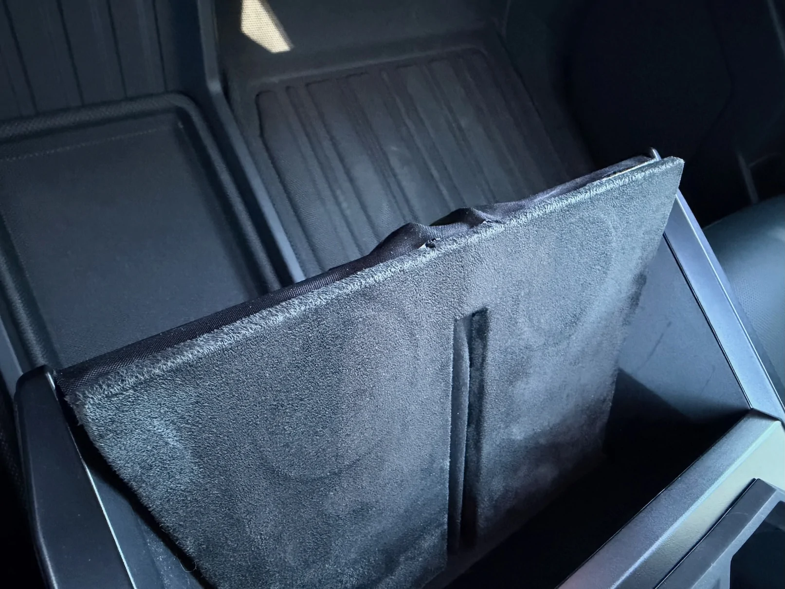

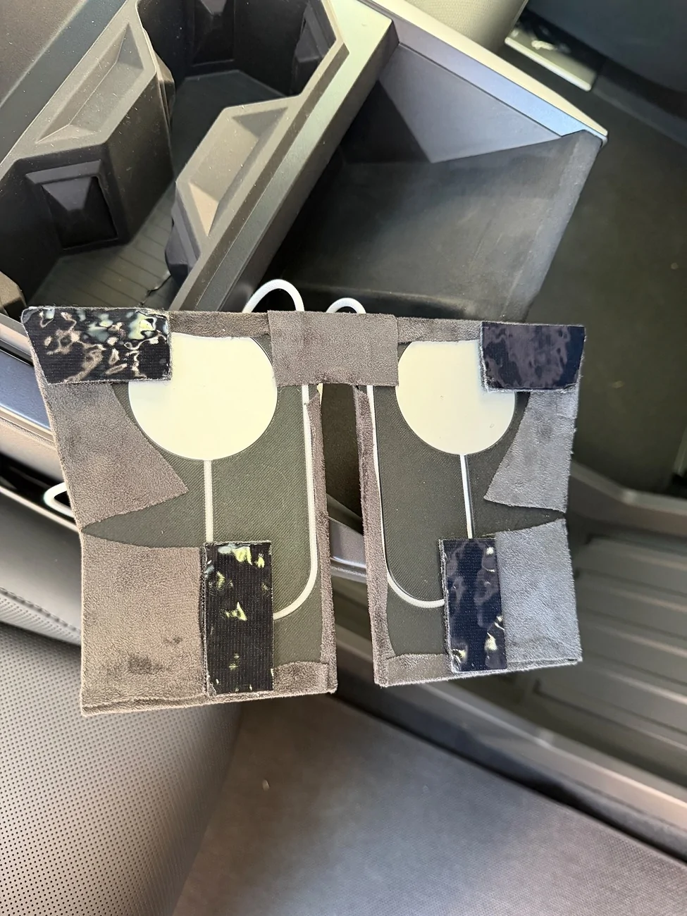

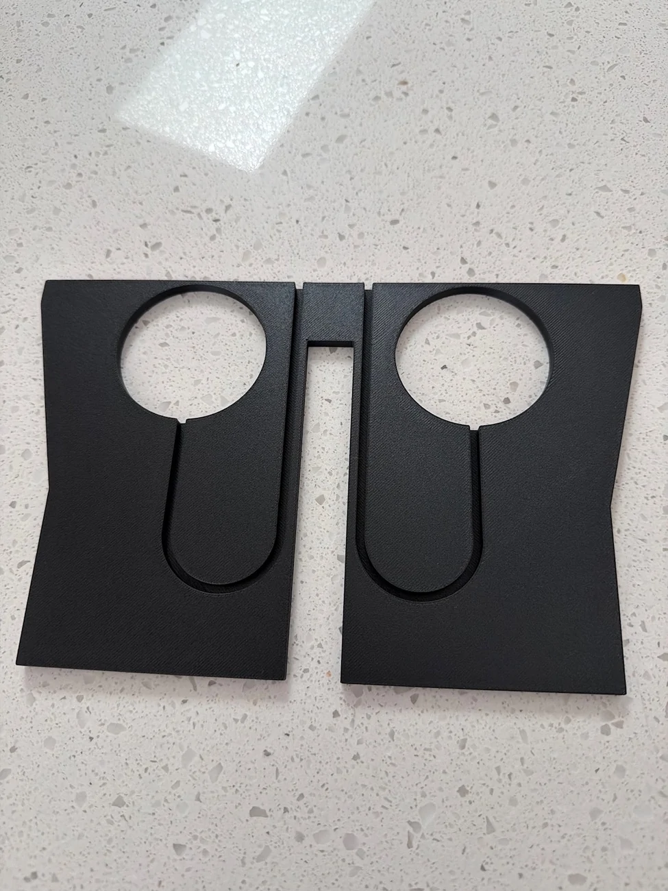

As such, I've been able to DIY a permanent solution that works 100% and can charge two iPhones at 25w each via MagSafe. Much thanks to @Sandman1962 for the 3D print file + design!
Steps:
  1. Print the STL file, I recommend using PETG-CF
  2. Get two of Apple's 2M 25w MagSafe chargers: MGDM4LL/A Model A3503 <-This is the newest Qi 2.2 version, and fits the file from Sandman
  3. Insert the MagSafes and wrap the front of the module with adhesive suede. I used this Dark Gray via Amazon: https://www.amazon.com/dp/B0F6L97BLJ?th=1

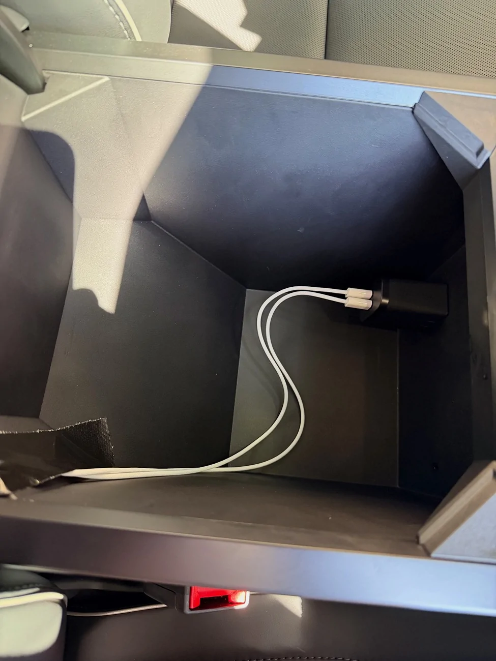

  4. Use a dual 30w 120V USB-C charger, to plug into the center console. You can use lower wattage, but this ensures iPhone 16 and newer will charge at 25w via MagSafe
  5. Use double-sided velcro to attach your newly-wrapped pad to the OEM tray. This way you can remove easily if necessary.
  6. Route the two USB-C cables from the top of the tray, around the passenger side of the center console. I used some strong black tape to secure it in various spots to the center console, then up into the rear of the armrest. If you do it right, the wires will be hidden by the passenger seat. You can use some black wire loom tape to tidy up any exposed surfaces or MagSafe wires coming from the top of the tray.
  7. Done! No more overheating, and the phones charge every time. The top of an iPhone camera bump rests just along the top of the 3D printed tray, and the MagSafe lines up.
  8. Also... the key card still works!

Looks like OEM solution! Wish one of the vendors or members make a kit for those of us that don’t have or know how to do the printing.
turns2stone
Dec 25, 2025
211
273
Dallas, TX
2026 Tesla Cybertruck Premium AWD, 2024 Tesla Model S Plaid, 2019 BMW i3S
Ya. I know there are some vendors with solutions, and I would have preferred to buy something 'off the shelf', but none of them:
  • Use OEM Apple MagSafe
  • Can deliver a full 25w to each device (you need to use the 120V outlet for such, can't split the truck's USB-C to deliver that much power.
  • Maintain key card functionality
So, DIY was the only choice.

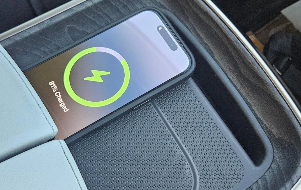

I finally replaced my ancient Galaxy S8+ for a Galaxy S26 last week and it charges quickly on Cybertruck's wireless charging pads, just like my 8 year old Samsung S8+ did. No excessive heat, just fast charging. Same with the wireless charging pads in my wife's 2024 Model 3 Performance on both of our Android phones.
Because the charging coils in the OEM pad don't line up to the coils in your Samsung. Sure, they are 'close enough' to begin a charging session. But a lot of heat is wasted due to (lack of) proximity.
And if you happen to not get them close enough initially, it just won't charge, at all.
Magnets + a better physical design (for the CT charging pad) to ensure there is no air gap due to the camera bump is the only true solution.
Finally OEMs are paying attention to this situation, and the Rivian R2 (and newest-build R1) is one of the first to properly design a wireless pad charger for modern smart phones.
Notice the 'lip' that allows for the camera bump to not interfere with a close fit for the coils.
https://www.rivianwave.com/news/3865/rivian-debuts-new-magsafe-phone-charger-on-latest-r1-builds
