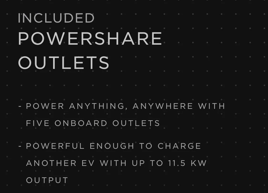

How do you charge another EV at 11.5 kW ?

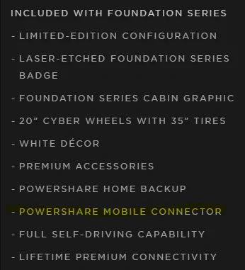

I believe that there is/will be another cord, that I think that I've seen in some videos, that's maybe a J-1772/NACS adapter. It's probably a smart NACS male to NACS male cord.
Probably the Powershare Mobile Connector that is included with Foundation Series.

PowerShare is 11.5kW, maybe someone just needs to make a NACS suicide cord lol
this.
the 11.5 is from the charge port.

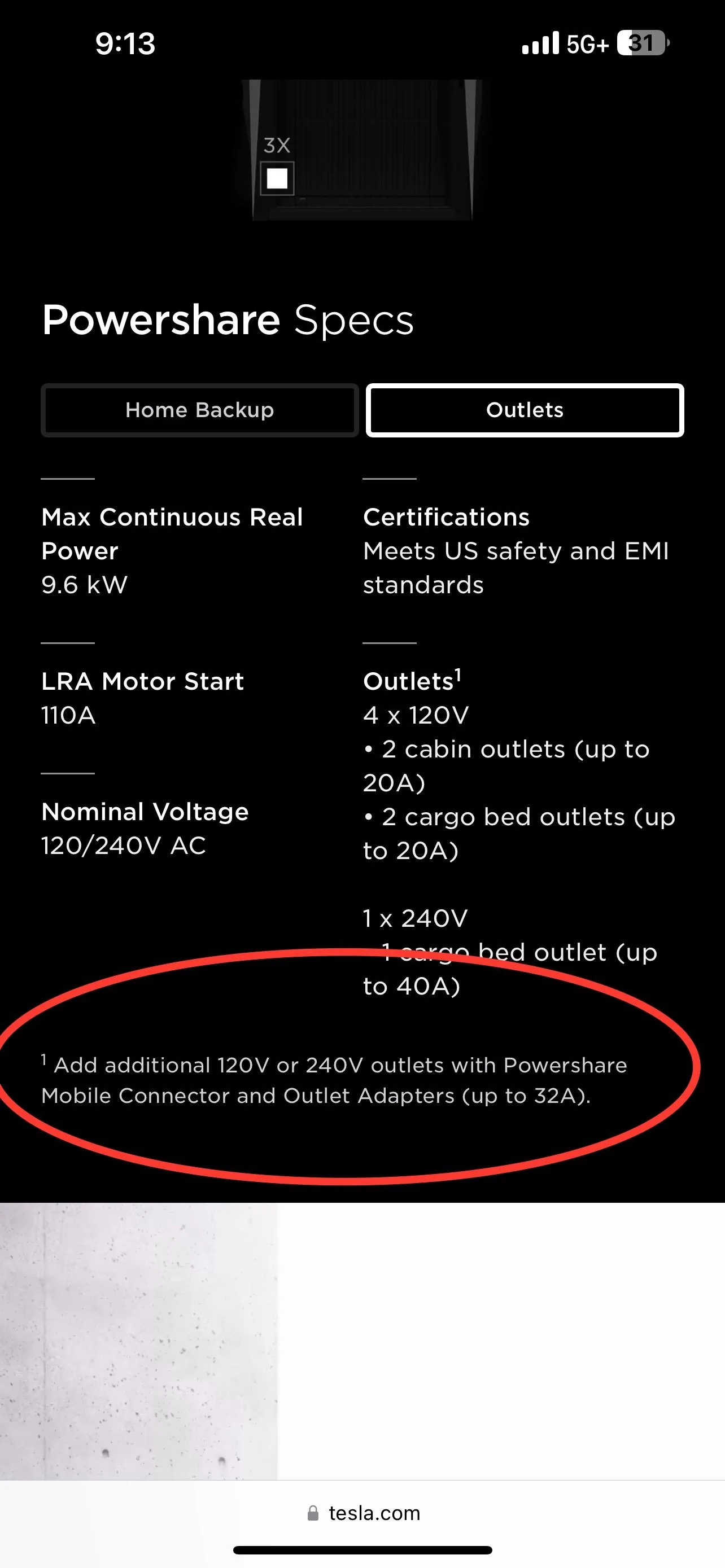

If it can V2V at 11+, it is going to come through the (as of yet unavailable?) “PowerShare Mobile Connector” at the NACS.
Tesla Cybertruck How do you charge another EV at 11.5 kW ? IMG_8302
But, Tesla is being a little cagey/quiet about this connector or its relationship to the V2V charging.

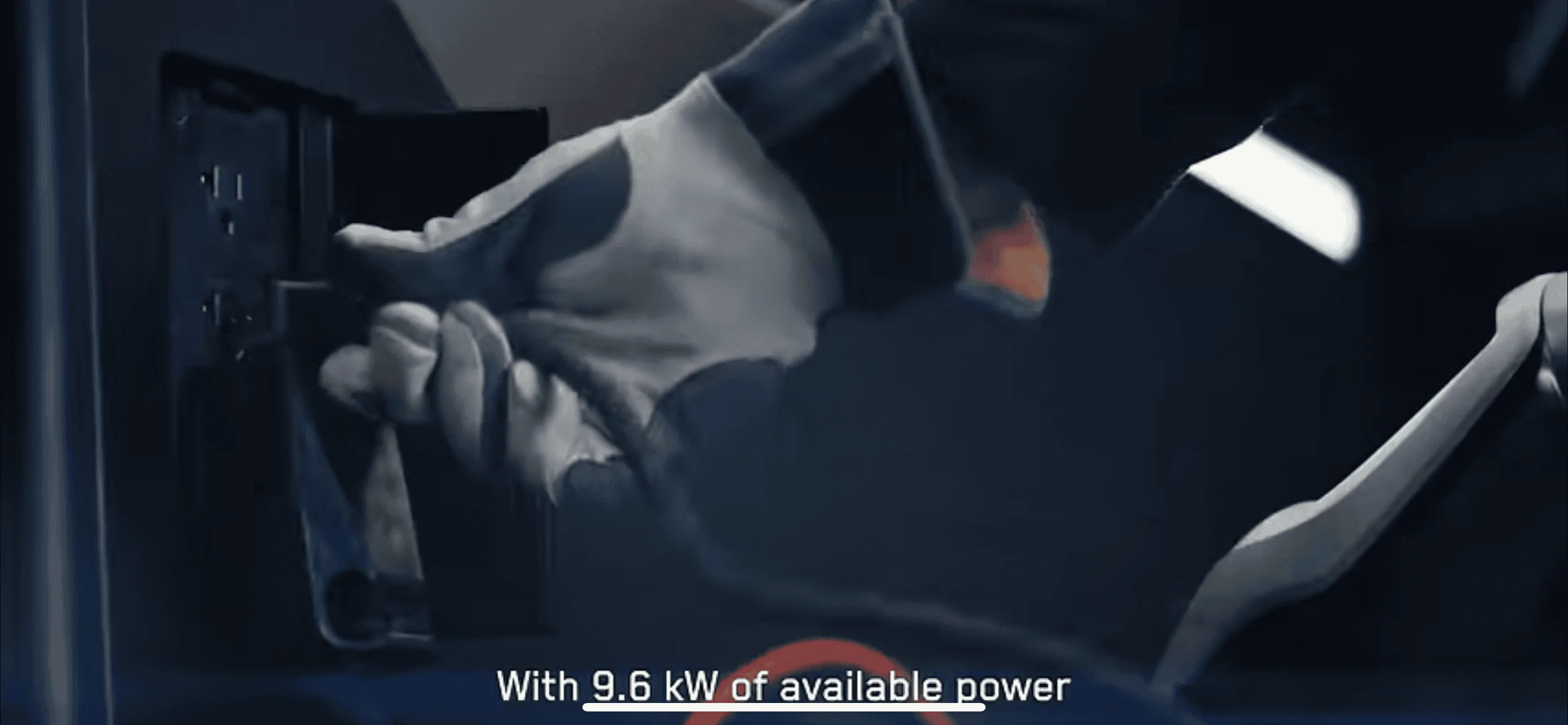

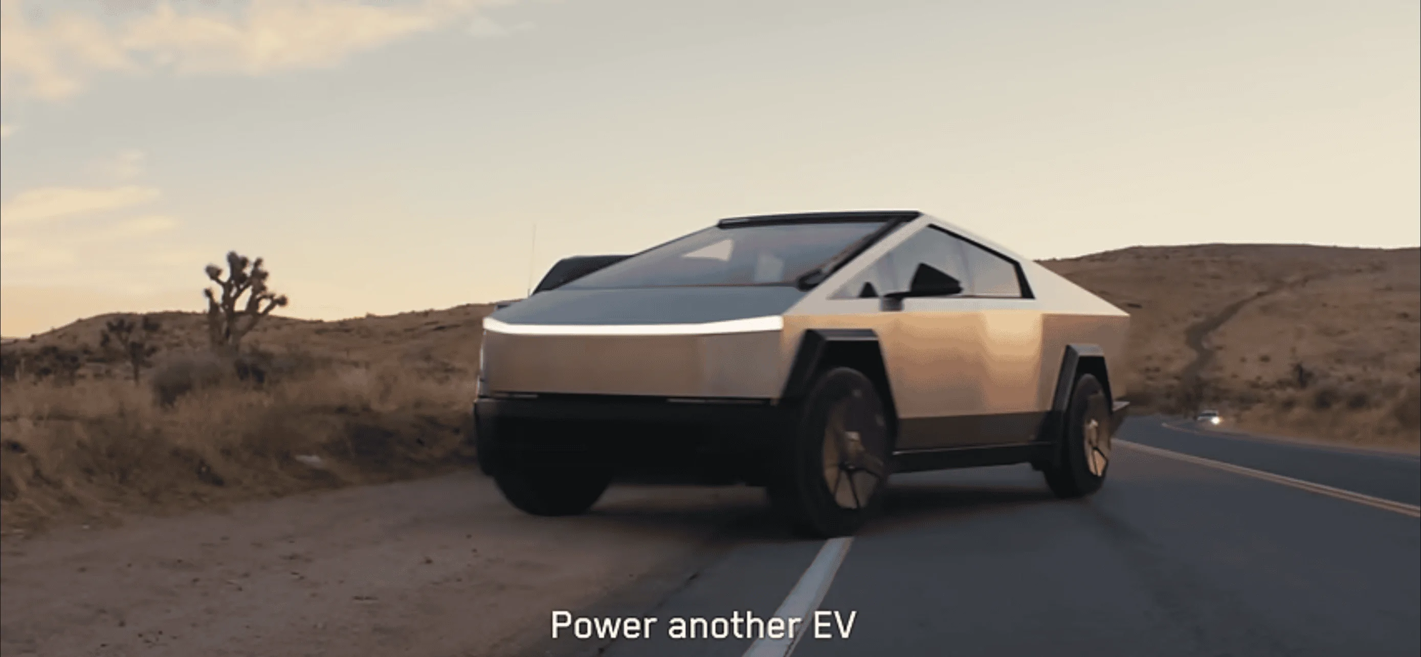

In the recent “power anything” video, they vignette powering other EVs but do not place any associate max charge rate with it during the video segment on the topic. Also, they show the Lightning plugging into the bed outlets, not a NACS-supported “PowerShare Mobile Connector”
Tesla Cybertruck How do you charge another EV at 11.5 kW ? IMG_8292
Tesla Cybertruck How do you charge another EV at 11.5 kW ? IMG_8290

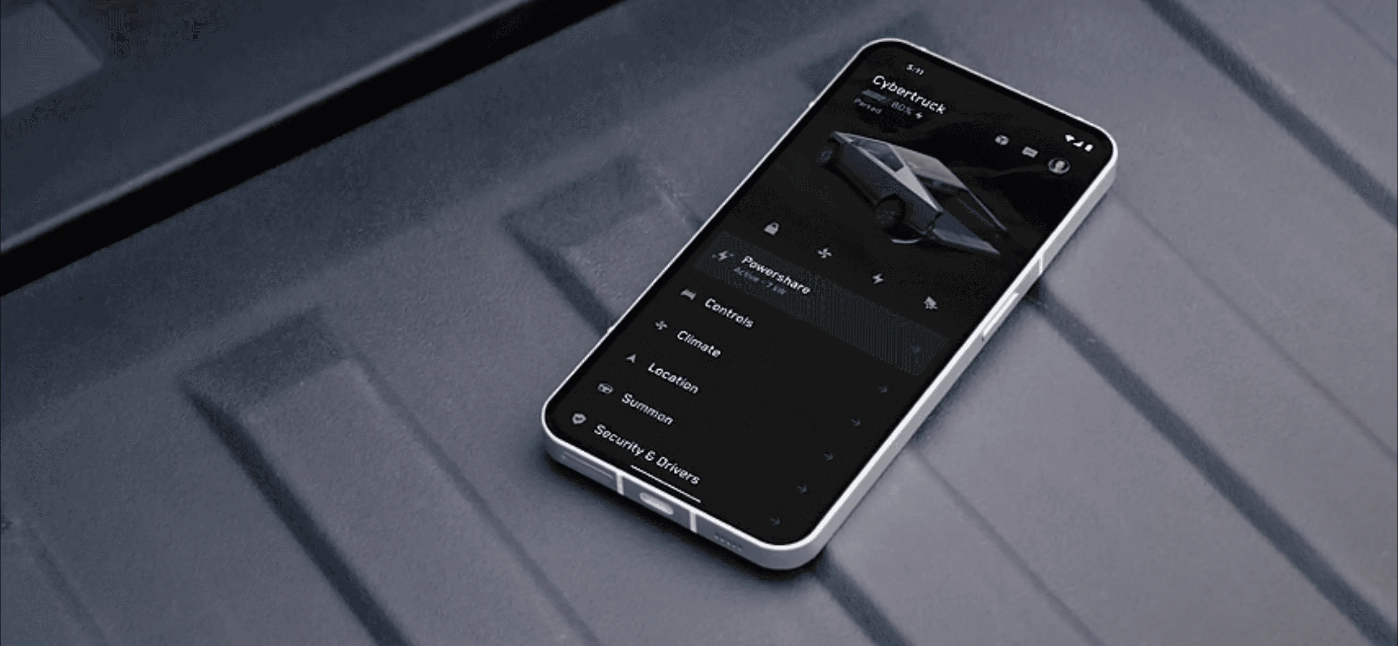

during this vignettes, they show the PowerShare screen while charging another EV, and it says the Lightning is drawing 7kWh - but that may be a fluke of the videography or the limit of the Lightning’s included 120/240-Volt (V) 30A Mobile Power Cord, which gives an an average of about 14 miles per charging hour on a 240V outlet.
Tesla Cybertruck How do you charge another EV at 11.5 kW ? IMG_8288
Still, in the same video, the very next vignette topic is about powering other things and there it clearly states the PowerShare stated limit in the bed.
Tesla Cybertruck How do you charge another EV at 11.5 kW ? IMG_8294
And elsewhere on the site, it also shows only charging V2V through the bed outlets:
Tesla Cybertruck How do you charge another EV at 11.5 kW ? IMG_8299

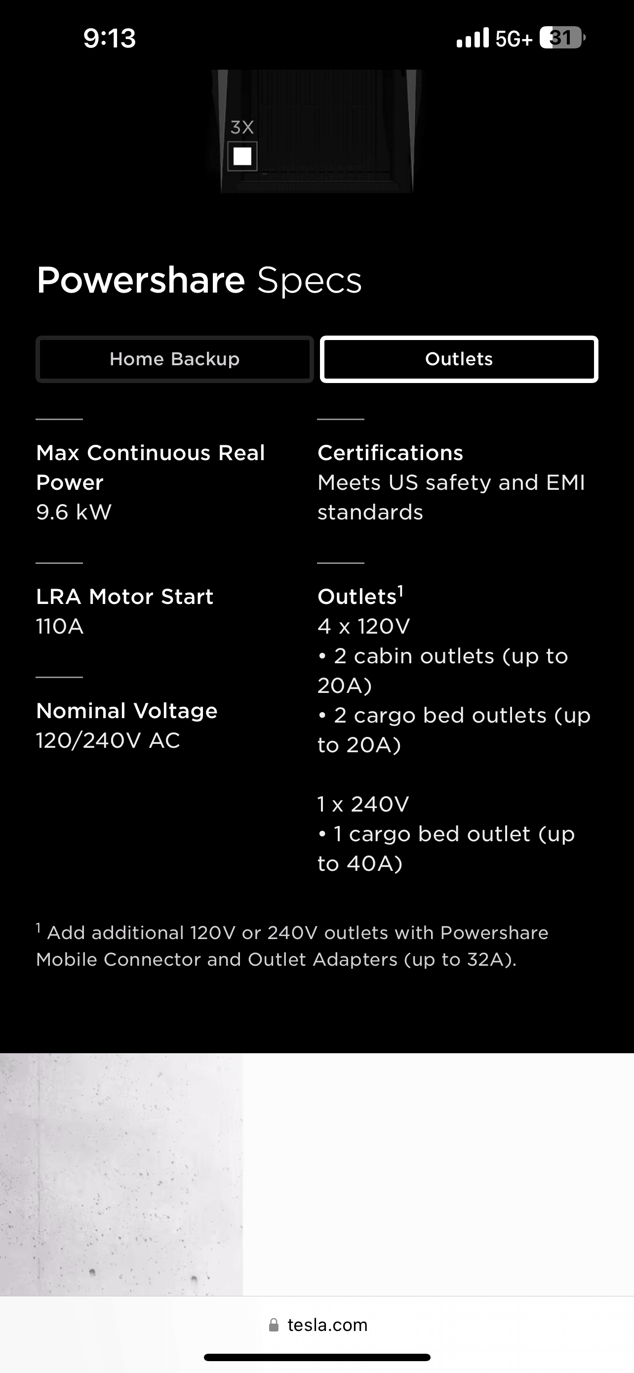

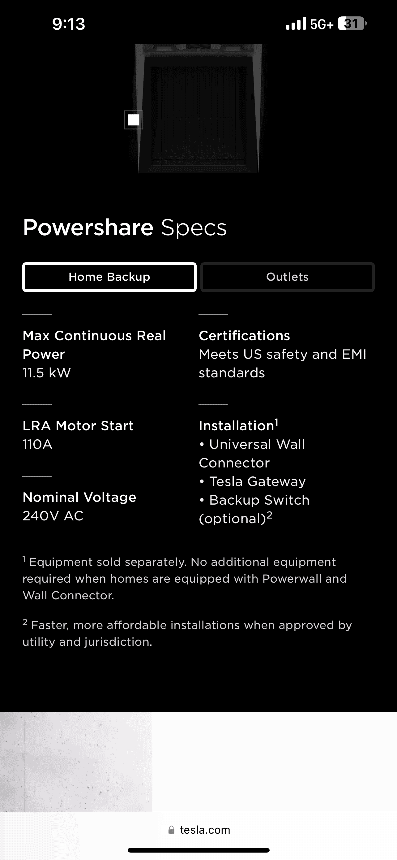

because with the Lightning, the 9.6 kWh value is the total power for all the outlets combined, but individually the outlets are limited: up to 2.4 kW available through the frunk and up to 7.2 kW through outlets in the cab and bed.
But with the 80A Ford Charge Station Pro and Ford Intelligent Backup Power, through the CCS, it works as a 9.6 kW power source for the house.
It seems the CT may be similarly arranged:
Tesla Cybertruck How do you charge another EV at 11.5 kW ? IMG_8295
That view is supported by the Tesla marketing materials on the site:
Tesla Cybertruck How do you charge another EV at 11.5 kW ? IMG_8301
So, if V2V charging is supported over the bed outlets to 11+KW, it appears it will only do so through this NACS supported “PowerShare Mobile Connector” which:
(A) we haven’t seen, and
(B) Tesla isn’t exactly putting foremost in its marketing materials
In fact, the marketing materials at present are pretty quiet on V2V charging through this other connector, showing only bed outlet charging which most definitely isn’t at 11+kW

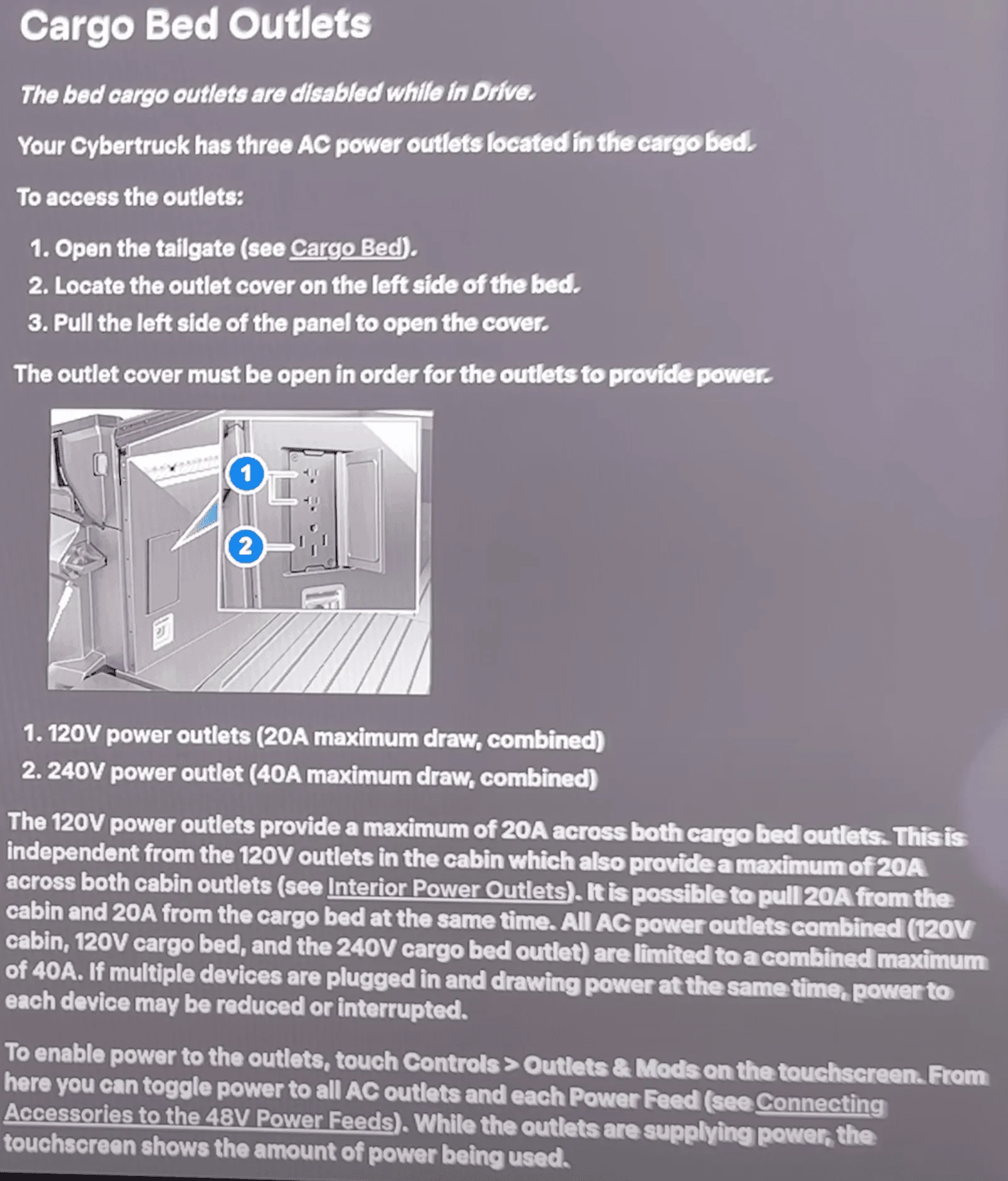

"The bed cargo outlets are disabled while in drive" - that sux, how am I supposed to charge my electric dirt bike or e-mountain bike? Maybe a future sw update, although im sure they did this for a reason.
This is expected to change. I think that the tweet is somewhere in this thread.
