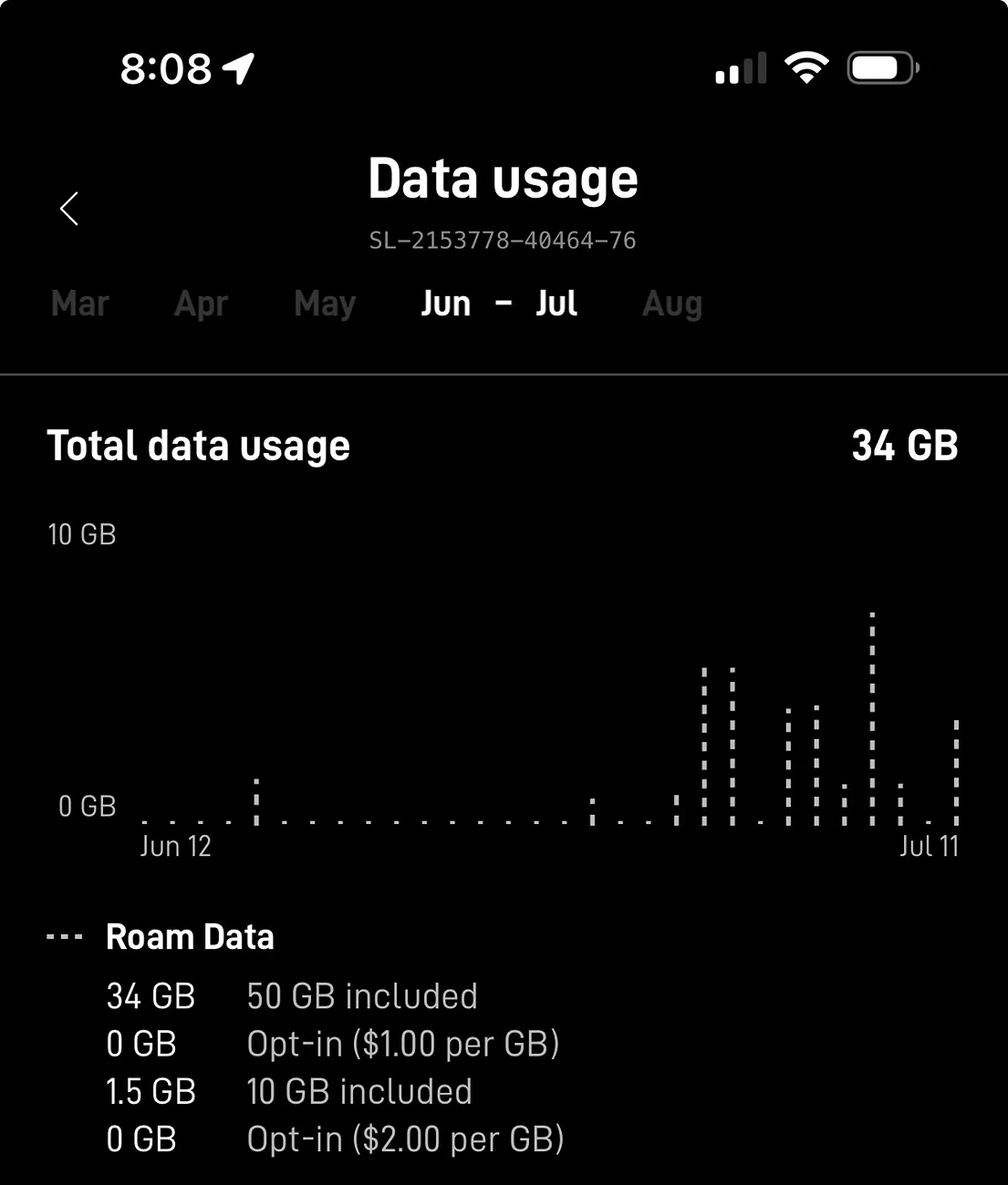

even in a power station I only see it pulling 24-28w. I’m running the Mini Roam 50GB plan. Only thing I can think of is cold weather may trigger snow melt mode.

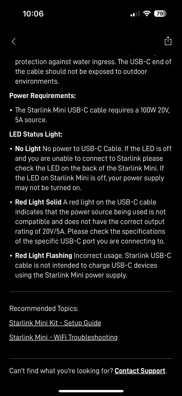

@mstatkus Are you powering Starlink Mini directly from Cybertruck USB-C? I'm unable to get Mini to boot up--OEM USB-C cable lights up red. My Cybertruck USB-C show 67 watts output.
I had the same problem and found this:
Tesla Cybertruck Starlink/antenna wires, how do you keep them safe? IMG_0347
The red light means it doesn’t have enough power. Mini requires 100W/20V/5A source. So either use the power source from the kit or buy a new USB-C power brick with more power.

I disabled "snow melt" on Mini, tried all three USB-C ports in Cybertruck (with nothing else plugged in) and measure output around 67 watts. Mini does require 100 watts but when running I see peak power demand 45 watts. I can run my Mini on either an external 60w or 100w USB-C PD. Starlink is on 2025.22.0. Looks like Cybertruck's USB-C might be the issue. Hmm....
