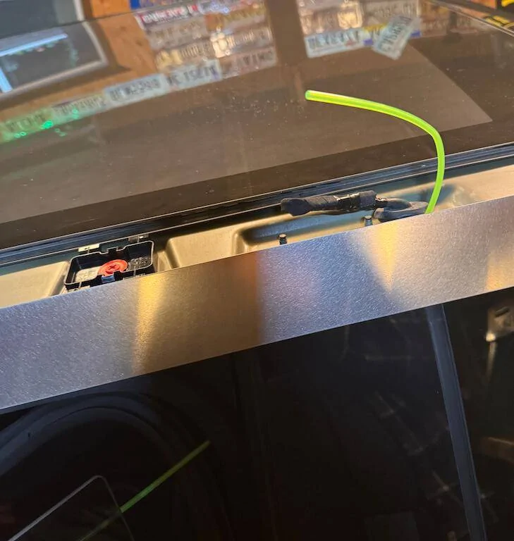

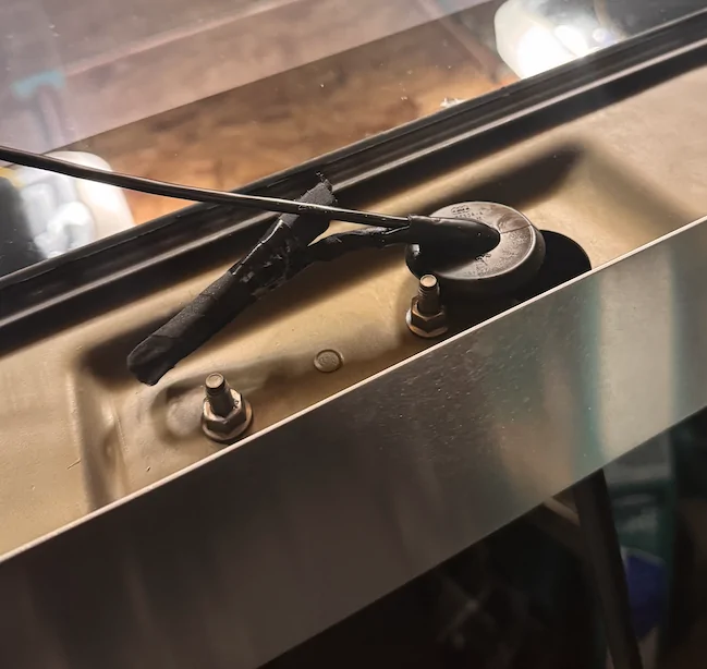

I ran wires up thru the headliner over the airbags and out the grommet where the 48V accessory is so I wasn't dealing with the weather stripping. (Hansshow rearview or potentially other stuff). That grommet maybe can handle one line though else you'd have to switch out to something else.
Access thru the B-pillar just by moving the rear passenger weather stropping back. Hope it helps anyone looking for a similar path.
