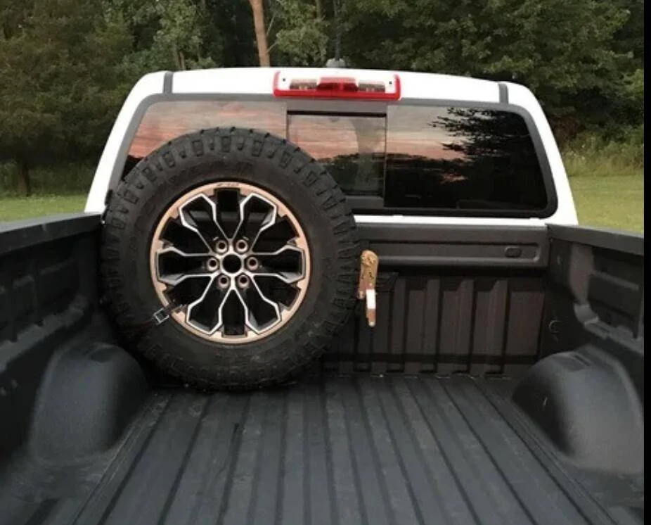

I'm at the point of ordering the spare. I need to use up my $2500 credit so I'm thinking of buying 2 cargo dividers. One would be used to hold the spare upright against the front of the vault behind the back window. Of course there will be additional strapping to the side L-track to hold it fast, like a strap netting or some kind of backup mount.
Has anyone seen examples of an upright install like I'm thinking?
I'm getting the molle panels also.
Example of what I'm thinking exampled by a standard pickup pic attached.
The disadvantage of this approach is not being able to close the tonneau cover.
Yes, I didn't measure before I posted and it should have been obvious I guess flat is the only way to stow the spare for tonneau to close.
