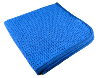

I cleaned mine once. I went very slow and step by step so I wouldn't break anything. I did carefully unplug things. Pro tip: I use a 50/50 mix of distilled water and 90% isopropyl AND i use a totally lint-free microfiber made for glass. These are usually waffle types. If you use the run of the mill yellow ones from Costco, you'll have very hard to remove yellow lint bits.

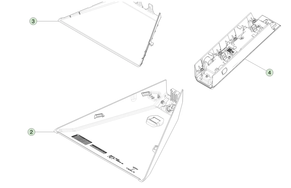

this plastic pin that slots into a hole on the beauty cover, prevents the cover from just falling down like i see here in this thread.
My early-2024 truck doesn't seem to have any such pin, but maybe I broke it off the first time lol.
The EPC doesn't really show a pin either:
Tesla Cybertruck How-to Clean Forward Camera View / Glare Shield (fix "camera visibility limited" issue) - DIY Screenshot 2025-12-22 at 2.59.13 PM
But it shows show that the "FRONT OVERHEAD CONSOLE ASSEMBLY(4)" has both an older and a revised part number:
1806612-00-H
1806612-00-I
so maybe it was a running change?
A replacement Overhead Console from Tesla is $105. I'm sure this is one of the cheaper mistakes you've made in life :LOL:
Agreed that the arrows in the procedure are misleading, you should click the "Send Procedure Feedback" on that page and perhaps they will improve it. If it's any consolation, the Glare Shield tabs are often damaged, even when handled correctly and carefully.
