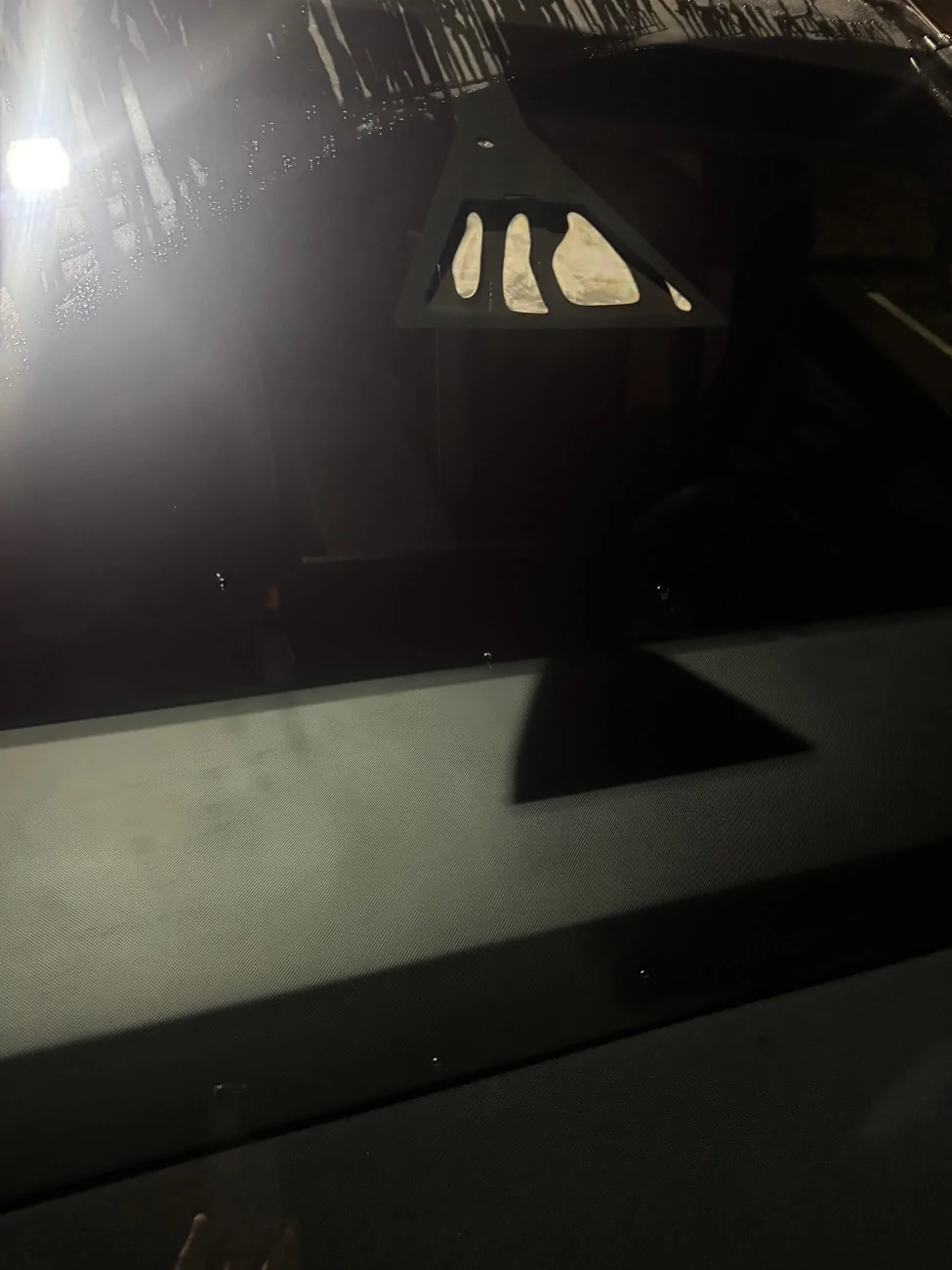

What’s the fix after Tesla cleaned mine? 15min defrost and 10min drive to work… 2 days in a row can’t use FSD with it being 30deg out.
Is that ice on the inside?

No just a ton of moisture. That is after total of 25min of max defrost.
Maybe leave AC on a bit after exiting vehicle? Something needs to be done to lower humidity…definitely have to kill the air recycling feature for it to work optimally.

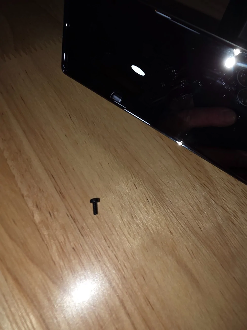

I had my camera cleaned recently at service center. I then started to hear a rattle. I got lucky it turned into a what sounded like bb rolling around the black beauty cover housing. Found this little black screw but couldn't find where it may have went. Any ideas? I'm hopeful service dropped it replaced it but couldn't find the original. Hopeful. Secondly, this is the first time I've taken review mirror down finally. That beauty box for me isn't the most snug. Is everyone else kinda not very snug?
mine is snug…..they may have broken some of the retaining plastic pins. Dont know about the screw.
Most likely just one of the loose screws that fell out of the service tech's head while he was in there...pretty common actually...
I thought that too. I know I would have dropped it three times before throwing it...lol. I'm hopeful he put one back in its place. Glad to not have noise from it rolling around now. I'll 3d print a cover to fit the rearview mirror hole.
There is only 1 screw requiring removal for the cleaning procedure, which secures the rearview mirror. Everything else is tabs/clips.
Best guess: they broke the glare shield tabs, and thus replaced it, but dropped a screw somewhere along the line. They replaced the missing screw, but now you've found it and have a souvenir.
