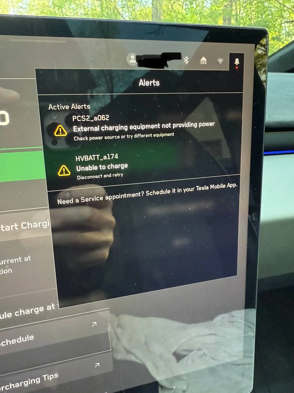

I have the same problem as you did. Both my universal wall connector, and the mobile connector will not work. I am scheduled to see the service center on 5/1/25.

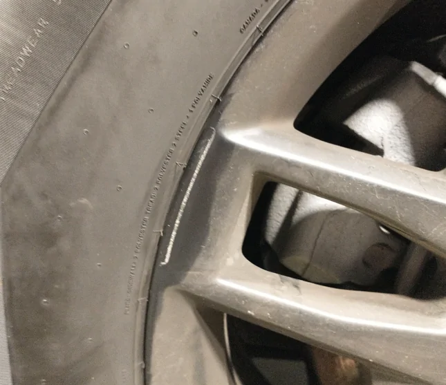

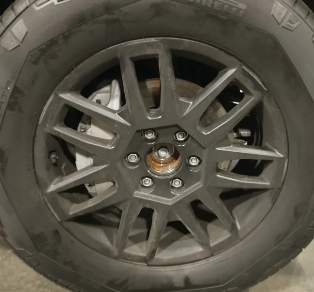

So, AC and DC used two different systems so it's probably the AC system. They took the truck they're going to do the wiper recall and a couple other recalls, give me my hubcaps and I got a model y as a loaner, at least I get to tryout ASS.
Hubcaps ok, wheel covers bad.
Would not use the wheel covers unless you really need the range.
They scratch the **** out of your wheels, and according to service center "yea they all do that"
