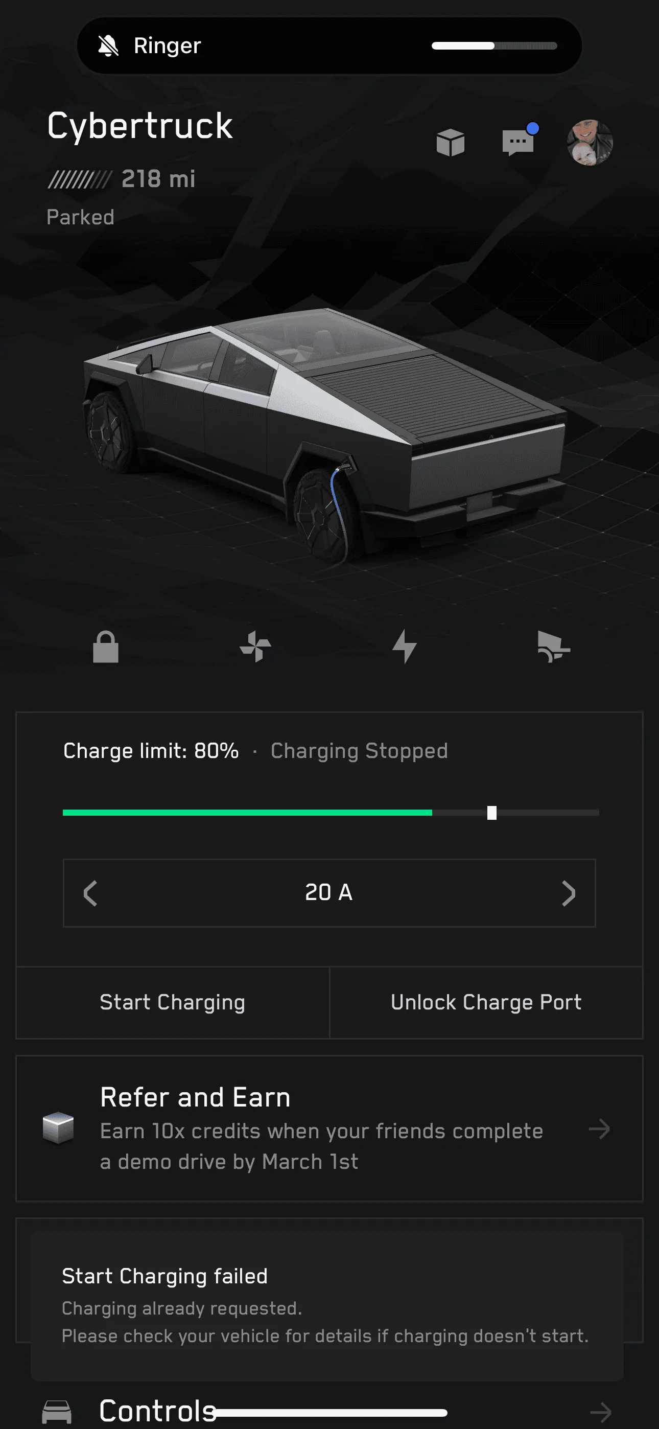

I also have a charging problem at home. As we're waiting for a level2 charging installation we must charge with the mobile connecter on 110 outlet in the garage. Problem is the mobile connecter fails to charge, goes to red after flashing blue. Tried different outlets on different circuits. Went to Tesla service and it works there. Tried at 2 different houses, same issue. So we're using the wall charger from our gen1 Chevy Volt. Taking the wall charger back to a service center this week.

Check to make sure that you don’t have scheduled charging set on the Charger side (not the car side)
Guylouis - dude! Thanks for your response on this thread w/ photos. I had to call Tesla yesterday for a powershare issue and something got borked (technical term there); on top of that - support was shut today. My truck simply would not charge with the universal charger, only the 120v generic charger.
Had no idea there could be a schedule set on the universal and sure as hell, something got toggled there post support call yesterday. Greatly appreciate you taking the time to post the above screenshots. Thanks a million.
