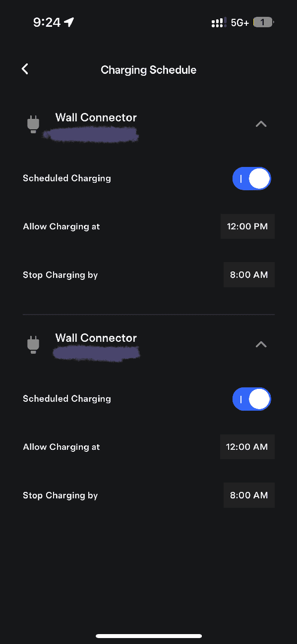

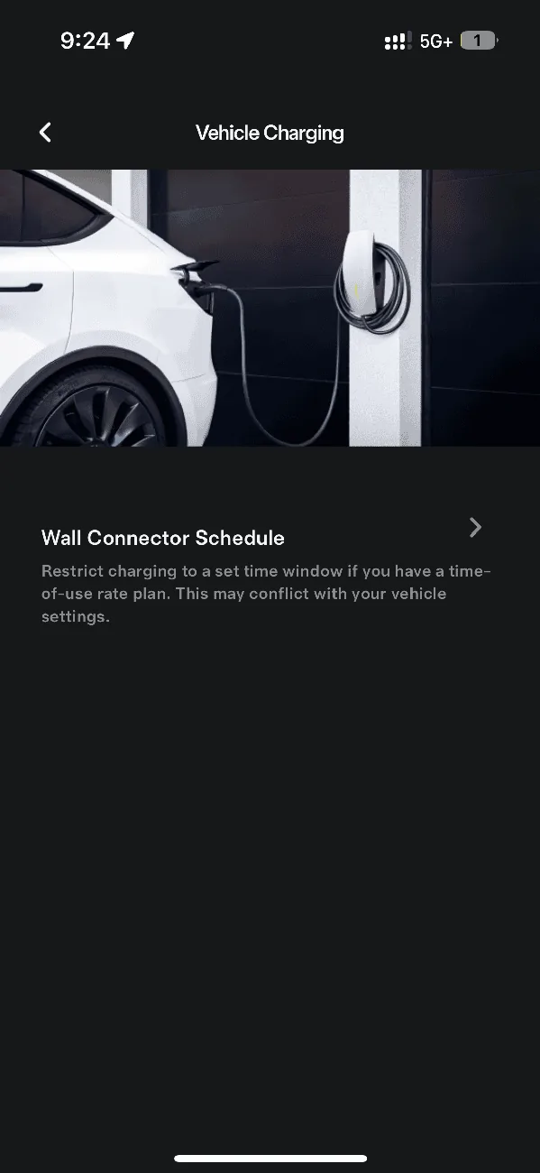

Check to make sure that you don’t have scheduled charging set on the Charger side (not the car side)
Via the app you can change this if you added you gen 3 wall connectors to the app.
If you select scheduled charging in the charger you can’t override it via the car

I wish it was that easy!
Tesla service has had the truck for a week now.

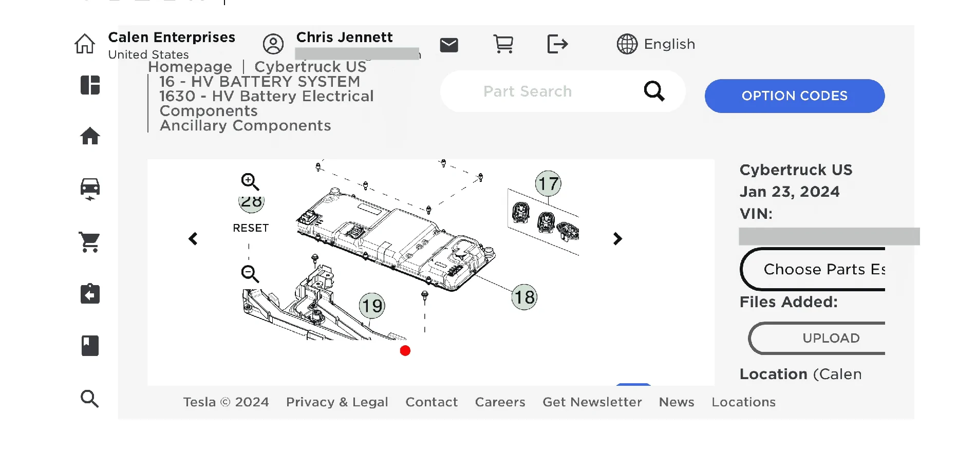

the believe it’s the PCS or Power Conversion System. Waiting on part to arrive.
part #18
Man that stinks being so soon. You never know about these modules. some come right from factory bad. I've changed a few power modules in my time and some just don't work right out of the box. Lately it seems there are more faulty electronic components than 20 years ago with a lot of different types of sensors, modules and all comms, electrical components. Being a fully electric, computer controlled vehicle i know there will always be issues. Just hope components get better. Maybe Tesla needs to start making 100 percent own equipment. quality control and a better product.
