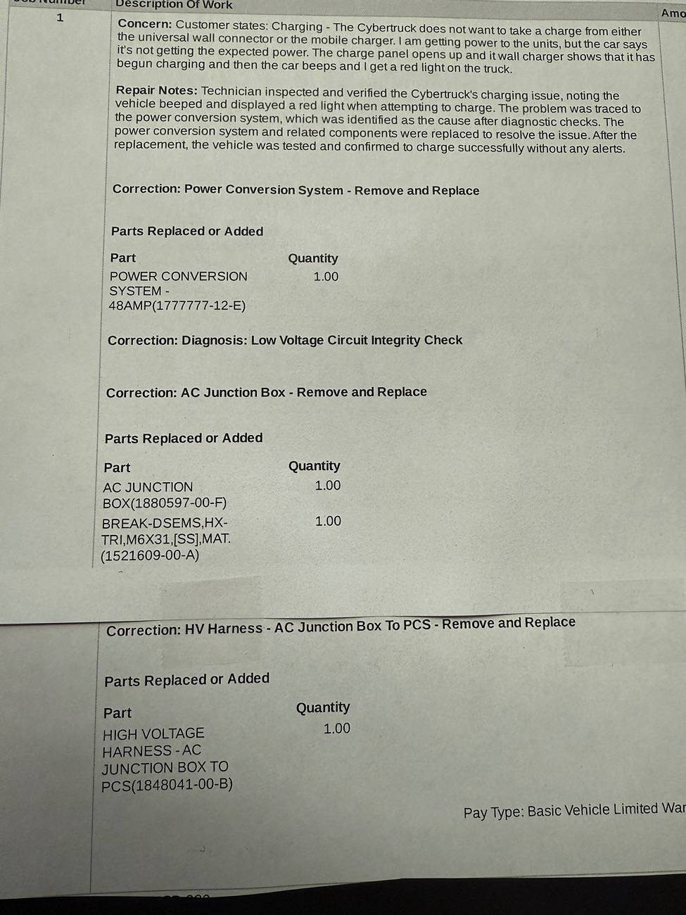

Well I got my unit back two days after dropping it off and it works. They replaced the Power Conversion System, but they still had an error and it would not charge. They ended up also replacing the AC junction box and High voltage harness which seemed to fix everything. It has been working since Friday night when I picked it up. I have attached the invoice showing everything even though it was covered under warranty. I have about 2,400 miles on the truck.
Tesla Cybertruck HV-BATT_a174 - Unable to charge Disconnect and retry IMG_0529

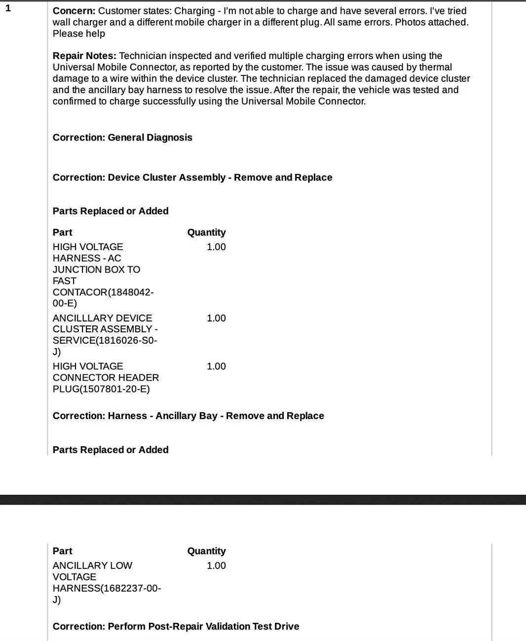

Yep, replaced HV harness/junction box, ancillary cluster/harness. Everything working well now.
Tesla Cybertruck HV-BATT_a174 - Unable to charge Disconnect and retry 1752094342160-i5
