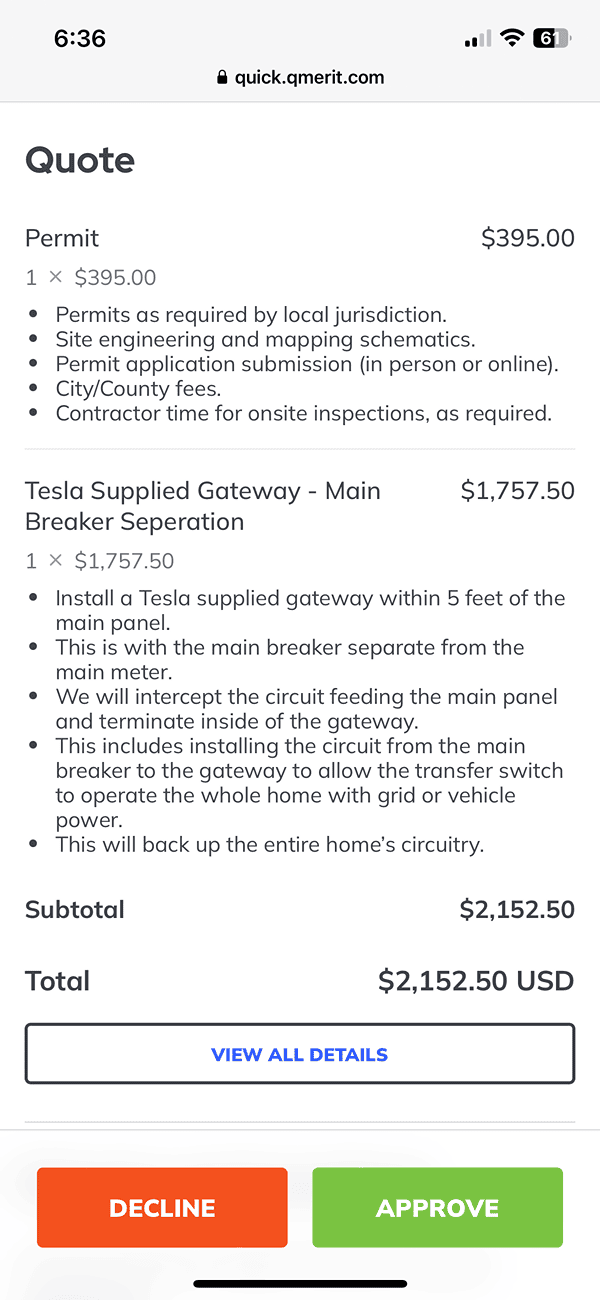

I have solar, power wall 2, 3rd gen wall charger and an old gateway. Qmerit just came by.
May 27, 2024
4,659
5,661
He also said if there is a problem he will swap out one of my gen 3 WC for the UWC. But he was still verifying that the Gen 3 will work or not. Guessing this was just something that would take 5 minutes to swap out he might have just added a buffer to the quote just in case?
As for the age of my WC one is about 3 years old and the other is 6 months old.

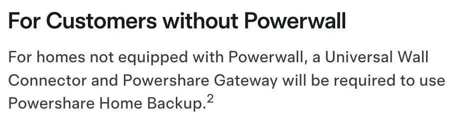

Ah gotcha. Since the UWC is included in your $2,500 credit, they really should give it to you (unless they are knocking down the installation price by the wholesale value).

No I have about a 40 foot run from the gateway (where they plan to install it) to where it’s located on my garage. But there was a snake line run for 2 more wire pulls to where the original insulation went. He was thinking ahead because when they were originally doing the installation ran, I was going to have each WC on its own 60 amp circuit.
Instead of running a whole new line he suggested a sub-panel and the wireless charging. However I wasn’t really sure that would work so to save on time he threw in 2 extra snakes to pull wire if the wireless load share didn’t work.
