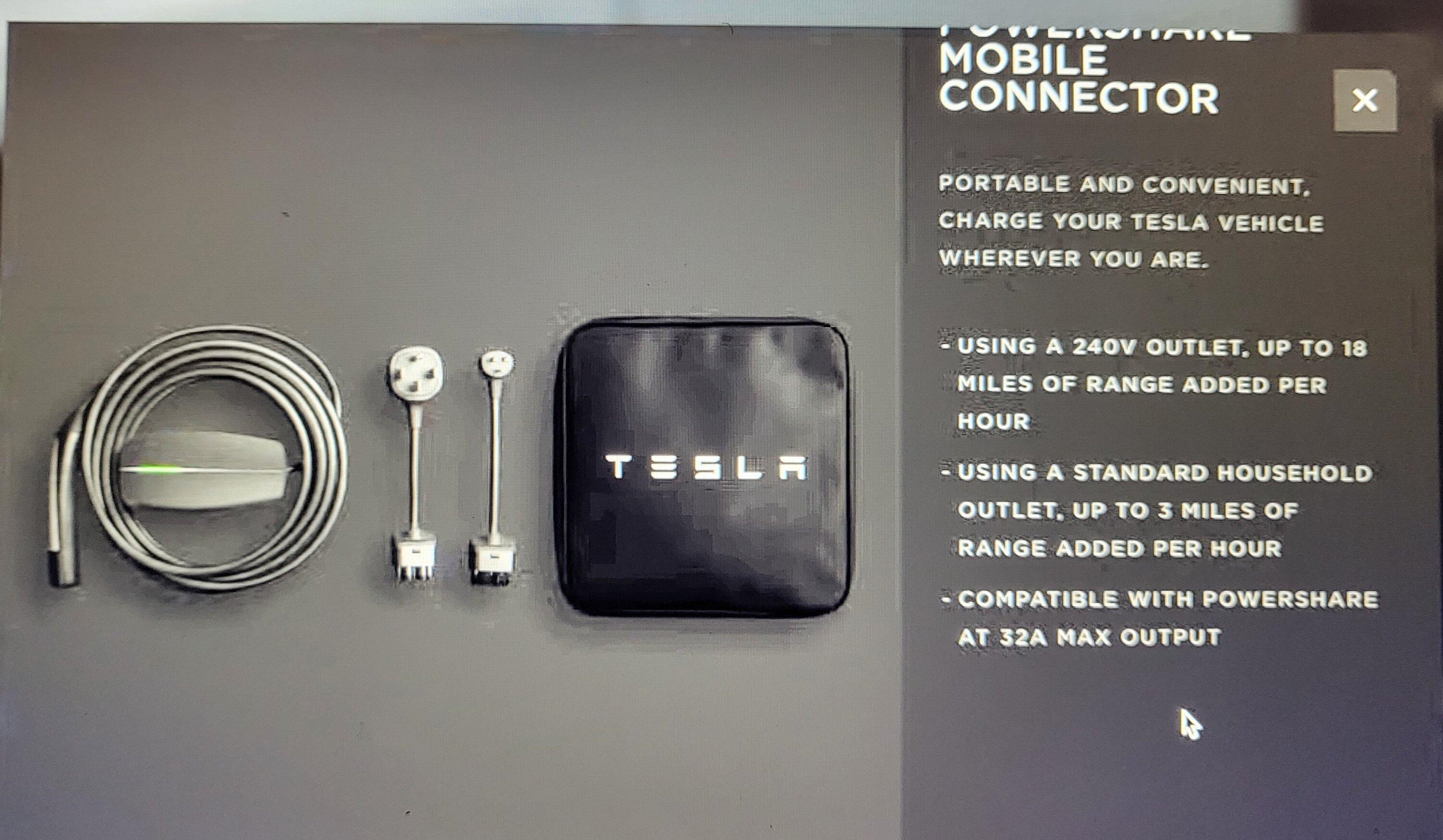

It does. Not sure standard. You got photo right?

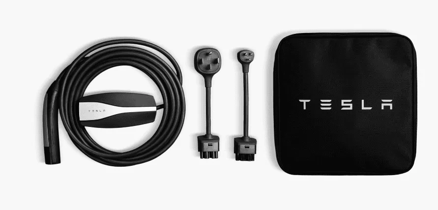

You mean the picture that looks like this?
Tesla Cybertruck Install Home Charger Before Delivery? 1708298360097
Mobile Connector (tesla.com)
This CAN NOT support bi-directional.
The ONLY thing that your picture says is that it is "compatible with PowerShare at 32A max output" Which means plugs into the NEMA 14-50 outlet in the bed. But so does the Mobile Connector.
Yes that picture of the equipment my neighbor has and he used it to charge his other tesla. And so did Sean on you tube and so did So many others. I saw it for my own eyes. It's the only plug tesla gives you to charge another car. Only one. No other. Jesus man.
