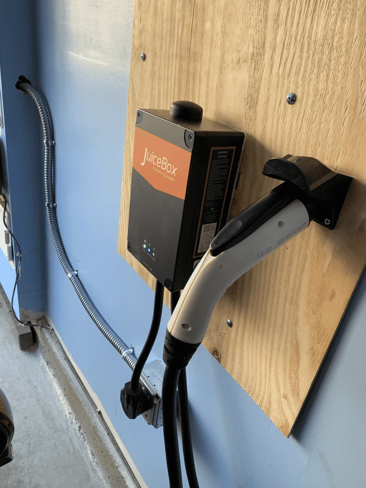

I had my wall charger installed on 19 January. So far I really like it. It is hooked up to a 40 amp circuit. I will have an additional wall charger installed on the other side of my garage after I take delivery of the Cyber Truck.

I bet you the WIFI feature is to enable you to monitor and control the charge times on your vehicle. In addition to being very cool looking I bet you it will be very reliable. I recently had a Jukebox installed to charge my current PHEV; it also has a WIFI connection. So far, I have been very happy with it but, it thinks it is located in the wrong time zone. For some reason, it shows all times in PST and not EST. I may have to redo the setup procedures more slowly and look for the configuration option associated with time zones.
