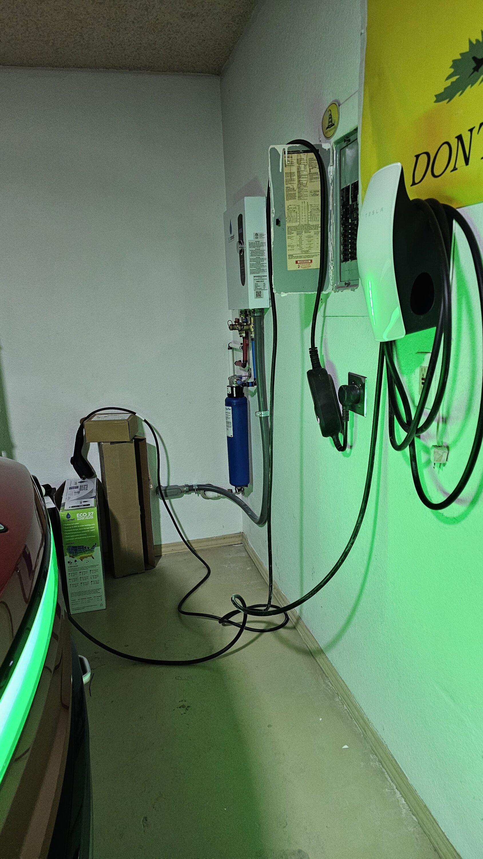

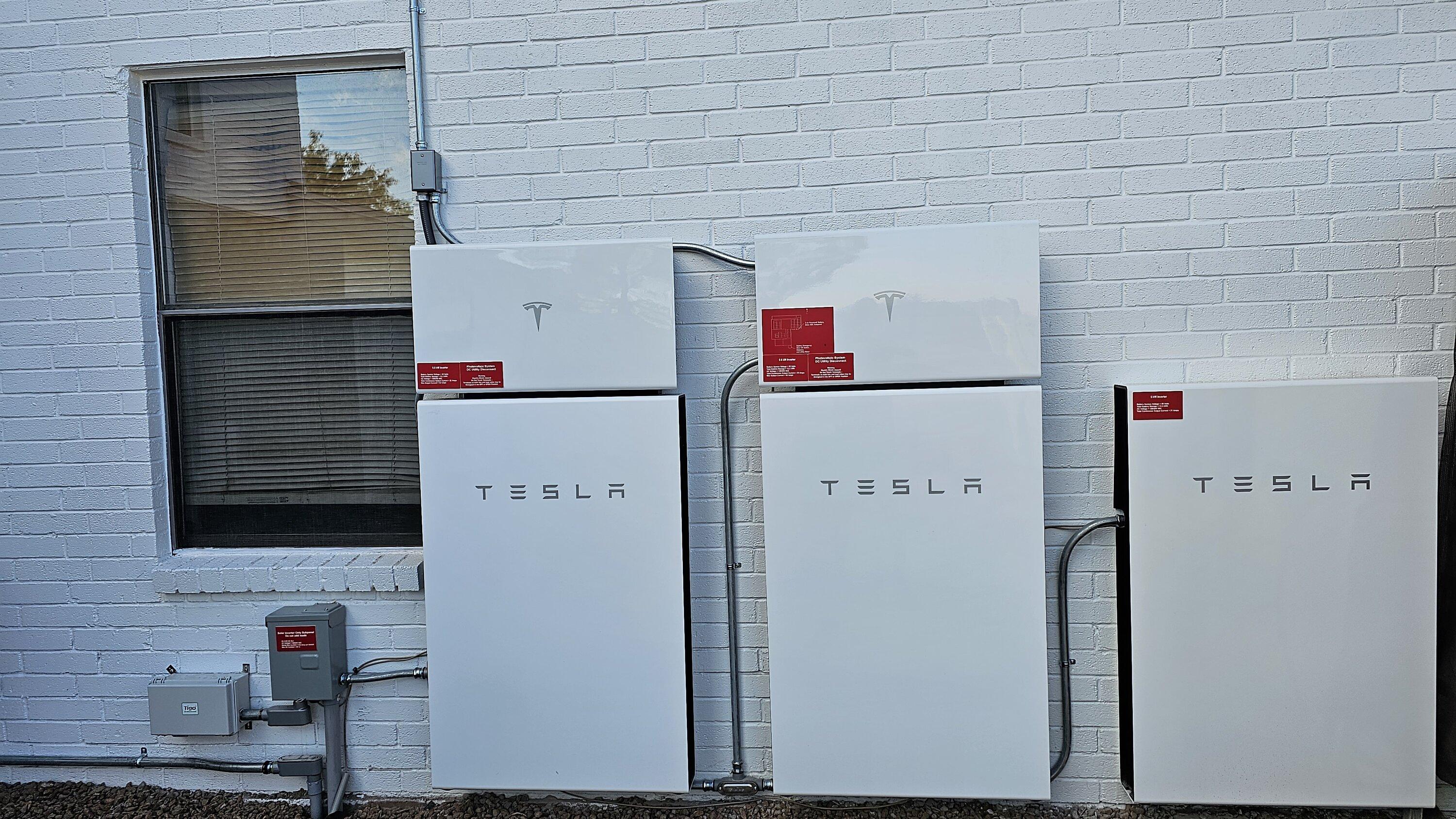

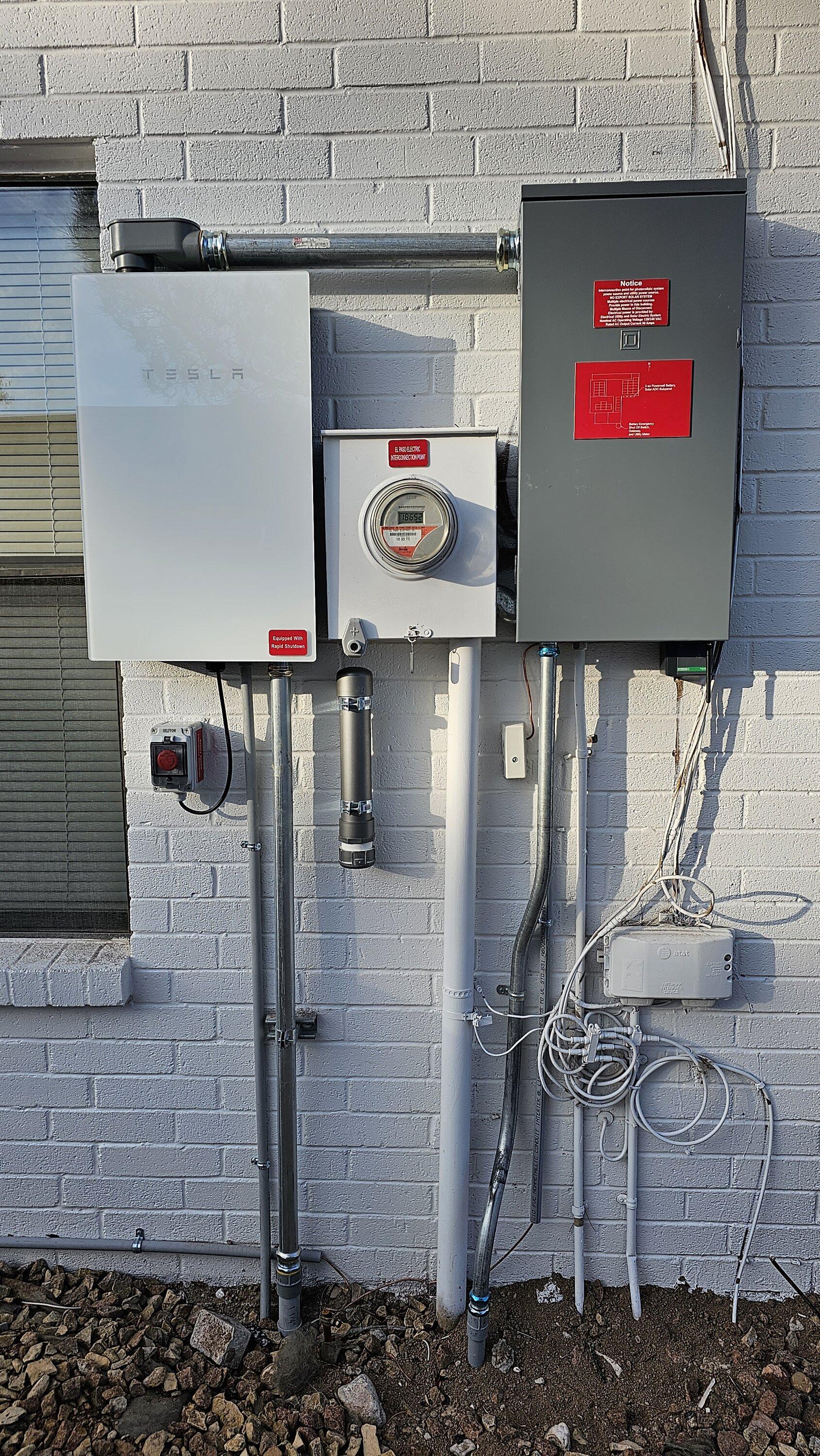

I have an authorized Tesla installer installed my solar sytem, 3 PoweWalls, a Tesla Gateway, a Tesla Universal connector and a 2nd 60amp, 240V outlet a few months ago and it took four afternoons to do so. You don't need to have the equipment to plan your installation. They prefer to install it near your circuit panel and can be up to a 60amp breaker for fastest L2 charging. They prefer that you have WiFi for easier commissioning of the device but it's not required. I plan on having Tesla install the PowerShare and the other Universal Wall Connector (already qualified per 2nd email from Tesla) in my soon to be build 2nd garage where my Cyberbeast will be parked. By year's end, I should have 2 additional Powerwalls installed. At that time, I should have 5 EVs so having all these batteries, chargers and outlet helps.
