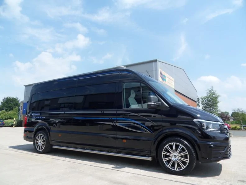

My van which is a VW Crafter like the above has the same Cd value (0.33) as a CT, but can load 14cbm (494cuft) load volume, the CT is just 1.9cbm (67cuft) in comparison, on similar but 3ft longer footprint. This is a large version of this van but is essentially a box trailer volume included in the vehicle envelope itself, with no trailer required. Different size vans are achieved with the same platform, simply by changing roof height and vehicle lengths, so that you could have any size you need down to a family sized van or SUV that also fits in a undercover garage.
The frontal area is obviously also larger depending on the version which will contribute to drag, as can also the length, but skin friction is negligible at highway speeds, and I can still reverse park this in a normal car parking lot, which is obviously impossible with ANY form of trailer behind ANY EV.
Obviously, drive thru's and parking garages are not an option with the high roof version, but if you need space to haul tools or gear, or have a RV, there is nothing better to keep that EV kWh consumption in check. A low roof and the shorter wheel base option could still fit anywhere a CT does or even a MY, but have significantly more utility and useful volume, all without the EV range aero implications from towing a trailer.

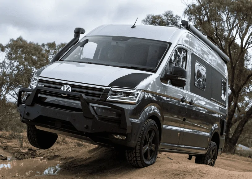

The other benefit is that it's not speed limited to trailer towing speeds, neither less safe because of the trailer, and doesn't have to contend with the limitations of towing a trailer for driving around in town, or off-road etc with a 4x4 version. There are ways to make van formats just as capable off-road, if not more so. Large off-road wheels are a compromise that reduces range on EV's, so it's best to keep both the wheel sizes in check, and keep the tyre options as broad as possible to cover every possible use case.

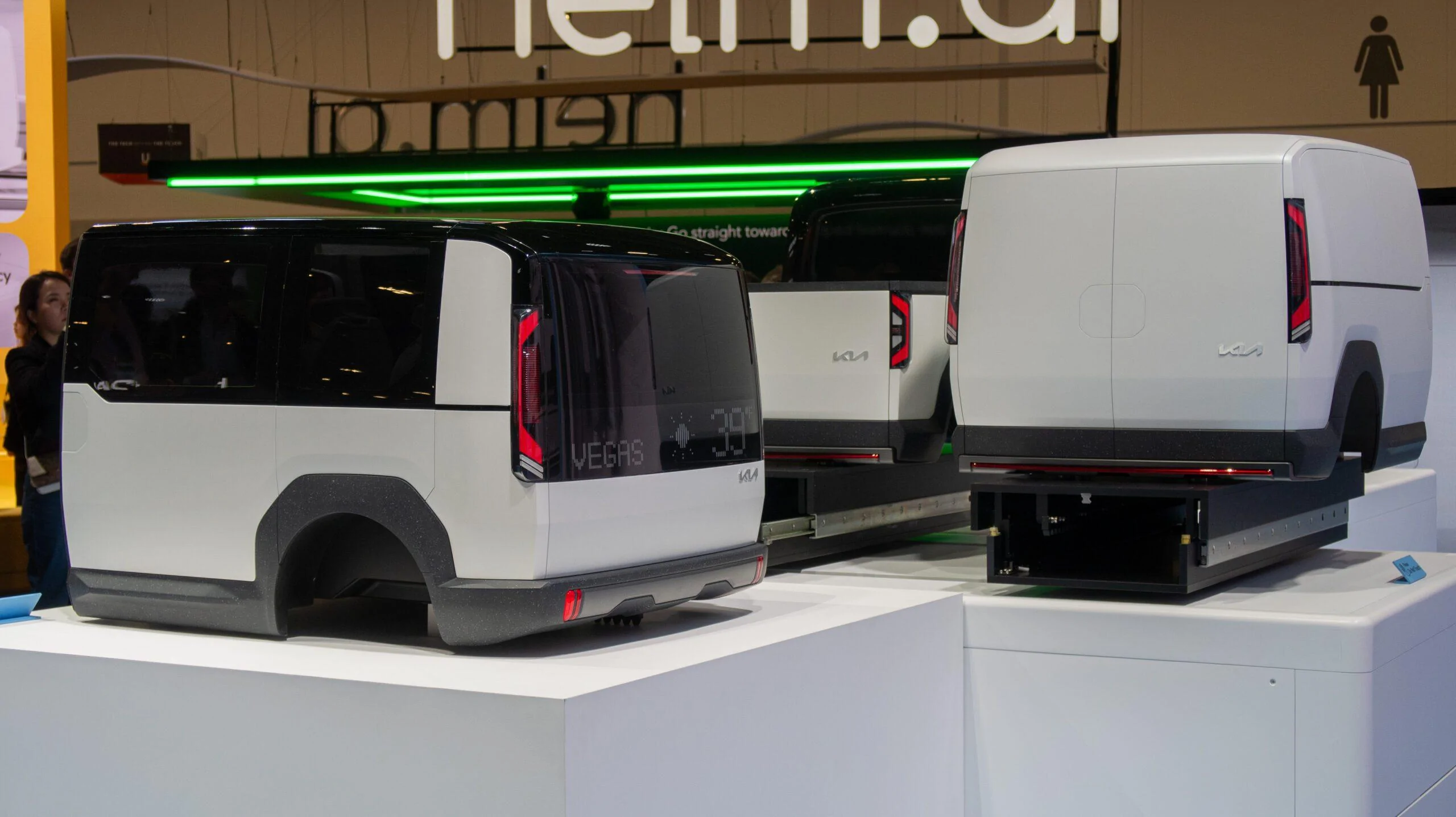

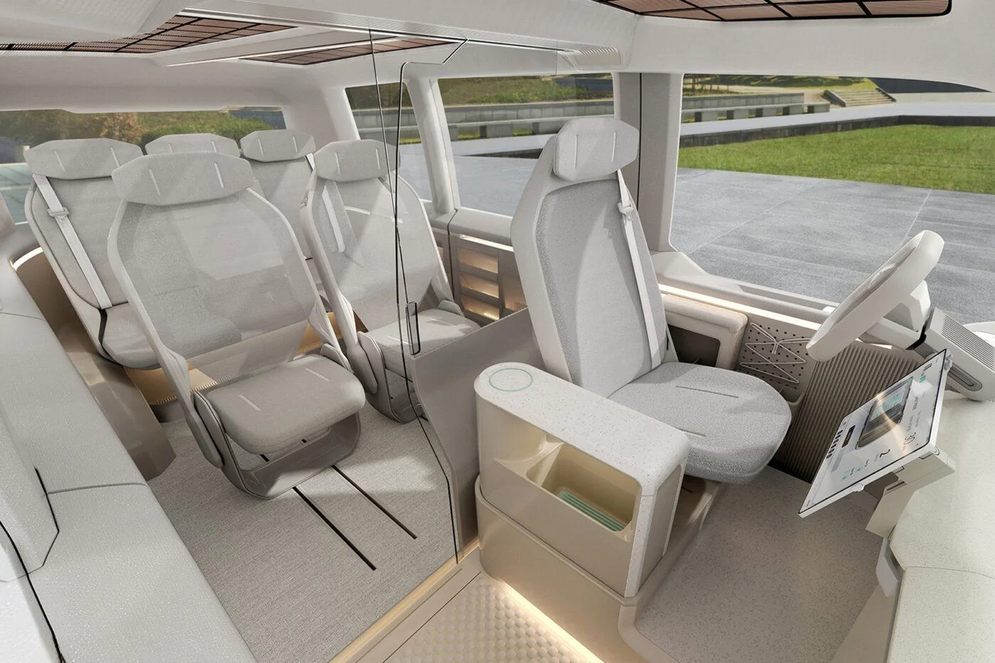

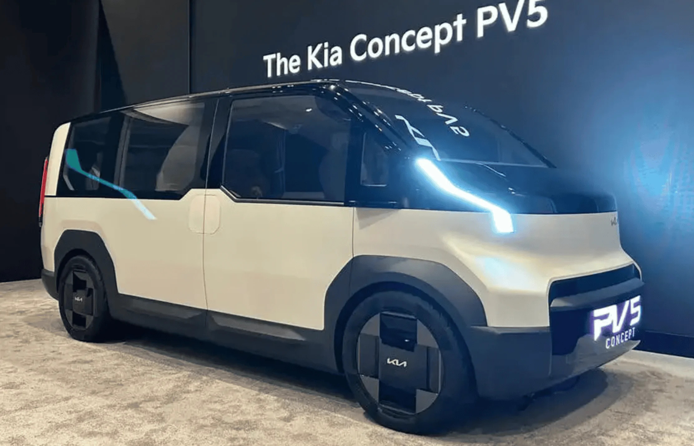

Interestingly, in the last CES Kia also announced a range of EV Vans that basically provides the ability for the same skateboard platform to be configured for various size vans and body shapes, not only in production, but also after you have bought it and have it in your garage. I think this form of "modularity" is really key in this space, in that it is really unnecessary, and expensive, to own and operate multiple vehicles for various tasks. Whereas it's fairly easy to change different bodies for tasks as they arise instead.

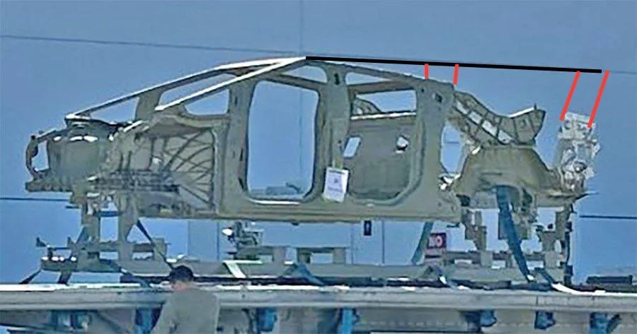

As you well know, I’m big on a good BEV van
The question here is what size van would capture the most amount of market in the EV space
I’d modify this question, to instead:
given Tesla’s strong lean towards minimizing vehicle variation, what existing Tesla is the best platform for getting to a van platform
The answer is pretty obvious, and I think exactly the plan at Tesla

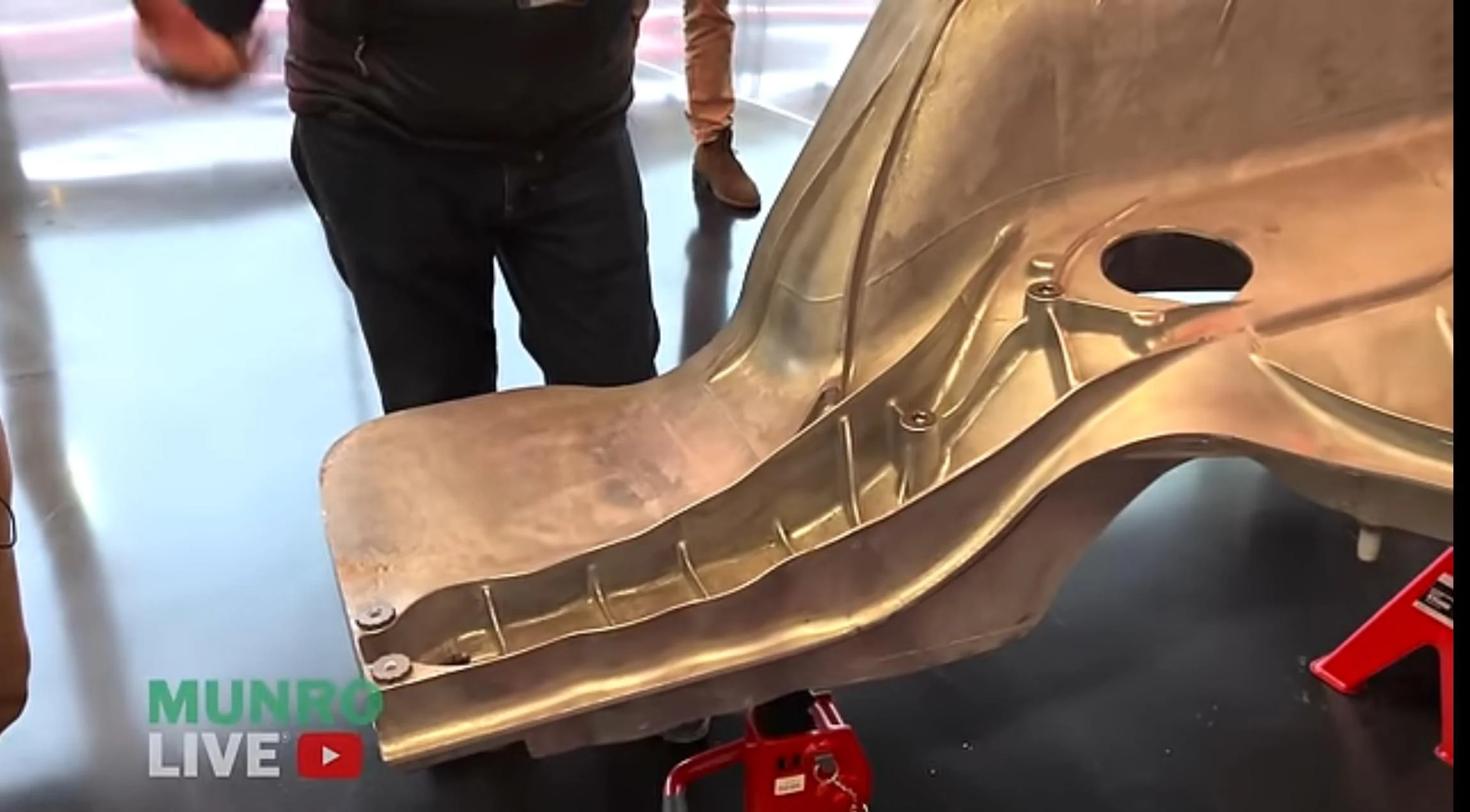

you basically just take the CT rearmost upright casting pillar, and extend it further upwards. All you have to do then is alter the mid-cab structure to not slope downward from the peak, but instead extend straight back to that upright casting pillar - by just raising the c-pillar.
Tesla Cybertruck Is a Cybervan the best EV hauling option? IMG_8175
I’d bet that’s among the reasons the CT’s rear castings are modular the way they are - you just weld on whatever piece you need to this rear upright placement platform:
