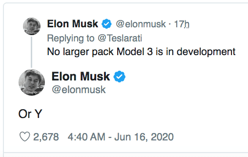

Elon tweeted that there is no 100kwh Model 3 in development as a reply to one of the articles claiming there is an incoming 100kwh Model 3.
He tweeted "No larger" - see what he did there? If they can shoehorn 100kwh into a 75kwh space then it is still "no larger". But he can't say that now since he doesn't want to Osborne his current sales. Just my personal theory.
It wouldnt be the 1st time Elon has said something is not happening but later on it does but worded differently.
IMO there is a 50/50 chance it will happen
