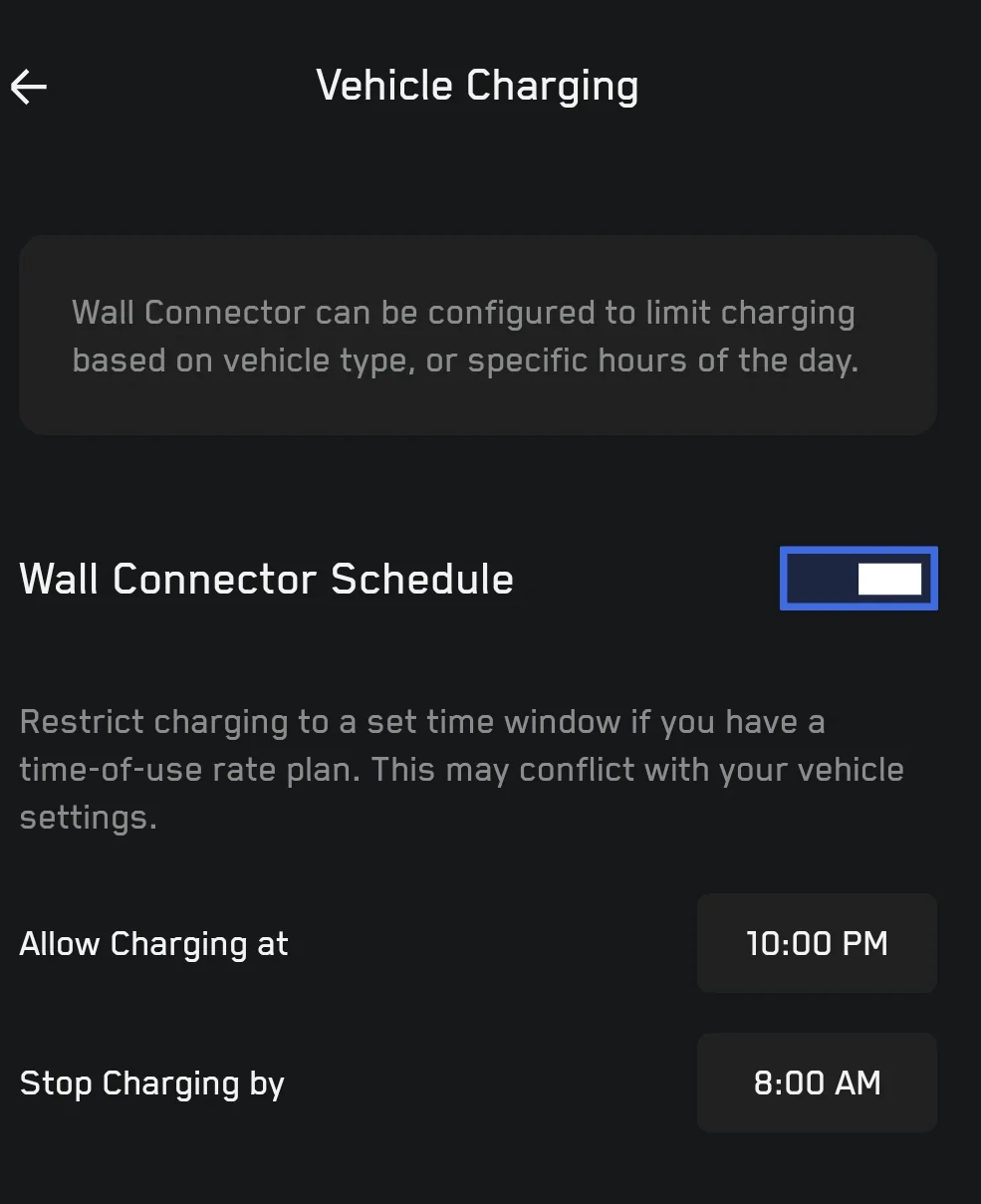

I have a separately metered electricity connection in my back garage where electricity is ½ or less the cost at the house, unless I use power during peak hours (where massive penalties apply). Is there a way to plug in CT but guarantee it doesn’t use grid power outside scheduled charging sessions? Does low power mode impact this? Seems like CT always uses wall power if plugged in regardless of charging schedule.
I was just perusing my Telsa App and came across this setting, it might be exactly what you wanted. Should work once your Powershare and UWC get installed.
House tab -> Settings -> Vehicle Charging
This looks perfect! Now to get it installed…

After a mere 1.5 year wait, i almost have my gateway and wall connector installed.
Turns out the wall connector can have its own two zone schedule and won’t output power during the one “off” time zone you get to specify. It does let you set complex schedules for keeping track of cost of charging…but the schedules only works when connected to internet, and my wall connector can’t hold on to a WiFi connection to the router 4 ft away for more than 15 minutes.
