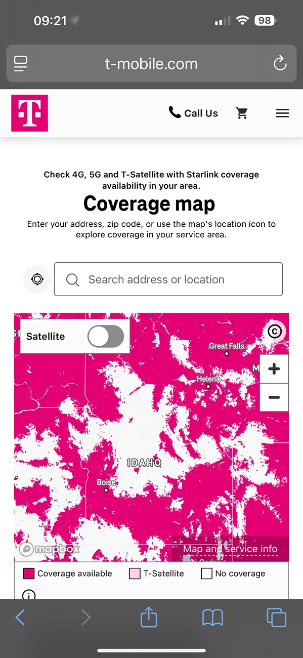

Ok then back to my original question. Why do you need Sterling for the truck? My truck connects to my home WiFi when parked. I have life time free connectivity and I can even use my phone’s hotspot.
Why do people use the Starlink for the truck?
Whitespace is the reason.
