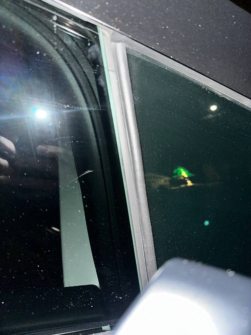

I think I narrowed down the issues and have significantly cut down on all noise..
1) put some electrical tape popped around the door catch (black loop that the door latches onto - drivers side, significant less vibration on door and mirror
2)put rubber piping between the roof and windshield (not sure this did much but it looks better)
3) put a strip of rubber seal right before the passenger side window and window seal by the quarter panel window. This is what I think fixed the wind noise on the passenger side which indicates the window seal and window don’t quite fit right, you can feel the top of the front of the window slightly pushed out when the door closes.
I’ll take some pictures but right now it’s 90% better.
Edit. See attached you can see the extra rubber seal on the glass right next to the existing seal. All it’s doing is pushing the wind around the edge of the glass and existing seal..
