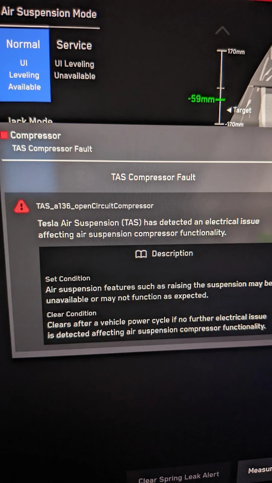

I forgot what the exact setting was (did this before my meeting) but this is the error that is provided.
I did a power cycle twice already to see if it helped.
Ah dang. Yea that looks like a more serious one.

WELP I let it sit for 2 hours while I was in a meeting, got out of the meeting and they wanted to see the truck (of course xD). They asked if I had any issues with it yet cause of the news stuff. I explain a few gripes but overall love the truck.
Get in. Truck raises perfectly, tonneau cover works perfectly, all errors are gone -_-* my lanta do I hate technology sometimes even though I'm one mega nerd.
Going to mark the lift as tentatively "self resolved" but still have them look at it at my June 5th service schedule.

As long as your truck is at the right height, you should be fine. The truck should refused to let air out of the system. Your shocks should work as normal - just without the ability to level or change heights.
If it were a pressure line issue, you might end up sinking which would negate your ability to use your full suspension travel. Then you wouldn't want to drive.
Generally, Tesla errors will say if you should pull over and stop. Otherwise you should just be wary of the lost ability.
