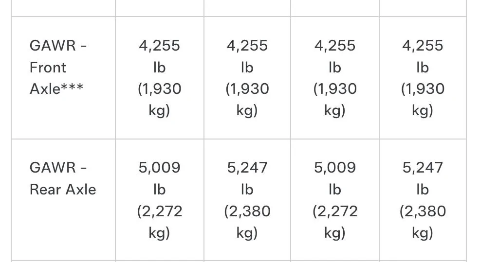

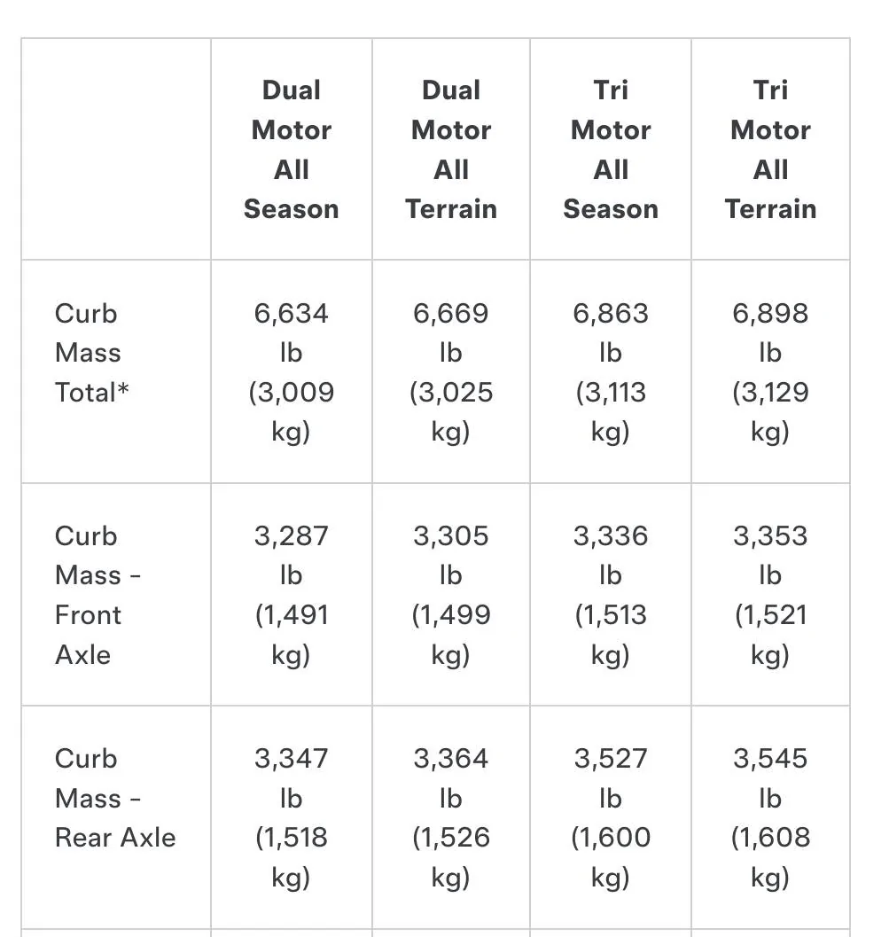

At max tongue weight with the Tesla specified 49 inch max rear axle to ball distance (basically ~8 pin to ball), it loses ~375 pounds from the front axle and puts 1,475 on the rear. Highest capacity variant is AWD with All Terrain tires and it has 1,833 pounds of rear axle capacity (GAWR-curb). So, with just the trailer, only 358 pounds of capacity remain.

It's not so much the loss on the front, it's that it shifts to the rear.
After trailer is connected, rear axle only has 358 pounds left while payload has 1400 (AWD AT)and front axle has 1325. Frunk cargo unloads the rear axle at ~10% so max frunk of 441 gives 44 unload putting axle capacity at 402 for rear and 840 front, with 959 of payload. Four 150 pounds passengers would exceed the rear axle rating.
With tri-motor remaining capacity is 181 pounds rear, 792 front, 729 payload. Rear axle would be over the limit with three 150 pounds passengers.
If one gets a range extender which will likely be in 500-700 pound range with ~80% weight bias toward the rear axle, 1,100 pound tongue is off the table without WD.
