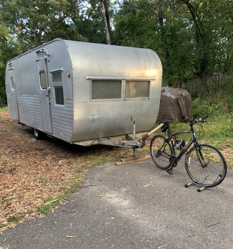

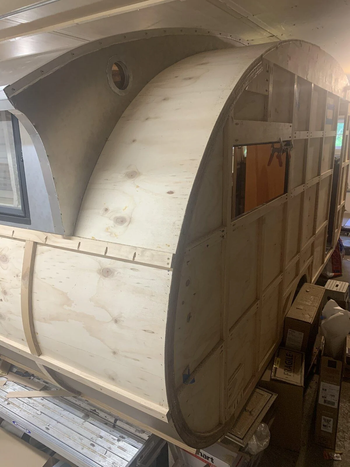

I am considering purchasing a camper trailer and wanted to ask people how they thought the Cybertruck would compare to a gas and diesel. I am getting dual motor. The added weight must help. 50% range impact?
On Towing I’m new to electric but not trailers . I build custom vintage travel trailers .
I’m Planning on towing with the tri motor (500+ mi range with no load ).
I’m anticipating 175 miles with zero range anxiety and plenty of juice left over to plug in a 30 amp trailer for a night of two . Trailer weight AND drag from wind resistance reduce range .
CT from a length width and weight standpoint, should make a good tow rig .
That said when towing with your CT , plan to stop more frequently to top off than your diesel pickup friends .

Those look nice!
What is the range with the bicycle pulling? ;)
Aero is a bigger concern at highway speeds than weight. If the trailer could be made to be the same width as the Cybertruck with appropriate tapering width, it would help keep the frontal area down (a key factor to aero). If the front is done right and then ramped down at the back, it should really help keep the drag down (another key factor to aero).
Many people think you want it pointy at the front, but the bigger pay off is making it pointy at the back. Putting the air back with the least amount of turbulence is much more important and beneficial for aero and thus range.
I really hope the Cybertruck (and other EV trucks like the Rivian & EV F-150) causes trailer manufacturers to pay more attention to aero and make new models of trailers with aerodynamics and efficiency in mind. Many of the current trailers that are not much different than dragging a ancher behind the truck.
