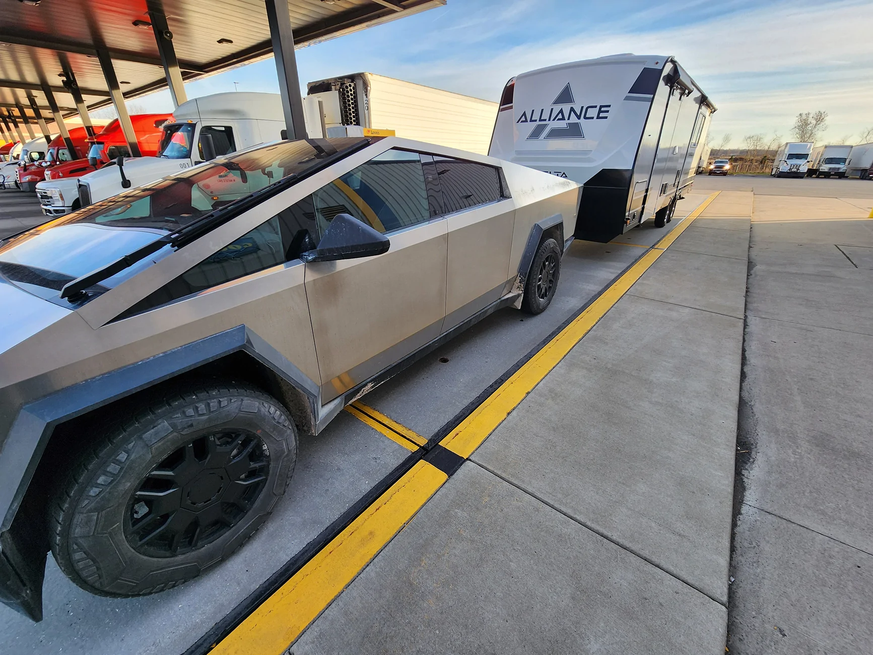

Round trip towing numbers at 40 F with 274RKW (~8200 pounds, 32ft, 11'3" tall). Sub 10 MPH wind.
1650Wh/mile on the freeway at 65-70
1080 Wh/mile on surface streets 38 MPH average
Part highway outbound:
95% used going 79 miles in 1:34
All two lane return:
62% used going 72 miles in 1:51 (110 mile range)
Slow route is faster overall when including the addional 33% top end recharge requirement
Arrival SOC started dropping at the end, went from 10 to 5 in the last 20 miles. Adjusted speed accordingly.

WOW. Thank you for the data. Towing a large box shaped TT is definitely not ideal.

Nor is towing anything smaller that is currently available...
Seriously considering a range extender so we can get around the country in reasonable time and have the Cybertruck at the destinations. Potentially with a PTO driven generator and DC fast charging.
