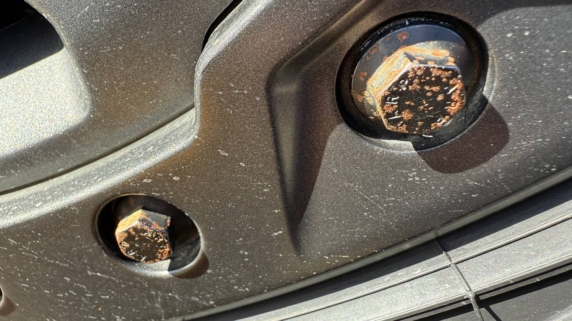

So one month after installation, I'm noticing that the bolts provided by Martian Wheels are already rusting. I have about 1000 miles on my CT since installation. We do get road salt up here in Michigan, but I've taken it through the car wash quite a bit to get the salt off. Martian Wheels told me the provided beadlock bolts are "extreme strength stainless steel with nitride coating." Is it normal for stainless steel bolts to rust like this? Also, the facility that installed my rims did not use any anti-seize compound when installing. I'm thinking I will need to replace these bolts soon before they seize up, and use some anti-seize compound while I'm at it.

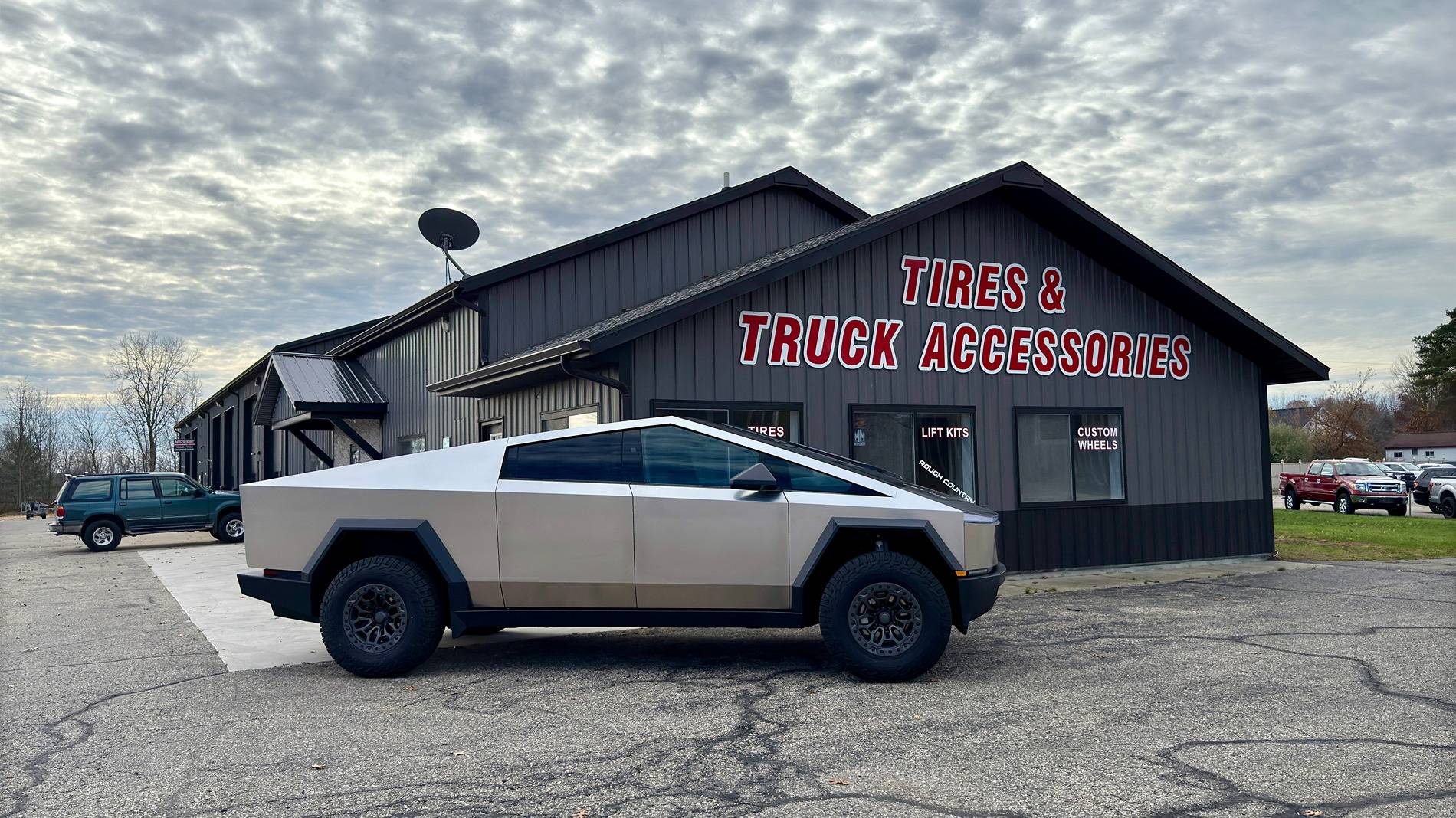

Tesla Cybertruck Martian Wheels 18" Cyber Rover beadlock wheels on Cybertruck 1733760388291-56
i havent experienced that at all, but two weeks ago i did get the wheels and tires put on. i didnt realize until they were being installed that the kit didnt come with Lug nuts. what did you use for that? i guess i assumed Martian would include matching ones. really happy with how it looks though
