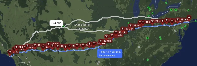

When I got my Model 3 in 2018, I ran simulations, that use real-world data, on ABRP. And, I did a trip from Maine to Denver and back. 4400 miles. Basically, what you learn is the fastest roadtrip is to drive as fast as you are comfortable with, and charge at the lowest SOCs you are comfortable with.
And for me, that was 8-10mph above the speed limit, and charge at 10-15%, typically up to ~65%. My nephew just drove from my home to Denver, 2200mi in 2 ½ days, in my 2018 Model 3.
So, I just punched in a Manhattan to Manhattan Beach trip, and the maxim still holds for Cybertrucks as it does for the Model 3, drive as fast as you are comfortable with. The speed more than makes up for the additional charging.
Tesla Cybertruck Maximum speed driving cross country 1758415858700-80
Tesla Cybertruck Maximum speed driving cross country 1758415429636-70
If you do a little math, you'll see that the average driving speed is 86mph, and average legs are 97miles, and average charging stops are 19 ½ mins.
Edit: yes, I added 2 mins to each stop for "overhead". ABRP allows you to add that extra time to and from the charger. Typically you choose ones with easy-off, easy-on.

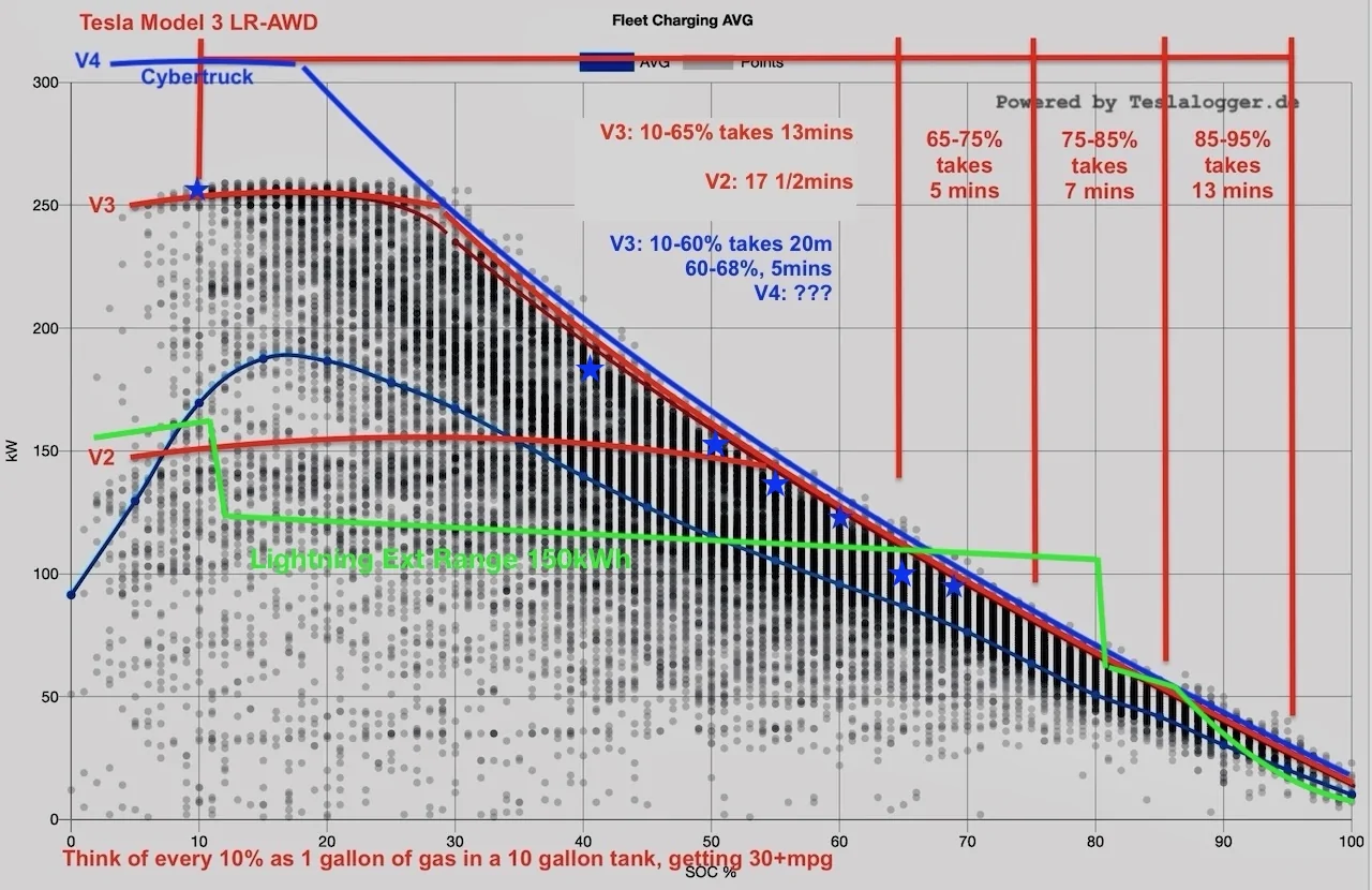

Here's a chart I made for my passengers to help them understand the charge taper. For me, the CT taper matches my 2018 Model 3, when they reach about 30%. I typically feel like going when I get to the 65-70% range, as that's where it crosses below 100kW. Starts to feel slow. I mean, I've typically added 50-60%, plenty for me to go 150+mi before my next bathroom stop.
Very cool chart! Questions: what is the lower blue line,, is there a Cybertruck V3 line?
