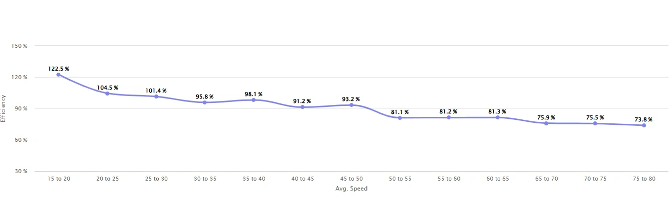

Are the percentages percent of rated range? (clicked wrong post sorry, question is for @Darmie)
