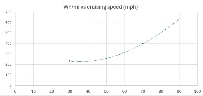

It's not though (at least with Cybertruck), at the higher speeds your additional energy usage takes longer to recharge than the time you save.
If these charts are correct, then, yes....there comes a speed at which going faster will take longer to go somewhere....same thing happens in my airplane. Sometimes I slow down to extend range to avoid a fuel stop (which takes a hour).

the 800 Wh/mi figure came from searches on the net and this forum...but, would love to tweak in the model with good data! Lemme re-run using your figure of 535 wh/mi at 82.5 mph....
I get 800 towing a 23 foot travel trailer going 65. Going 85 with just the truck I get high 400s, maybe low 500s

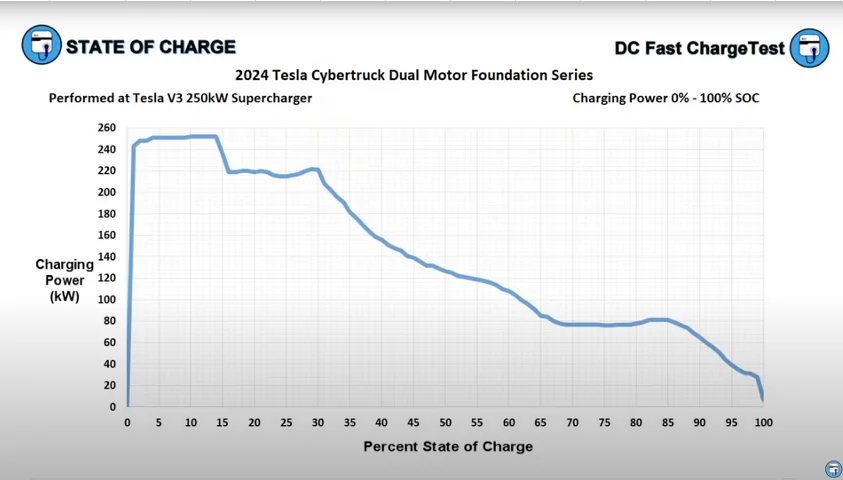

Sure, if you limit yourself to AWD speeds and legs that you can reach without exceeding 60%, you'll be in the part of the charge curve where speed doesn't matter.
If you extend the range to 130, the story changes. 110 is around the tipping point depending on the assumed coefficients.
55% SOC is 67kWh
Wh/mile vs range
400 (65ish) 167
700 (90ish) 96
1000 (112ish) 67
1250 (130ish) 54
112 vs 130
54 mile leg
29 minutes at 112, 25 minutes at 130, 4 minutes drive savings
54kWh at 112, 67.5 kWh at 130, 13.5 kWh difference
Charge rate needed 13.5kWh in 4 minutes = 202.5 kW. And you need that from 49% (5% buffer plus 54/123) to 60%. My last charge session on a 325kW unit dropped below 200kW at 40%.
