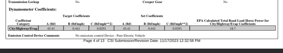

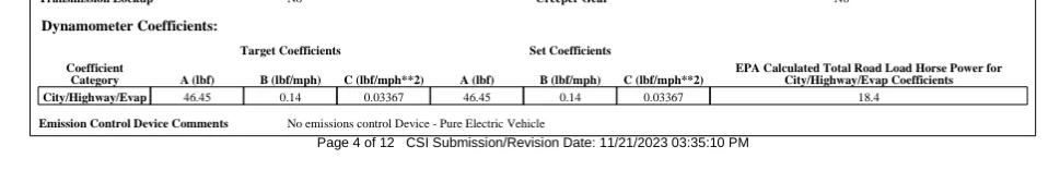

Nice! You can also find the dyno calibrations for constant, linear, and quadratic loading on the EPA filings.
AWD
Tesla Cybertruck Maximum speed driving cross country AISelect_20250922_130657_Firefox
Beast
Tesla Cybertruck Maximum speed driving cross country AISelect_20250922_130825_Firefox
400W for vehicle load may be optimistic, 200 pounds total payload definitely is if I'm driving 🤣
