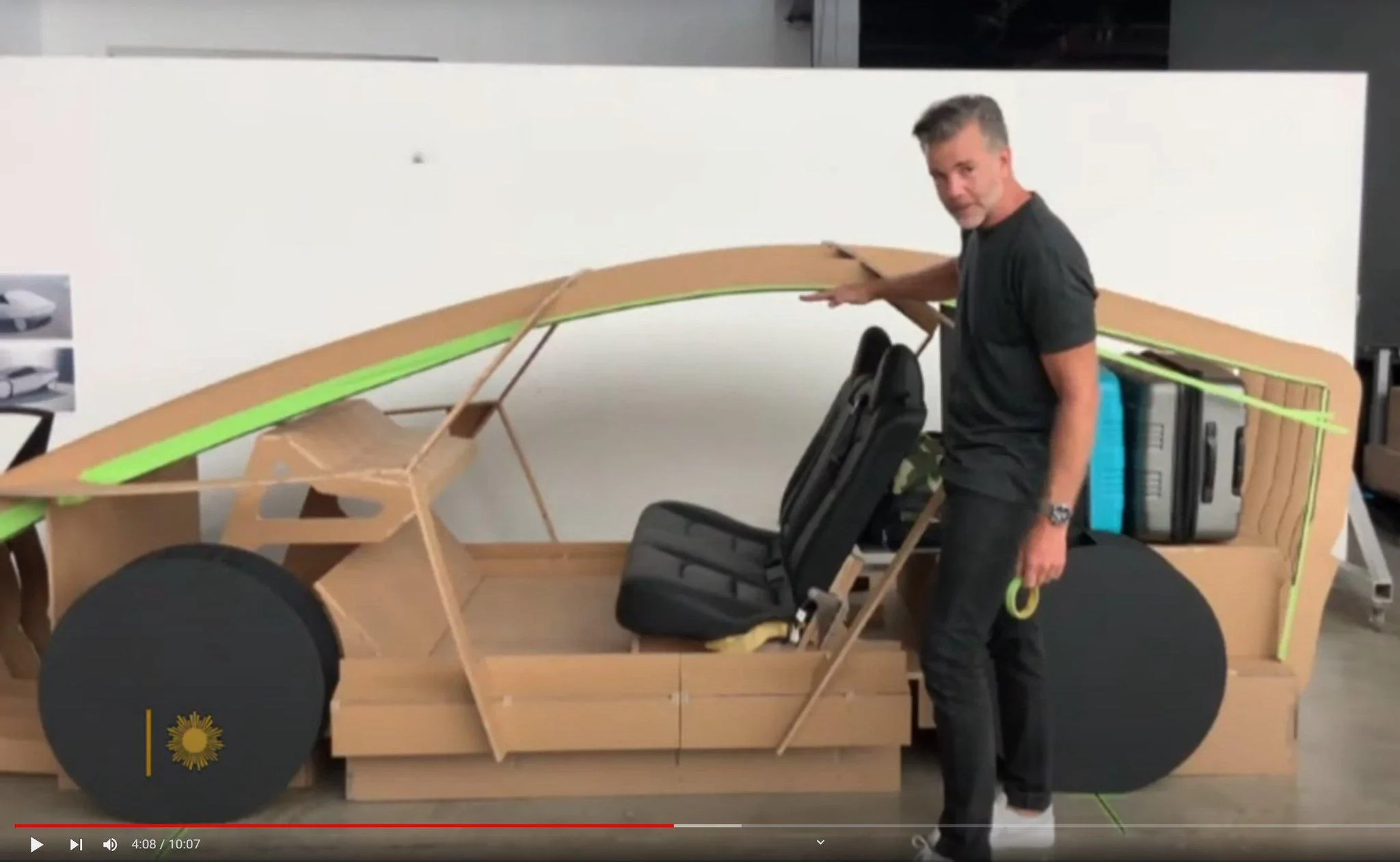

I would be so chuffed it they had a three wheeler! ?
But if they do, I don't get the side by side seating. Tandem seating would get you twice the range on a tadpole trike. If it's a tadpole trike, it really needs to be a tandem setup. Front surface area could be less than a quarter of a M3 and the shape could be half the drag Cd. That's an eighth of the total aero drag created, and nearly a quarter of the amount of batteries required to move two people. Not to mention the positives of having the center of mass positioned properly for stability etc. One rear drive motor is also a good way to cut costs, and a single piece cast BIW, with PET shell would make these things just pump out.
I've always said there only needs to be two road vehicle types, van and trike. We'll see I suppose.
